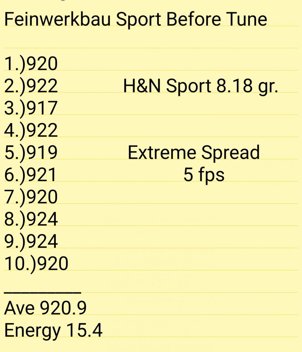

Here's the "before" numbers. I'll be sure to post the "after" numbers in my upcoming video.

Damn good numbers before the tune, dont expect much improvement as that is about as good as it gets!!
Oh, I know. Can't expect better than a 5 fps spread. Hopefully this doesn't change after the tune. I'll find out tomorrow when I run a chrono string.
