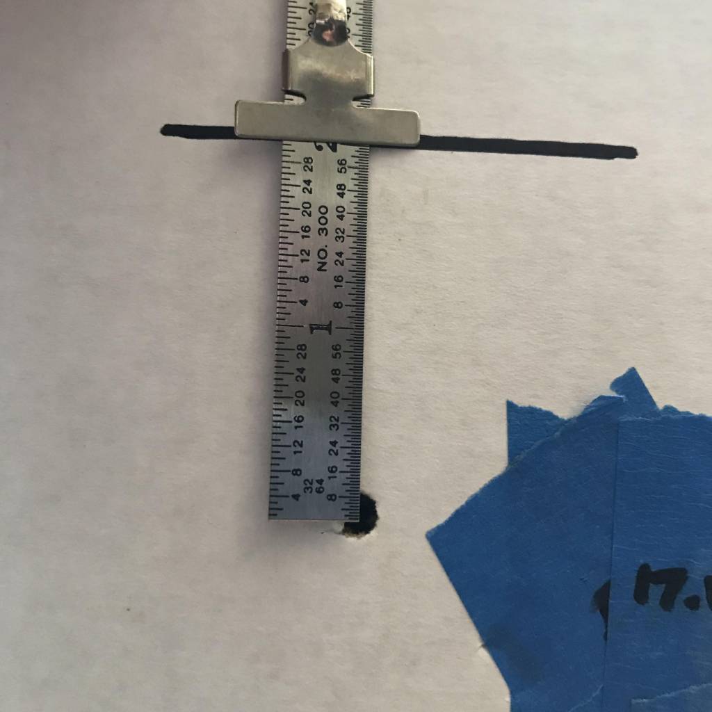

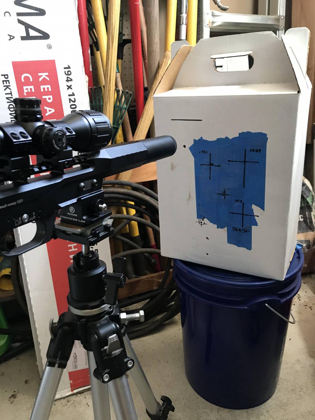

Trying to set up a ballistic calculator here.
For what it's worth, I tried the "ChariGun" method as outlined in the above link and essentially got the same results as measuring center of bore to center of scope. If there's a difference, it's in the thousandths and CG only measures to the hundredths.
The CG method might make sense if you have a gun where it's difficult to determine where center of bore is.
On Edguns, center of bore is easy to measure on R5, R5M, Lelya, and Leshiy..just remove the moderator and there's the barrel..or in the case of the Leshiy, just break it open. Save a pellet and air..LOL
