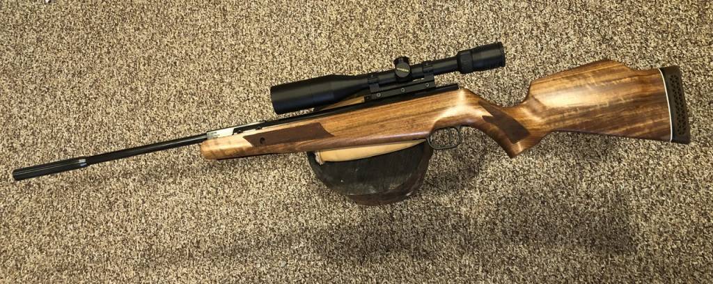

that’s a twenty Theoben below

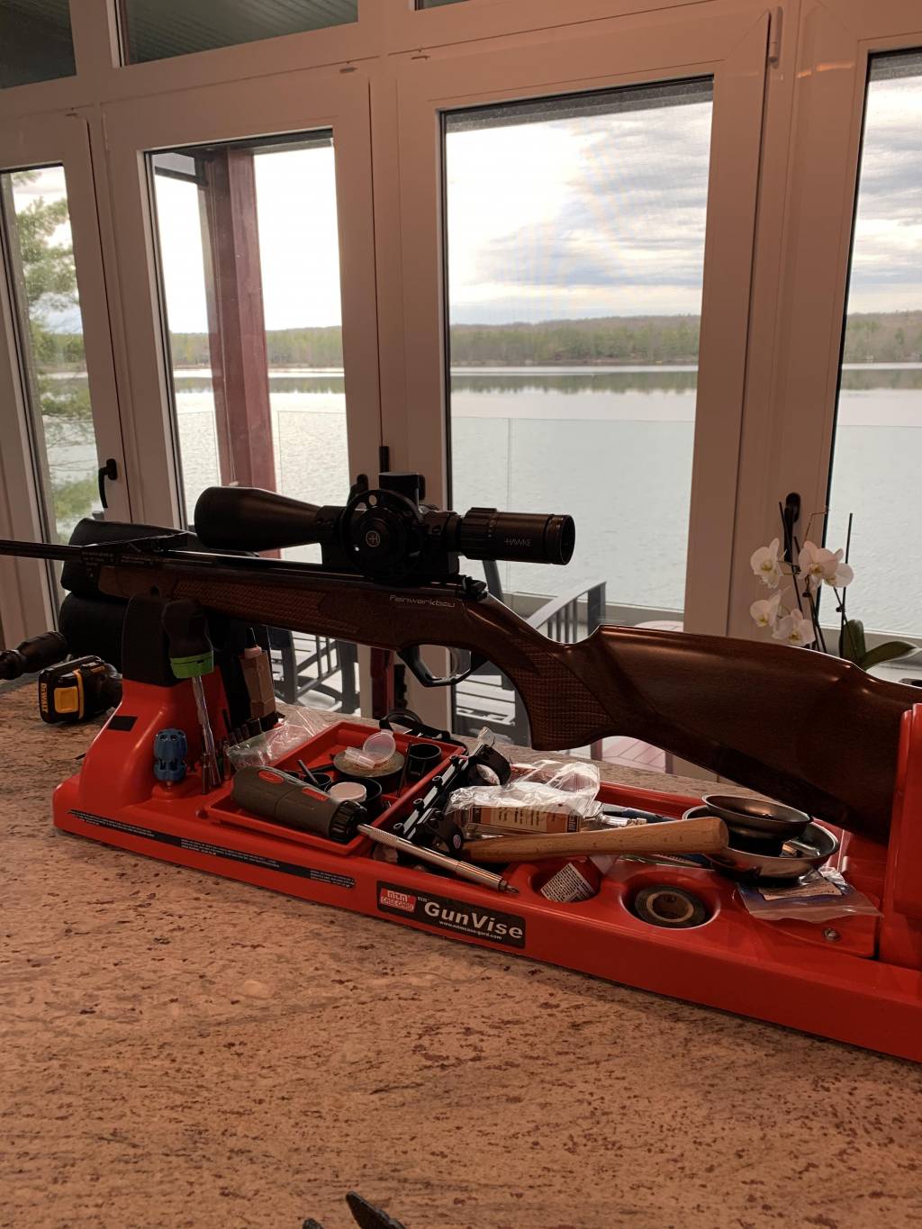

Just came in from shooting the 124, nice gun. Found breaking the barrel sometimes a dog fight. Feeling it now. Got it just the 124 before Christmas and didn’t put more than 50 rounds through it. I’m going to fit this one in my shooting a little more often. Flintsack thanks for wake up.
I’m already thinking what to get next in .177, —-easy HW98 .177. Crow
Hold the rifle firmly right in front of the trigger guard, prop the butt against your leg right up by your hip bone, look down and see the top of your barrel, holding it firmly against your hip with your left hand, smack the top of the barrel with your right hand open palm. You’ll figure out how hard to hit it in time. That breaks it loose, in one motion just continue down holding the end of the barrel and caulk it.
It makes a big difference.
glad you are enjoying it, it is one of the finest spring piston air guns ever made. They were too expensive to market. The quality of the materials especially the barrel, they could not produce them at a profit.
