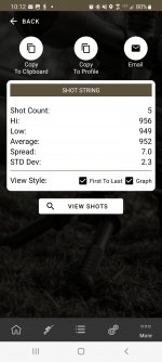

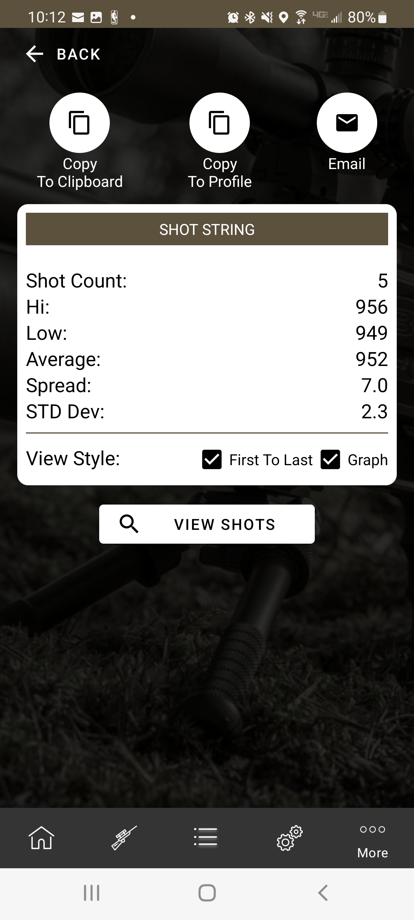

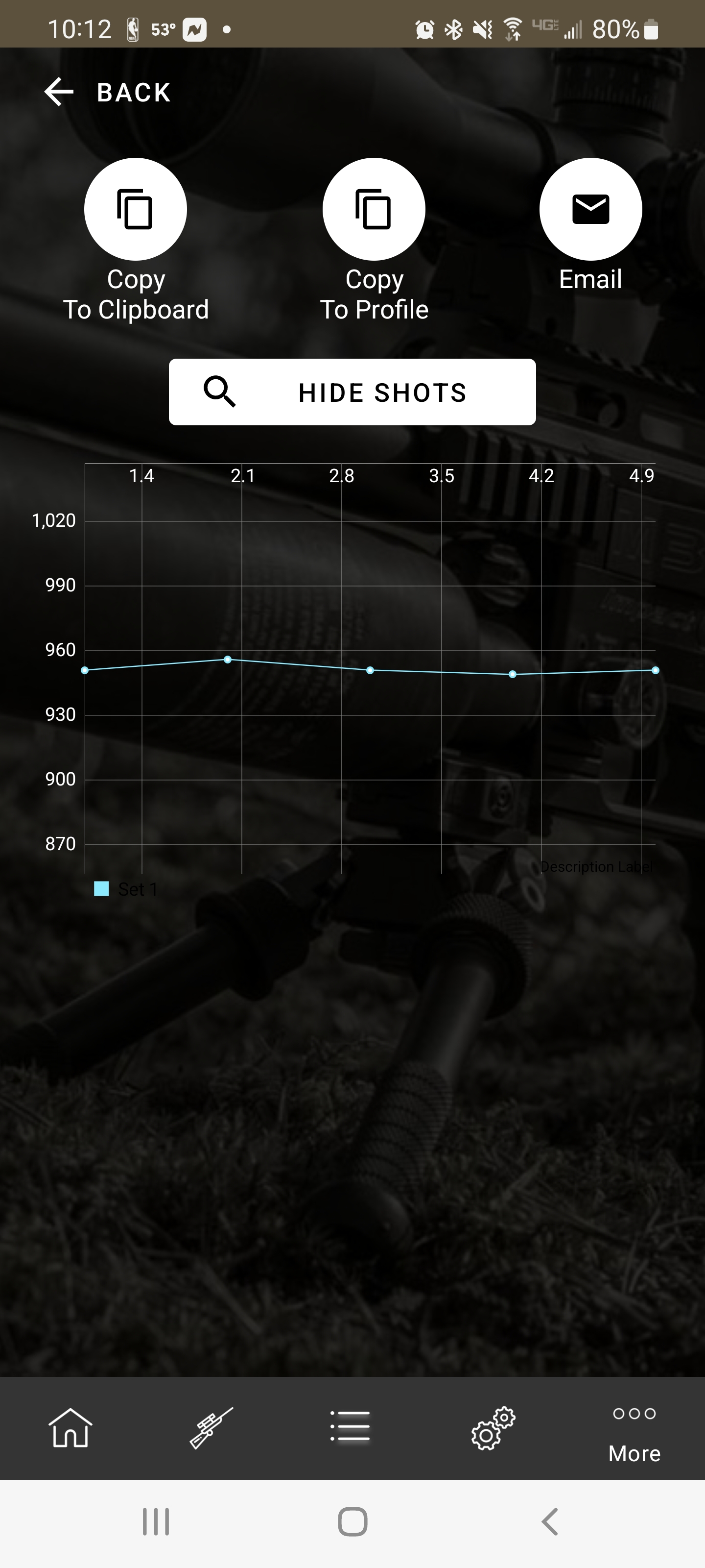

Hey Guys,
Been playing with tuning my Crown mk2. .25 600mm barrel to shoot Neilson 26.8/ .249 HS-HP-DB slugs.
I'm finding a slightly crooked shot plot.
Any ideas on how to flatten it out?
Reg 144 , power wheel 19 , tfp H
I also found with the same reg pressure pw 16 tfp H I got the same results.
I'm puzzled, could this have to do with dwell or harmonics?
Your thoughts? Screenshot_20220630-221227_FX Radar.jpgScreenshot_20220630-221250_FX Radar.jpg

So ideally, if I back out the internal pre-load slightly then I would have more usable adjustments using the power wheel?
I adjusted the internal pre- load to neutral cam at 23, then raised the reg pressure with the preferred projectile till it maxed out , flatten, then velocity started dropping. I backed off the reg till the velocity increased back to max, then backed off reg pressure just a tad.
Would it had been better to once the velocity maxed, to adjust the pre- load internal adjustment to decrease the pre-load slightly?
