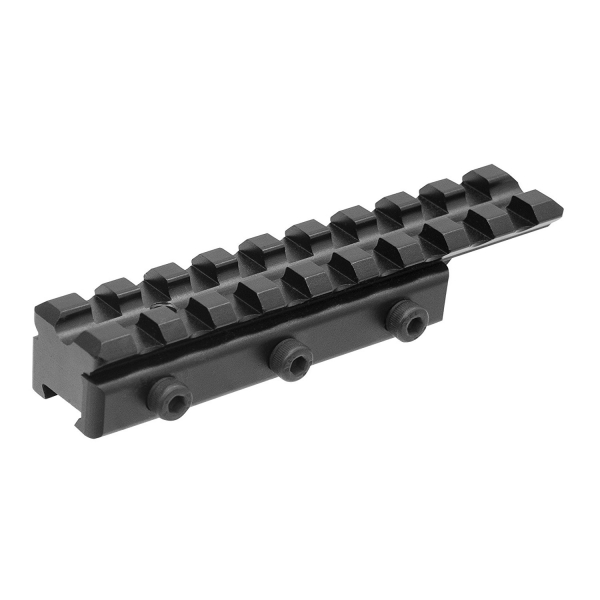

I think the mounts on that rifle are very similar to the FWB 601 SSP rifle. On mine, I used a dovetail to Pic rail adaptor, like this one:
http://a.co/9rs1D29

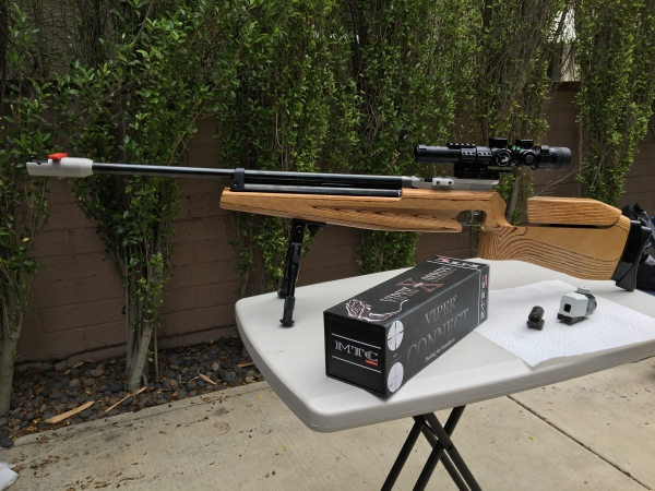

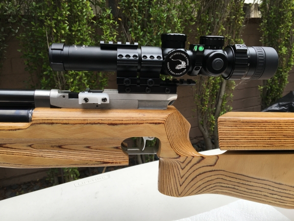

with the overhang facing rearwards, and used an MTC Viper Connect 3-12x24 zero eye relief scope and slim low height rings. I also needed to install a shortened gate that is sold on eBay, not sure about that with the 800.
My previous post with photos:
https://www.airgunnation.com/topic/mtc-viper-connect-on-fwb-601-ssp/
I initially used two rings together, but found single strap rings that fit aft of turret so I could use two spaced out rings and get the scope a little further forward. One ring where the bubble level is and one ring forward of the turrets.
