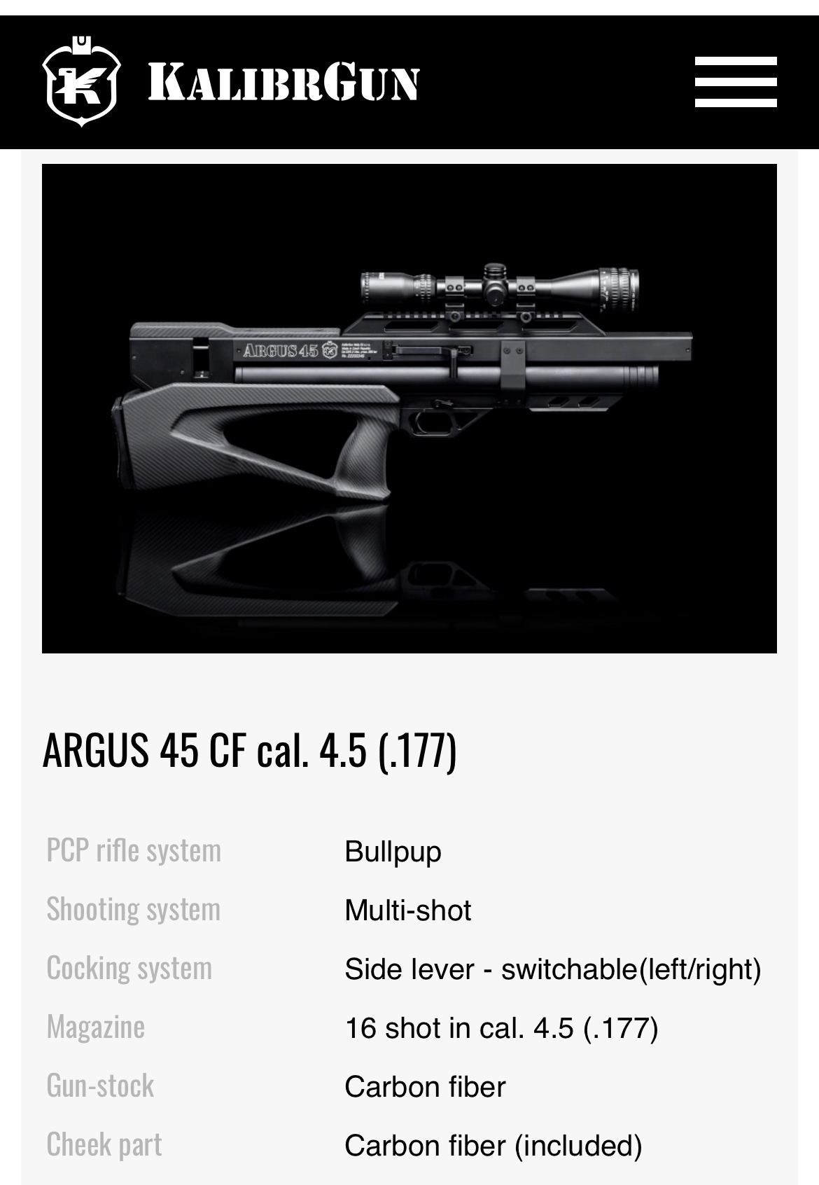

I'm done cocking by your ear. I had crickets for years and they are wonderful accurate pcp's. I shot a veteran and the trigger is amazing but I just don't want the rear cocking anymore. I did look at the new Kalibrguns but the only one I would like is the Argus and it doesn't come in .177. The mini would be cool too but it doesn't come in .177
