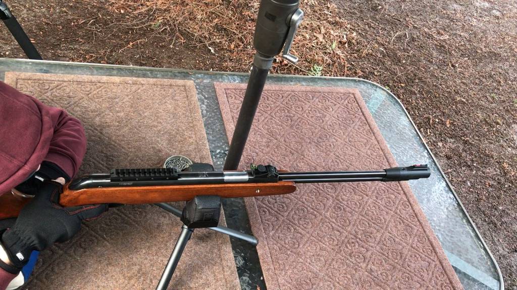

Hi Frank, I have one in 22 cal. Under the Brand name Browning. Called "The Browning Leverage". It's a Shanghai China rifle. Like the Tech Force air rifles,same cock and lock mechanism and trigger but the quality is improved. I sent mine to Mike Mellick of "Flying Dragon Air rifles" for a tune. Not much can be done with theses rifles such as the single stage trigger but mine did come back working alot smoother than before and it shoots great. Rick Eutsler of "Honest Airgun Reviews" did a review of this rifle as well as Giles of "The AirgunGearShow". Both were positive reviews. The breach on mine was very snug so I used some crocus cloth and got it to feed a pellet a little easier. It,s favorite pellet so far is the JSB 15.89gr Diabolo Exact Jumbo. To keep the scope from turning and creeping in the rings I went with BKL Double Strap Rings. So far so good. Good luck hope you enjoy your rifle.
