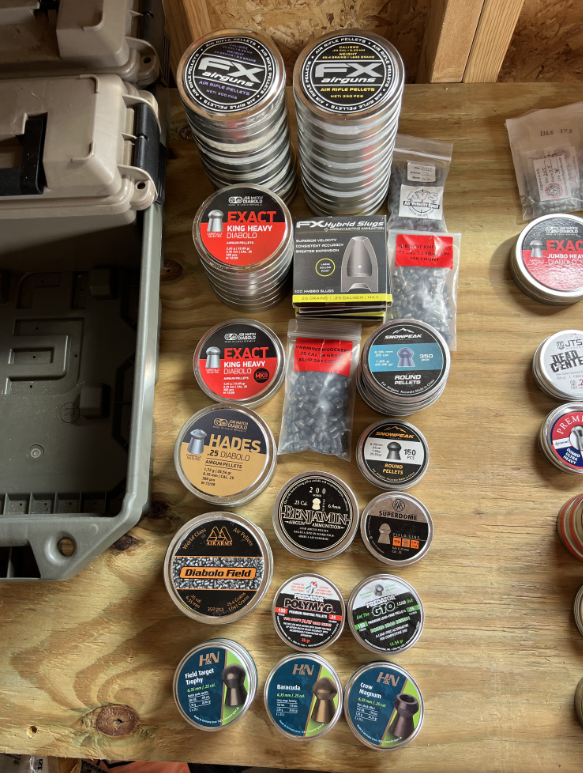

As a beginner I was wondering how Macavity decided that the JSB Match Diabolo Exact was the recommended pellet. Is it based on a product design spec such as the magazine shape and size? Or just a generalization of a previously highly recommended pellet? I am just curious as to whether I just trust them or actually start trying other brands, types and weights. I have had decent groupings at various distances with the JSBs. But I really hate to end up with a bunch of partially used tins that do not perform the same.
How do the more experienced Airgunners on the group go about deciding which one to use as I could see just buying and trying getting very tiresome and expensive.
Found this pic in another thread and it is exactly what I would like to avoid.
