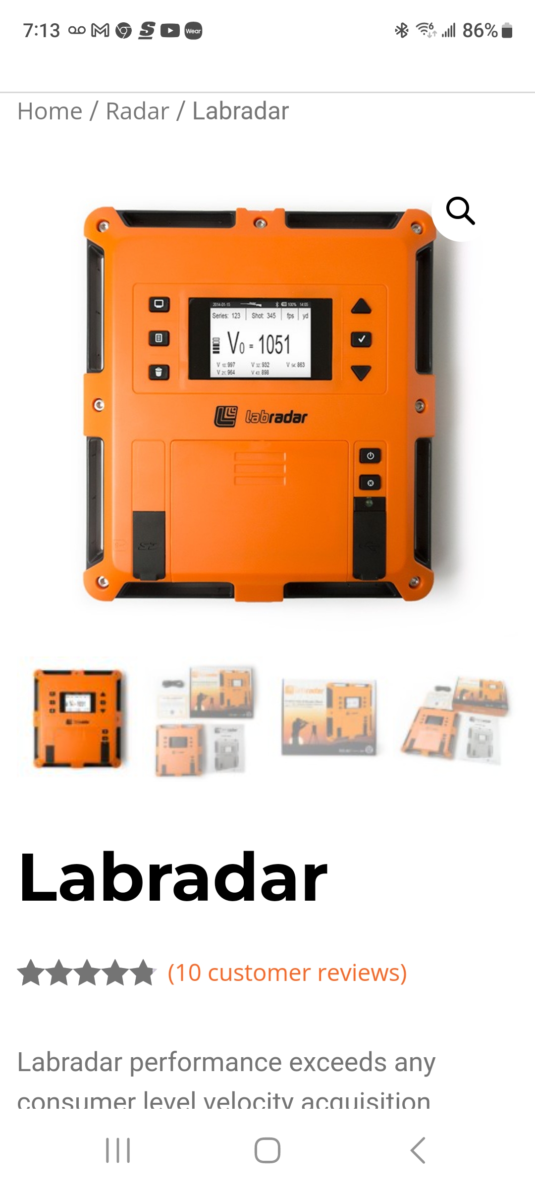

Google labradar and have fun.
Though you were asking what chrony gave reading @ multiple distances. My bad.
No worries bud. I’ve seen the labradar miss readings at certain distances so I’m pretty sure that one works. I’m questioning how the true ballistic chrony is picking up velocity passed a solid backstop target and claiming to be a tracking device.
