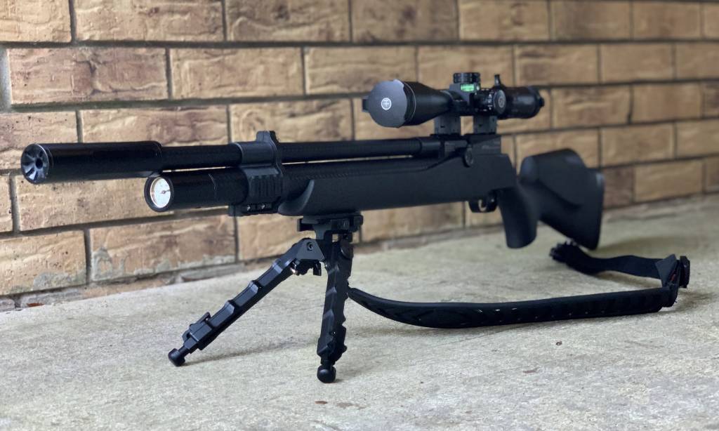

Trouble sighting in my FX Dreamline Classic
I have a FX Dreamline Classic in 30 cal.with a BSA down range 6X24X 50 scope on it. It is dead on at 30 yards 5 shot in a 1" dead center. When I try to sight it in for 50 yards it is all over the place from 6 " high/low to way left and right. I am shooting JSB match EXACT 44.75 grain pellets. and using a lead sled for a rest. I have made sure that the gun is fully charged. Any one have any ideas why it is doing this

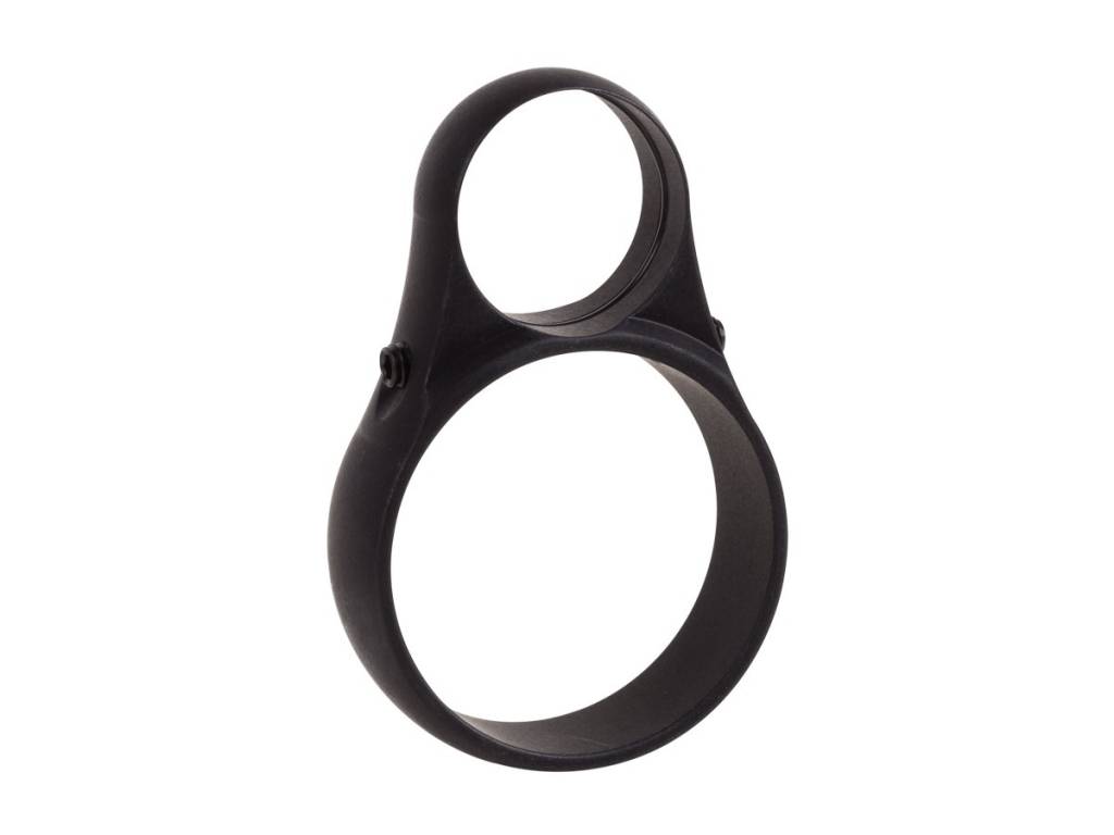

Barrel band??
https://www.pyramydair.com/s/a/FX_Dreamline_Barrel_Band/9462
My .177 DL Classic is a laser gun... Barrel banded.
