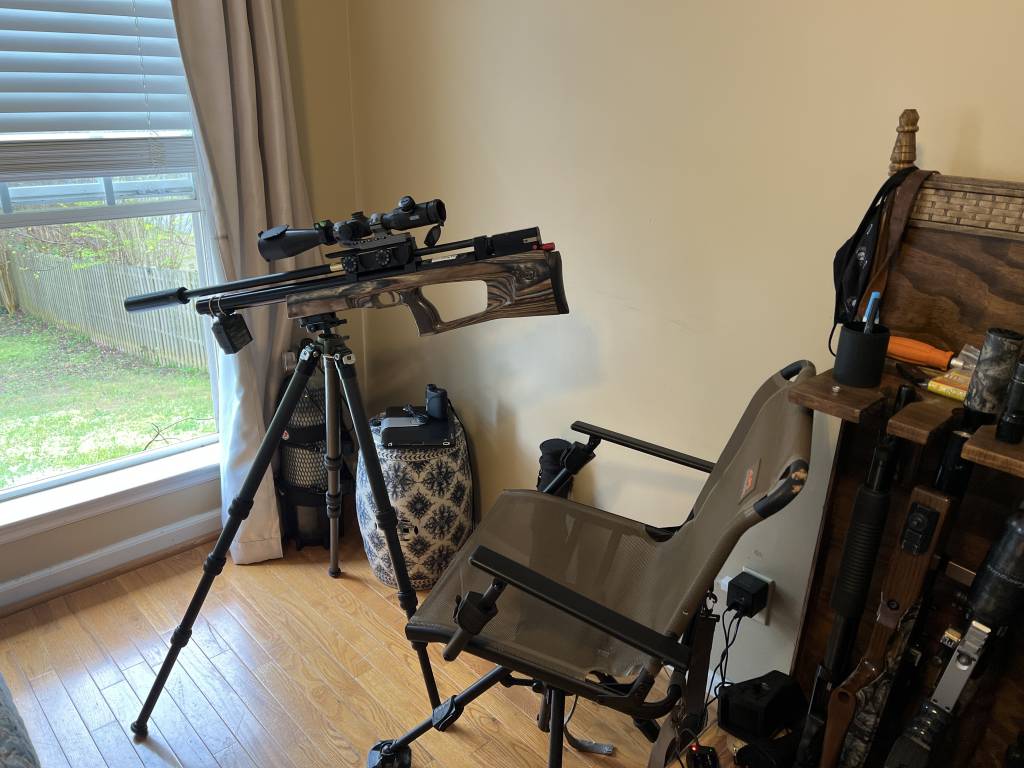

Photography was my hobby for over 4 decades, I still have four full size heavy duty tripods and maybe 5-6 smaller somewhere down in the basement lockers. I even use smaller tripods to hold the gun for disassembly.
This is my current setup for shooting my Leshiy2 from a bench, removed the second and third sections and got more room to fill the legs with #9 leadshots.
Also made several different scenarios for sitting on a bench top or around a terrain
