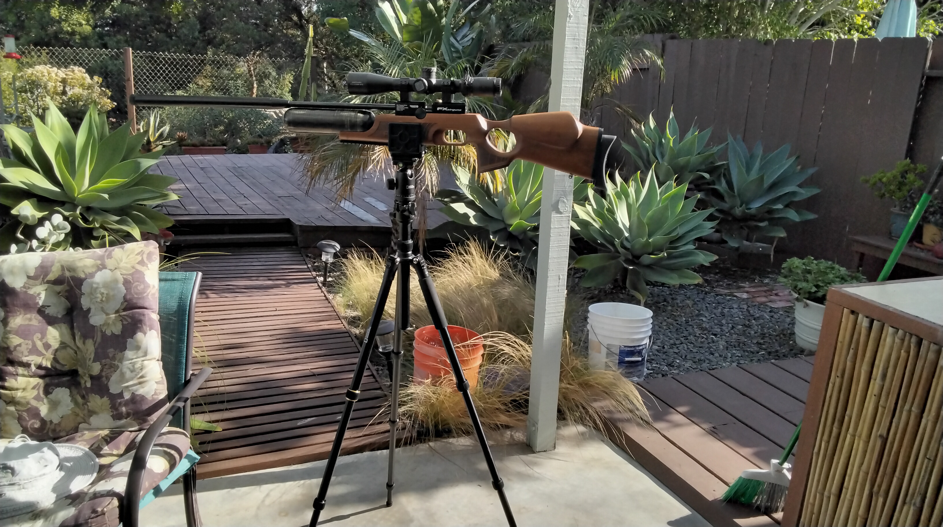

@JungleShooter Not sure what you're looking for, but I've been using this Innorel ball head for a couple of years now.
It holds my rifles just fine. You can see where I switched to this bullhead in post #15 of the thread linked below at the end of this post.
With my Innorel tripod, I've found that there is a little play in the adjustable center column. The higher you extend it, the more play you can feel. I've never tipped this tripod over. See link below. I also purchased a heavier and taller tripod (to emanate the center column) for a little more money. I use both. Innorel and Articise ballheads and tripods look identical to me in build.

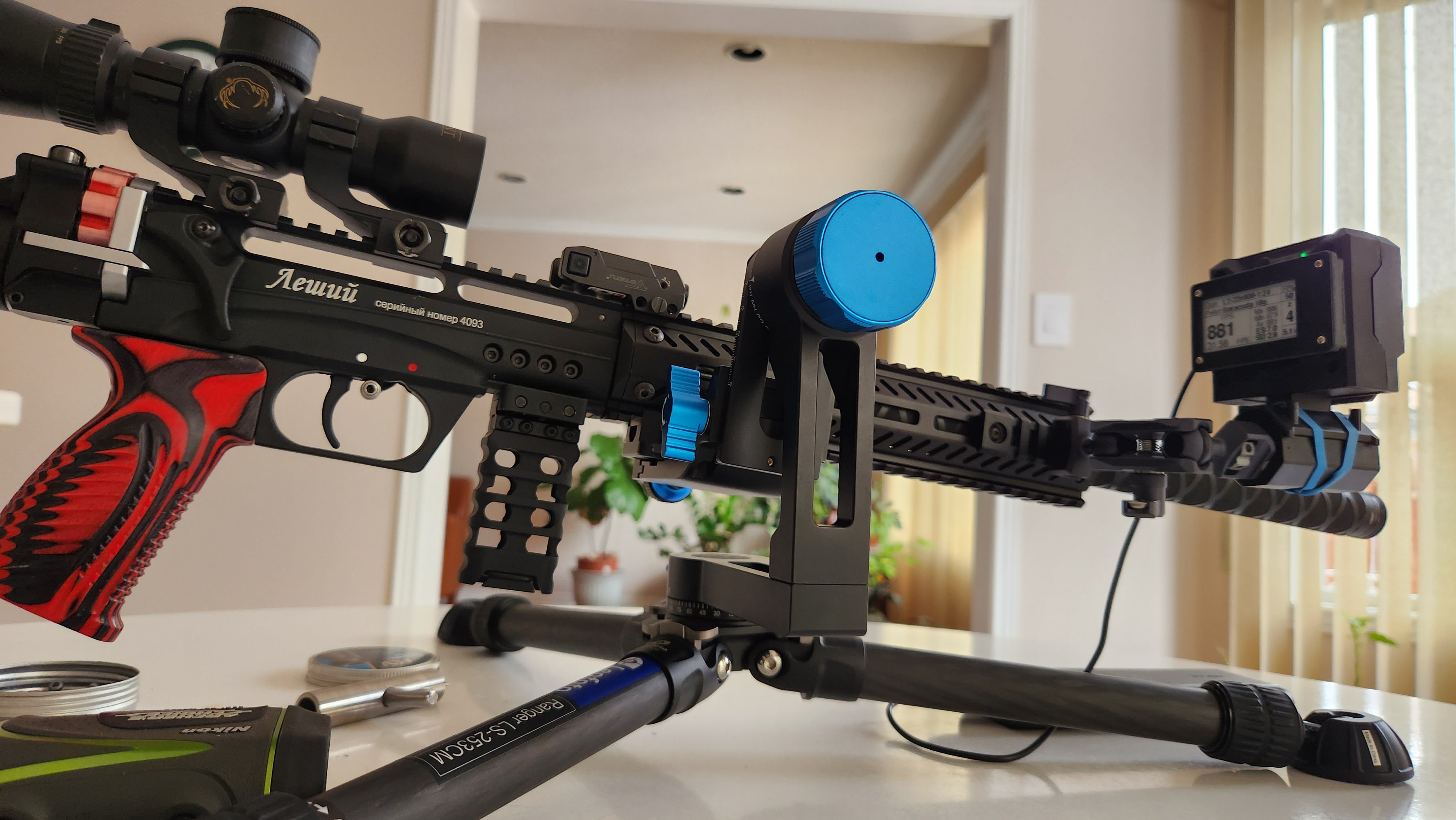

Much more comfortable to work with gimbals or tilting heads.

➠ Atilla present the two-way tilt heads as an alternative. They just go up and down, and rotate around the axis, but won't tilt the gun left or right.
So, WHY do not more shooters talk about this type of head, and buy this head?
Please, help me understand. What are the drawback of the two-way tilt head over the ballhead? Just that it is not in fashion?
Also, how is a "gimbal head" different than a "two-way tilt head"?

Really no need to overthink the gimbal/tilt head. Yes there are people here @ AGN using these but maybe busy with families over the Holiday season, they my chime in wait couple days.
I am shooting my L2 of a tripod (with gimbal) for target up to 70 meters, and the tilt head I use on my one-piece rest I built for 100-200 BR for my Impact.

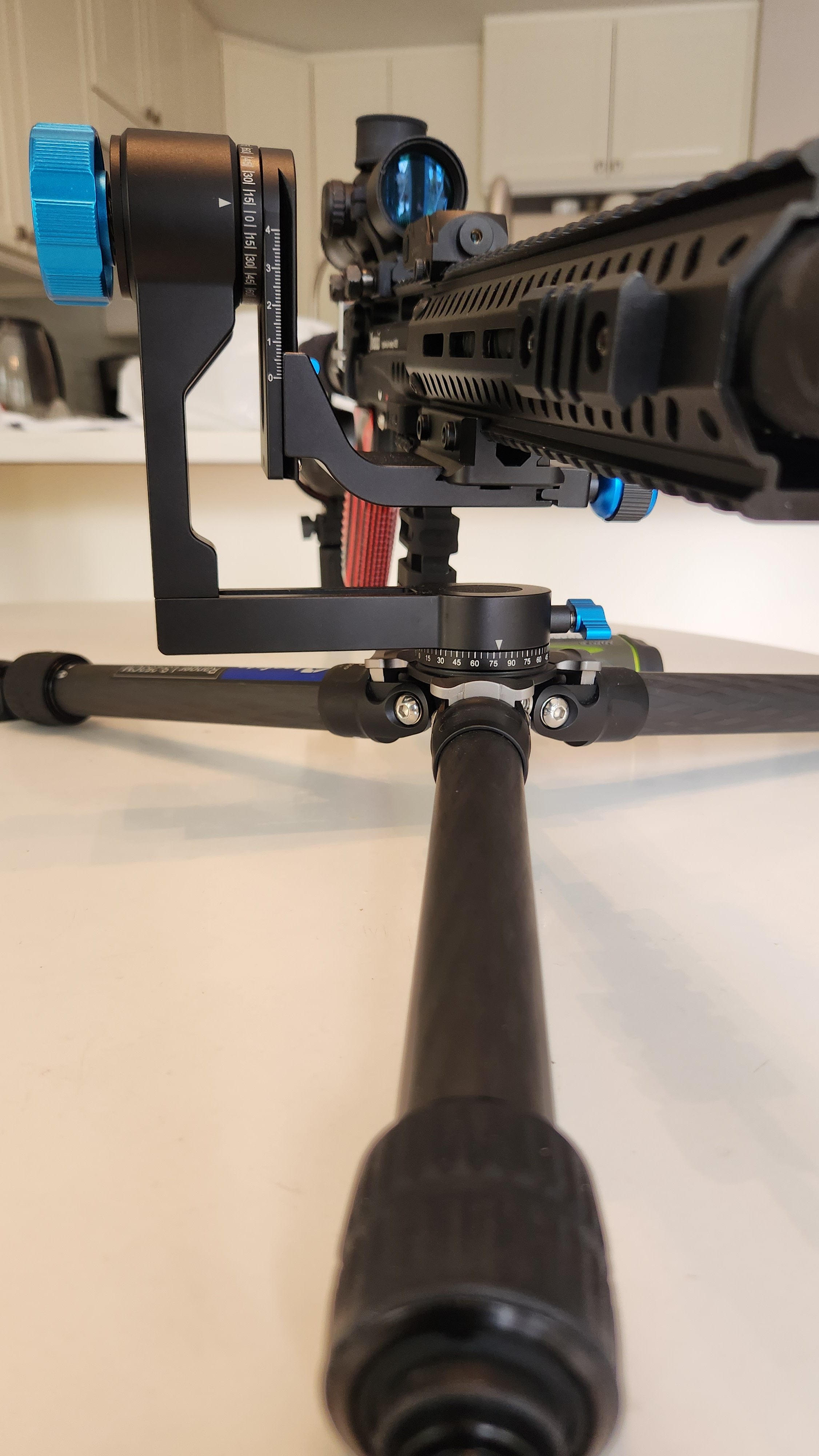

@JungleShooter I think it would be helpful to know details about your shooting environment. Will you be seated behind you tripod shooting from an area with a level surface/ bench on level ground (like how some dairies have concrete floors)? Will you be moving around the pesting area(s) to uneven ground (dirt, grass, etc) that you are unfamiliar with?
IMO it boils down to what type of shooting you are doing and where. If you are shooting multiple shots from a fixed location and don't mind extra weight and setup time you can't beat a good gimbal or pan tilt head combined with a leveling base. Cheap gimbals have poor bearings that don't hold level when panning large angles, but can perfectly balance your gun. Moderately priced pan tilt heads don't have that problem but don't perfectly balance your gun.
Ball heads are lighter and faster to setup don't require a leveling base for easy use, but the gun CG is above the pivot and the gun wants to fall over. Your lucky if gun is balanced in one position. Every time you change your aim you have to check the level!
