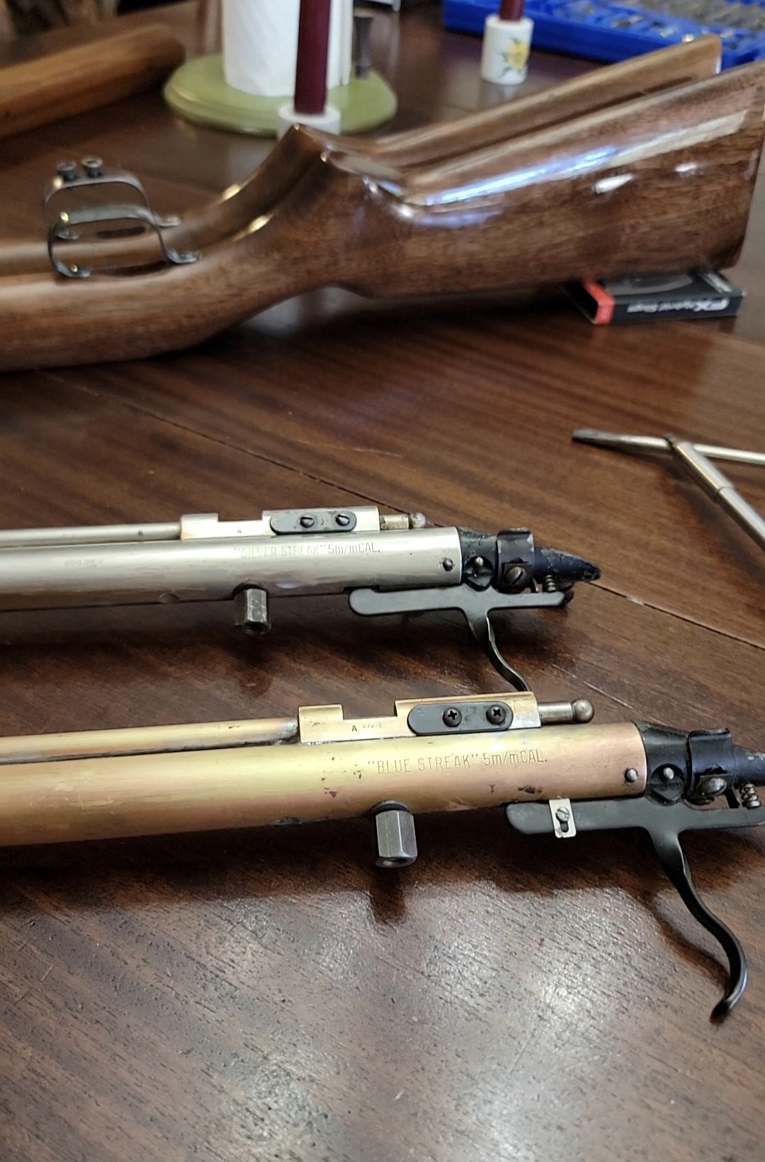

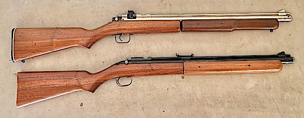

Having recently rekindled my half-century love affair with Sheridan pump-rifles by horse-trading for a 70s vintage Blue Streak and a much more recent vintage Sheridan/Benjamin C9A series Silver Streak, thought I'd not only spread a little more Sheridan love (despite there being ample 'round these parts lately), but a related trigger modification that is equally applicable to many guns. Although both Streaks are in excellent condition, the SS wasn't building pressure. Thankfully a buddy reseals Sheridan pumpers, and the SS returned home yesterday, healthy.

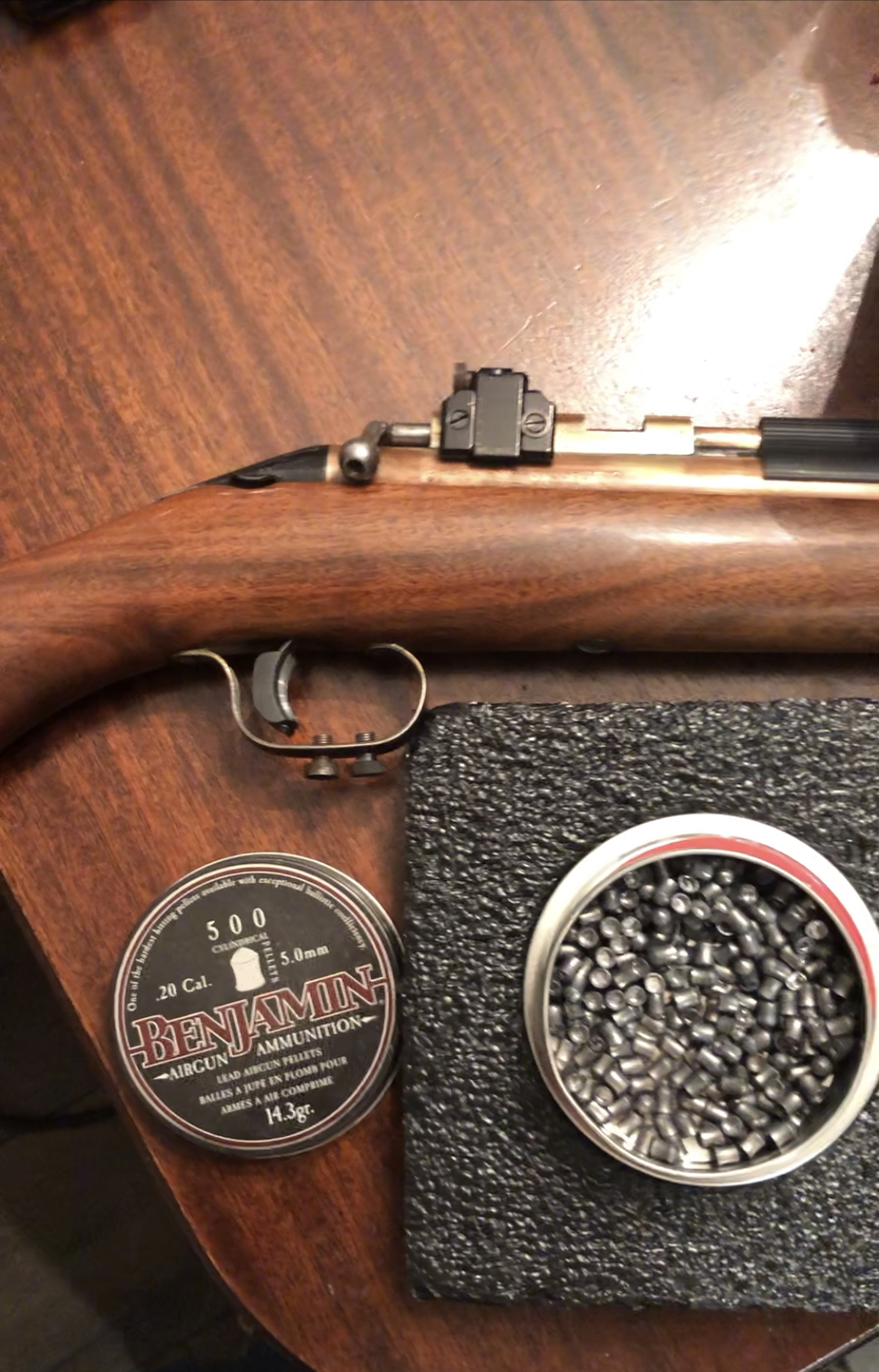

The C9A apparently being the last Silver Streak to be walnut stocked and equipped with steel triggers and trigger-guards, it is the last Sheridan/Benjamin that interests me. Come Crosman, they were economized with "walnut-stained hardwood" stocks, and plastic trigger blocks.

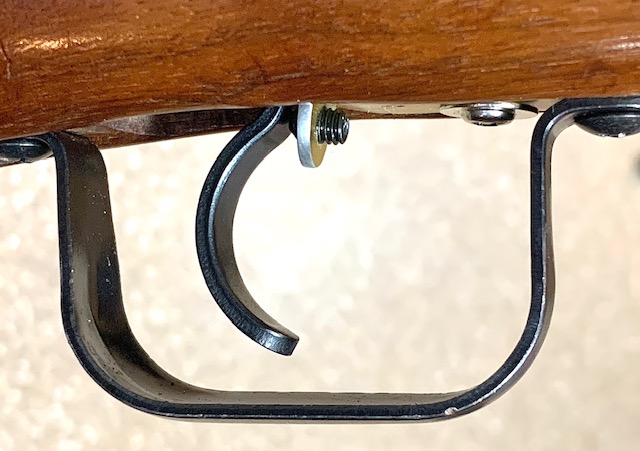

Installing a much lighter trigger spring couldn't have been easier. Dealing with the trigger-creep, not so easy. But also not exactly rocket science; especially given I've applied this modification, or variations of it, to several simple triggers to totally transform them. This photo should be pretty self explanatory-
But if not... The #8-32 allen-head sear-adjusting screw SIMPLY adjusts to limit how far the trigger returns forward during cocking, thereby how much the sear engages with the hammer/striker. The screw threads through a small piece of angle-aluminum stock cut to fit into the trigger-guard inletting in the stock, under the trigger-guard itself. With a bit of moly-lube on the sear-engagement surfaces, the trigger now breaks crisply and creep-free at 24 ounces.
