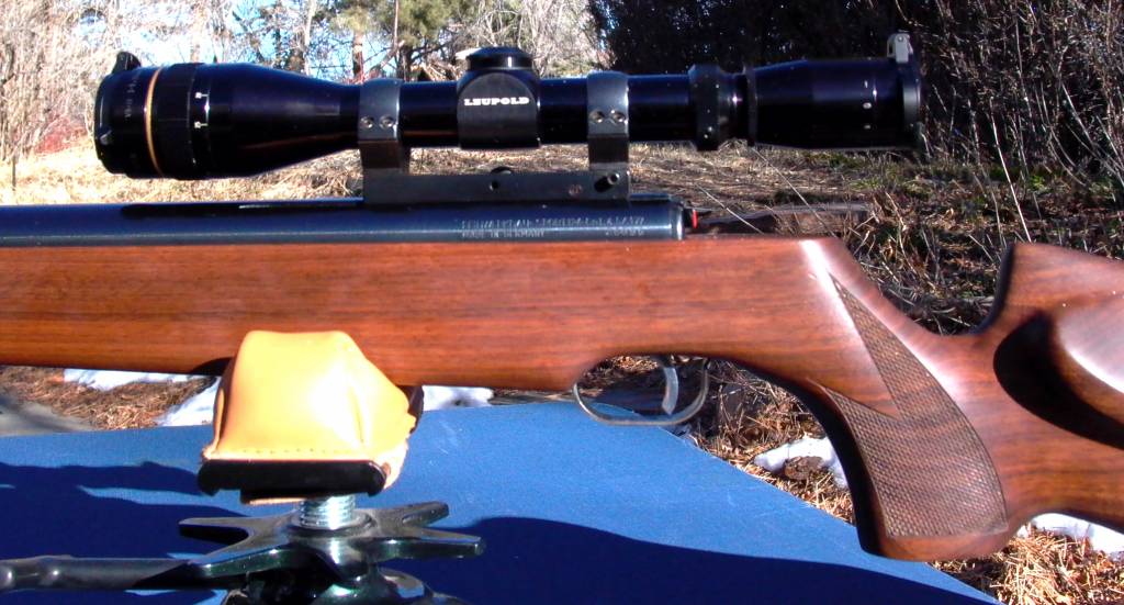

Here's a picture of one of my FWB 124's in a JM tyrolean stock that Paul Watts converted to .22 cal. It has an EAW scope mount:

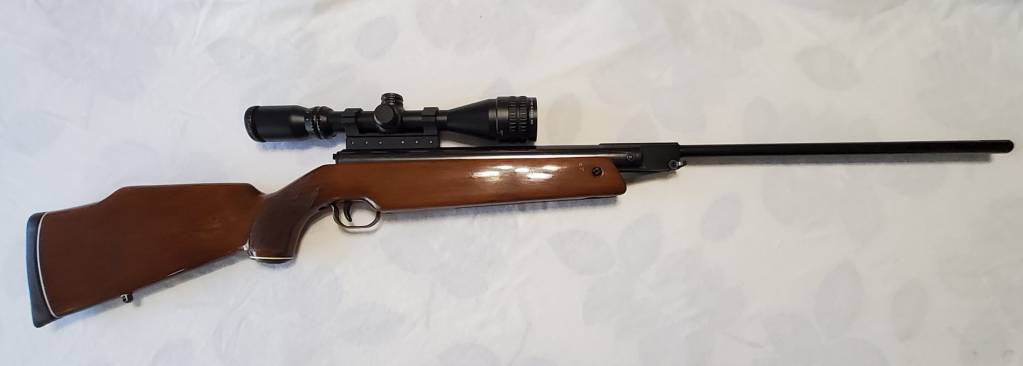

Do you have model numbers for the Sportsmatch or whatever you are using on your 124 ? Problem is I need droop compensation. Nice rifle ! Mine isn't a safe quuen but still nice. Early San Rafael Jnc probably made in late 1978. Shoots very smooth and power is good. Did some tests with weighed JSB 7.33 gr. pellets. Pellets weighted at 7.3 gr went 854 fps. Pellets weighed at 7.5 gr 848 fps. For a 43 year old rifle it's sweet.

Do you have model numbers for the Sportsmatch or whatever you are using on your 124 ? Problem is I need droop compensation. Nice rifle ! Mine isn't a safe quuen but still nice. Early San Rafael Jnc probably made in late 1978. Shoots very smooth and power is good. Did some tests with weighed JSB 7.33 gr. Pellets weighted at 7.3 gr 854 fps. Pellets weighed at 7.5 gr 848 fps. For a 43 year old rifle it's sweet.
The gun shown has an EAW scope mount. That’s what I’m using on that FWB 124. Contact EAW and expect to pay $350-$450 for the mount. Sportsmatch mounts made specifically for the FWB rifles work well. Their one piece 1” mounts are part number HOP23C and their 2 piece 1” mounts are part number TO3C. Once upon a time you could buy direct from Sportsmatch so I suggest you start by contacting them since the link I provided to these rings on the PA site appear to be out of stock. I’d still call PA and AOA. Here’s a link to Sportsmatch:
