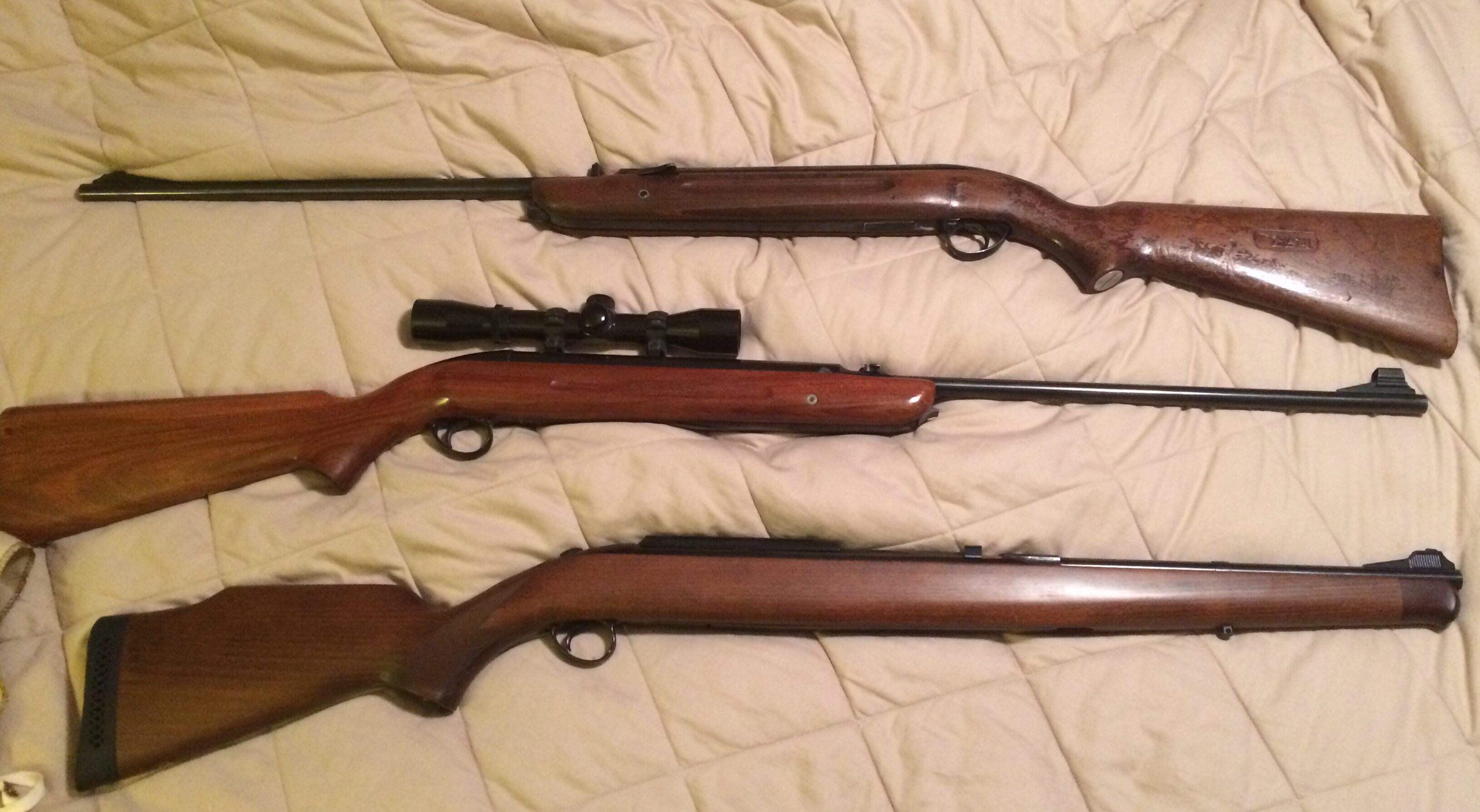

Treating Rusty Gun
Never even heard of an "1800 series". They're normally designated by "Mark" 1 thru 8. Or "S", or "Stutzen", or "Centenary", or "RB2" etc.
What's an 1800 series?
You can rub all day with oil and fine steel wool. The blue won't come off.
If somebody took blue off with oil and steel wool PROVE IT.

Not sure. Seller said it's 1800 series. This is my first BSA gun.
It shot but not really well.
Anyway I will try to rub with oil first.

Common problem with most Airsporters is the buffer washer swells up and gets tight in the cylinder. Same for Mercurys. Probably time for a new O ring and buffer washer. Airsporters and Mercurys are real fun to work on.
When you're finished rubbing with oil without any result get the steel wool out. Good luck with it
Thanks for your advice. Appreciate so much.
I never had experience with this gun.
You'll have experience when you get the back block off and back on. The buffer washer usually turns to stiff, waxy bubble gum.
