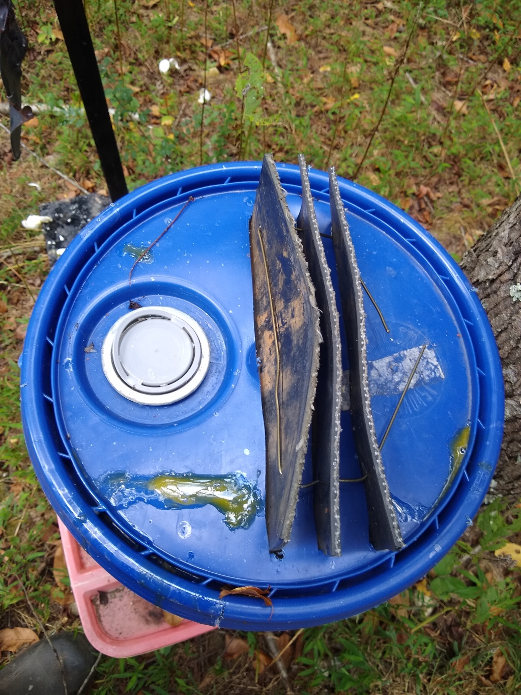

trash to pellet trap!

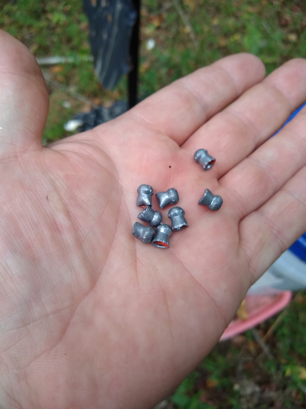

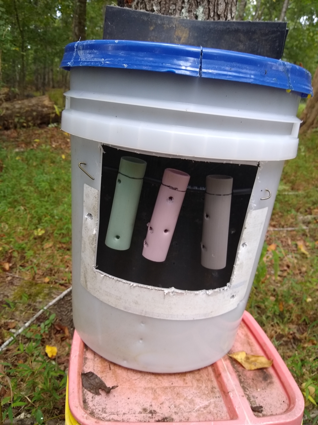

upcycled some trash into a pellet trap for my stock haatsan bullboss .25. 5 gal bucket, 3 flaps old conveyer belt, 3- 1in plastic tubes and a wire coat hanger. At 50 yards 2 flaps stop the pellets with little damage to the pellets. easy to collect and melt down into new pellets. Sorry not pretty! its a prototype fine tuning on next one
