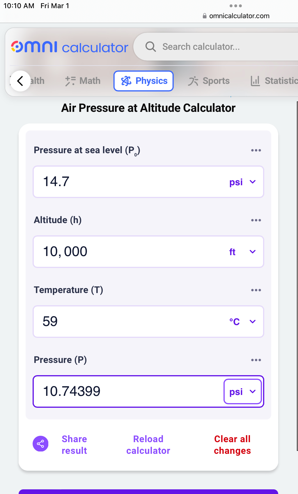

I’m trying hard to stay panicked, but somebody enlighten me, what is so terribly dangerous about flying with an air tank? If I understand correctly the concern is that air pressures decrease at altitude and thus may overstress the tank because of greater pressure differential.
However at sea level the air pressure is around 14.7 pounds and at 10,000 ft that only reduces to around 10.7 pounds. Aircraft will keep the cabin pressure to around 8 to 9 thousand feet. Not that drastic a difference. I don’t know if the baggage compartment is pressurized but its a private plane just bring it with you in the cabin.
I can see where it would be unwise to have a tank at max pressure but with a reduced pressure, say 3000 pounds in a 45000 pound tank is there any real ACTUAL FACTUAL reason to believe that would be unsafe???🤷‍♂️
