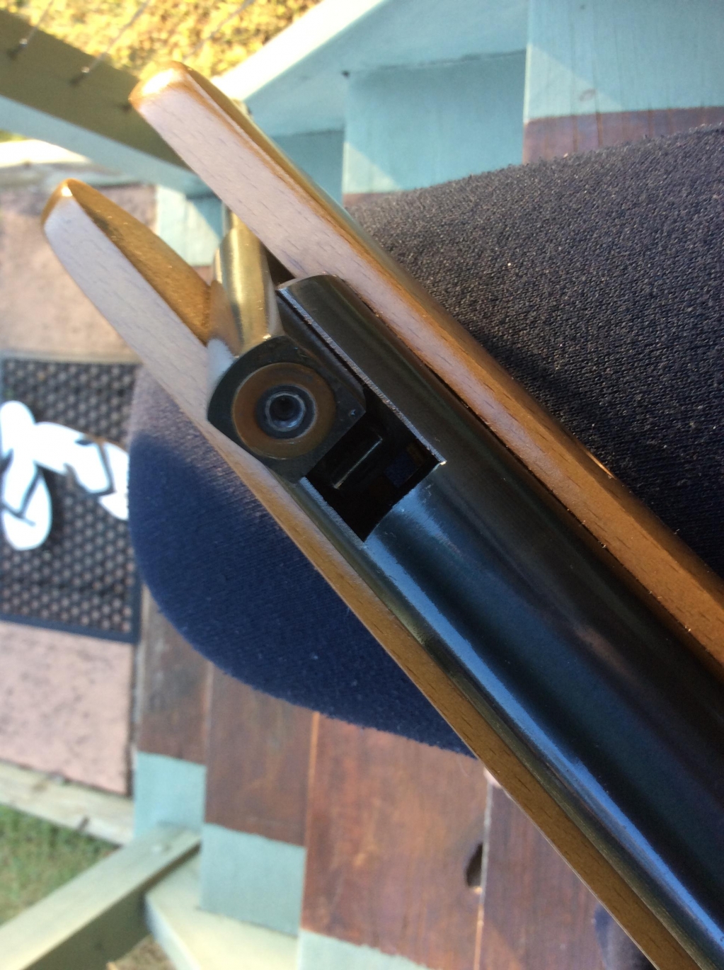

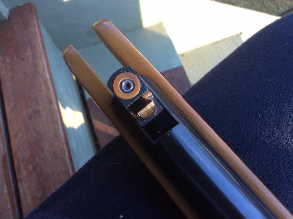

I don't think it is the spring on the lug. The lug itself is worn to a sharp edge on the top. The relief that the lug over centered past the bar and then locked into is gone. The top is flat, and the edge is sharp enough to cut you. I did mention that this particular rifle has been used a lot. Seal shows a little bias towards the bottom and is maybe borderline blown straight down. I am assuming the same amount of wear on the pin, so minimum the locking pin needs to be inspected well.

Does it look like this. The detent on my Trails were like this from new this particular rifle has many thousands of pellets through it. If it is does the detent make contact with the detent pin when closing the barrel.
Gary

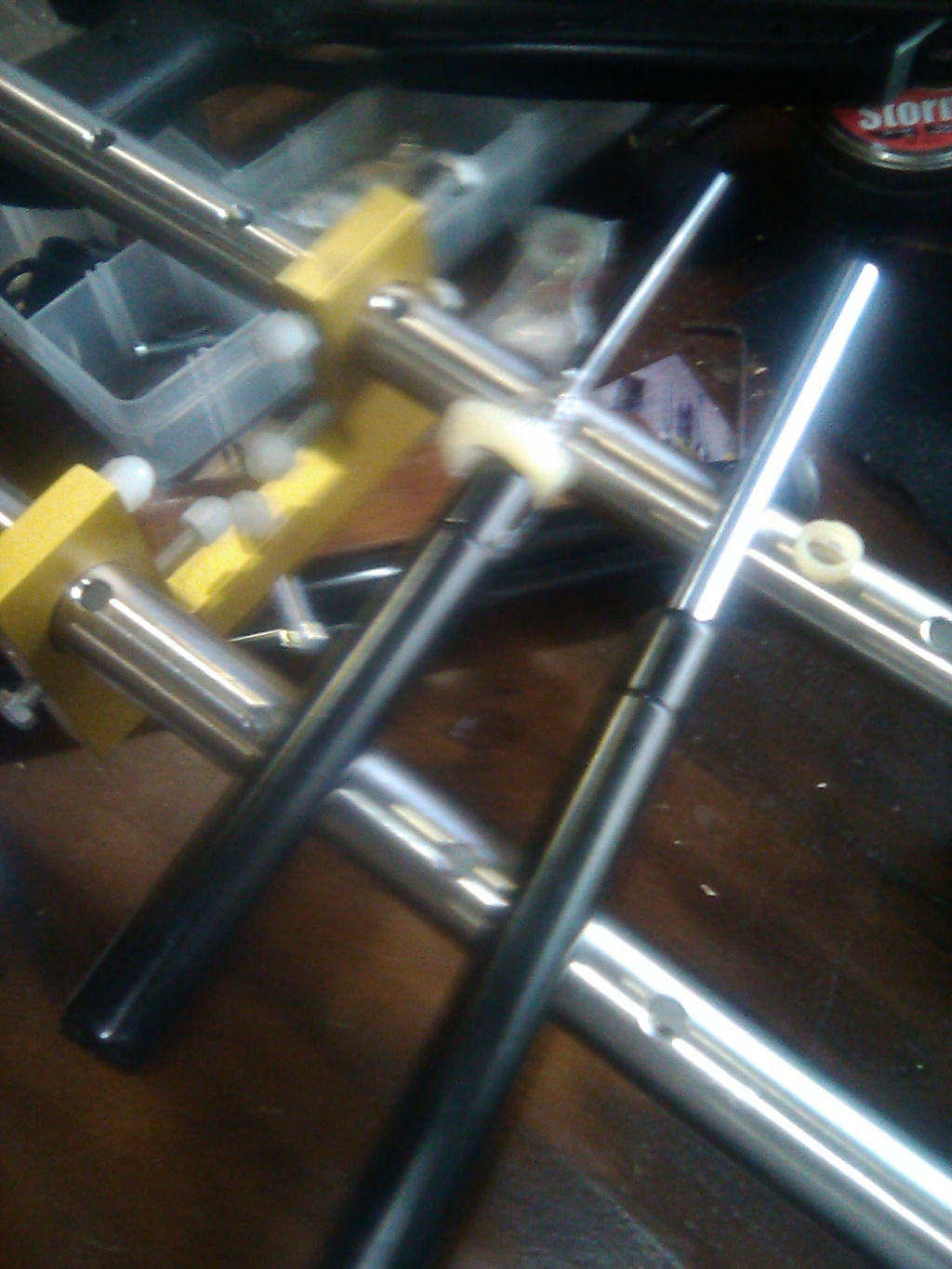

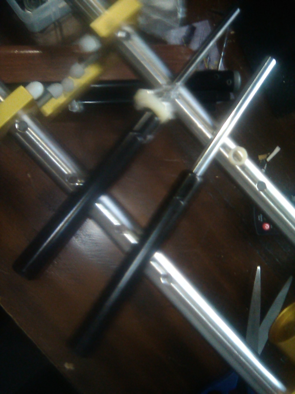

............ if you like it , and it's a crosman benji , i'd keep it. you must have a good barrel... absolutely gonna need a spring compressor , tho. i'm almost 300 lbs and when i tried to compress an trail xl ram against the brick wall - chipped the brick. it's prolly gonna be less than an inch... i have an extra b-square compresor if you need to use it. just order a new spring, and detent or pivot thing crosman - space that one up with tiny lck washers , putting one at a time under that spring down inside the barrel block. ( that would damn sure make your shots vertical erradic, tho).. parts are CHEAP from crosman. .. i hope have that same part number those early nps and npss ones had - much better rams. the np2's come with WELL made pistons , buttoned with dampener.. prolly outsourced because mine have an insignia on them. breech seal, strut , and piston seal , and the new spring and pivot locker ... i have most of those parts here now from when i was an auth repair and service center for cros.. i can teach you everything.. 817-798-4598 . you can refurb that one yours self for about $40 (shipping incl), im figuring. but if they have that same ram, it's more expensive but worth it. is it still hard to cock ? still have good power ? - paul .. -- ps -- i do have one - it's the one with the silver shaft , the black shafted one is the np2 gas ram... funny how more power from a trail np2 , yet the strut is smaller, and the shaft is skinnier on the np2 rams ( which are cheap - i cram these things into all kinds of hatsans and webleys)...got the seals, too (but np2 parts). however i can help , lemme know. pm me here. call or email ( i learned how do do this from a guy in alaska via phone (ray moody, aka super6) on a new diana 350... [email protected] . if you gotta a good one , and you decide it aint worth all this , lemme know ....some of those trail, and nps rifles even shot .22 lead balls good - when they first came out , the remington nps... ..... the .22 jim shockey is the one i like - it's been getting cheaper latey. same trigger (same trigger tune kit from ebay - $15 (it's the cbt trigger).... AMERICAN BARRELS , i dunno if the np2 struts are made here , but i'm happier wiith them than these adjustable hatsan hpa rams... you may ask for a strut for the benjamin rushmoore - that's what that silver shafted one was for , but you need to have parts numbers handy - i'll show you if you'd like.
..... hope that helps. ttyl..

Mine is completely flat on top with an edge that would have cut you. The wear has the face torn up even.

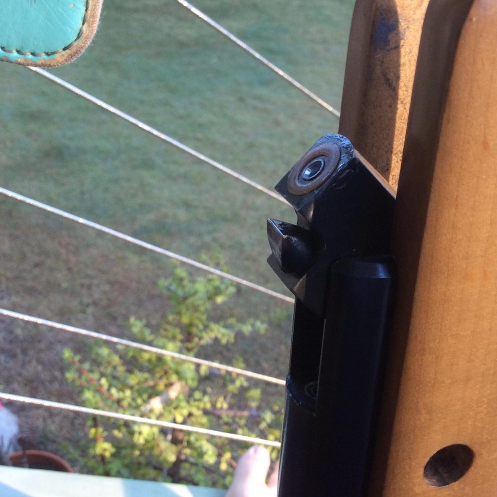

The marker shows a lug that is making contact pretty much all the way across the face and the contact on the bar is plain. It is never really over centers on the bar. Tightening the pivot helped, but i can still sit there and move the barrel up and down without unlocking it. It is not over centering enough to lock. I think I would have to replace the pin also. Barrel seal, rebuild action, lug, lug spring, lock bar, and still have to use the couple of pellets it shoots best once I figure out the clipping problem. I think I see a Maxxim in my future.

I am considering replacing the lug and then cutting an over center lip in this one to see if that doesn't cure it completely once I have new parts in hand for if the experiment fails. The wear pattern says i have plenty of travel to over center and lock quite solidly, but that the lug has no relief to extend and actually lock. .

Using a 60 grit diamond lap, i broke the sharp edge to about a 32nd, and then carefully took a couple of passes to produce a lip. It locks so hard i put moly on it as I break it in. Hard enough to hurt your palm after knocking it open a few times dry.
I don't know if i can convince you how little material I actually removed to produce that change, but it is as sensitive as working a trigger. Luckily, I don't want a one pound lockup!
Look at the pictures of the locking lug the Sig 20 uses for a shallow angle relief cut. There are pictures in another thread on this forum. I used a steeper angle to make a more pronounced lip.

.. i find that the lighter h&n ftt pellets , which are 13.13 grains and produced for hatsan as vortex express pellets , do great from guns in this power range (670-770 fps) - and they are a consistent head size and cheap at field supply .com .. in the photo in my above comment with the two gas rams on top of a spring compressor , it is the one on the right with chrome shaft. .. i believe this part number 3 in diagram here is what you need. it's a better-made strut, but seems to have been about $10 more than the np2 strut : file:///C:/Users/hp-user/Downloads/BT9M22CNP.pdf - paul.
