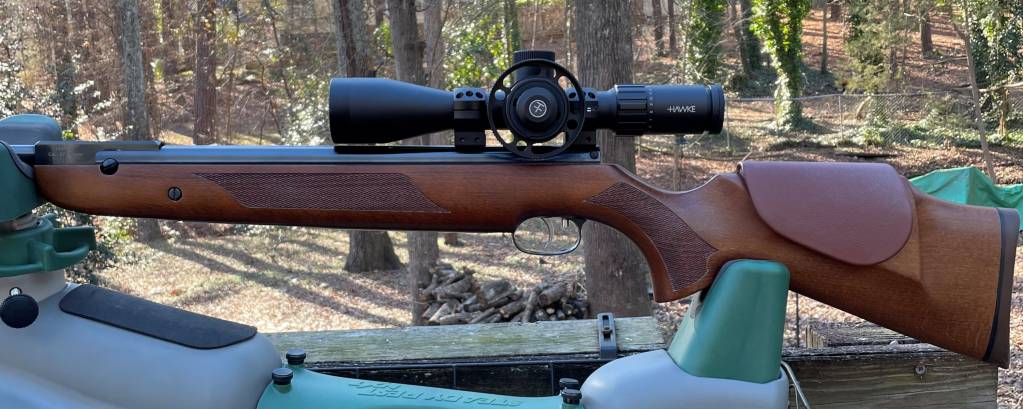

I installed the Hawke Airmax Compact 4-16 x 44 mm scope of my HW95L and this is an accurate combo and lots of fun to shoot.
