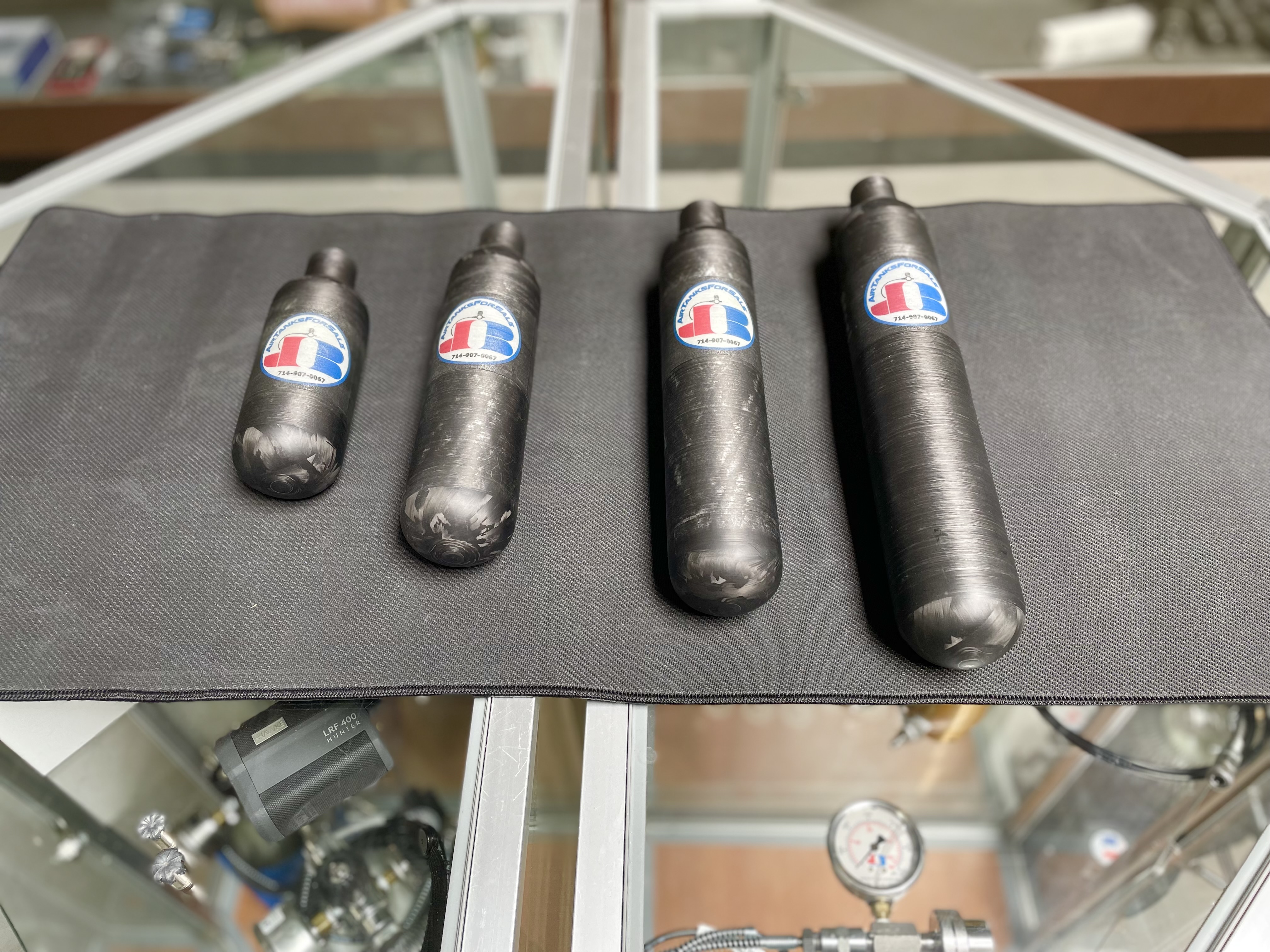

TopGun-Airguns is proud to announce our new JB Ally line of Carbon Fiber Air Tanks!!
TopGun-Airguns is proud to announce our new 700cc x 300 Bar bottle for FX, Daystate, Brocock, LCS, Rattler and many other PCP rifles. These are from the same manufacturer that provides bottles for Brocock, Daystate, FX and many other high quality PCP Airguns and are DOT approved. This series of tanks called the “JB Ally Tanks” are available in 300cc/480cc/580cc/700cc x 300 Bar and 6.8L & 9L in 310 Bar and can be found at our website here: https://www.topgun-airguns.com/product/ally-airgun-tanks/
These tank provide a greater number of shots, due to their higher max pressure and larger volume.
Increase in shots is calculated by Increase in pressure (assuming filled to 300 Bar, refilled at 120 Bar=1.35x) times increase in volume (depends on size of bottle being replaced).
480cc/250 Bar bottle =2.0x as many shots = 1.35x1.46
580cc/250 Bar bottle =1.6x as many shots = 1.35x1.21
700cc/600 Bar bottle =1.35x as many shots = 1.35x1.0
