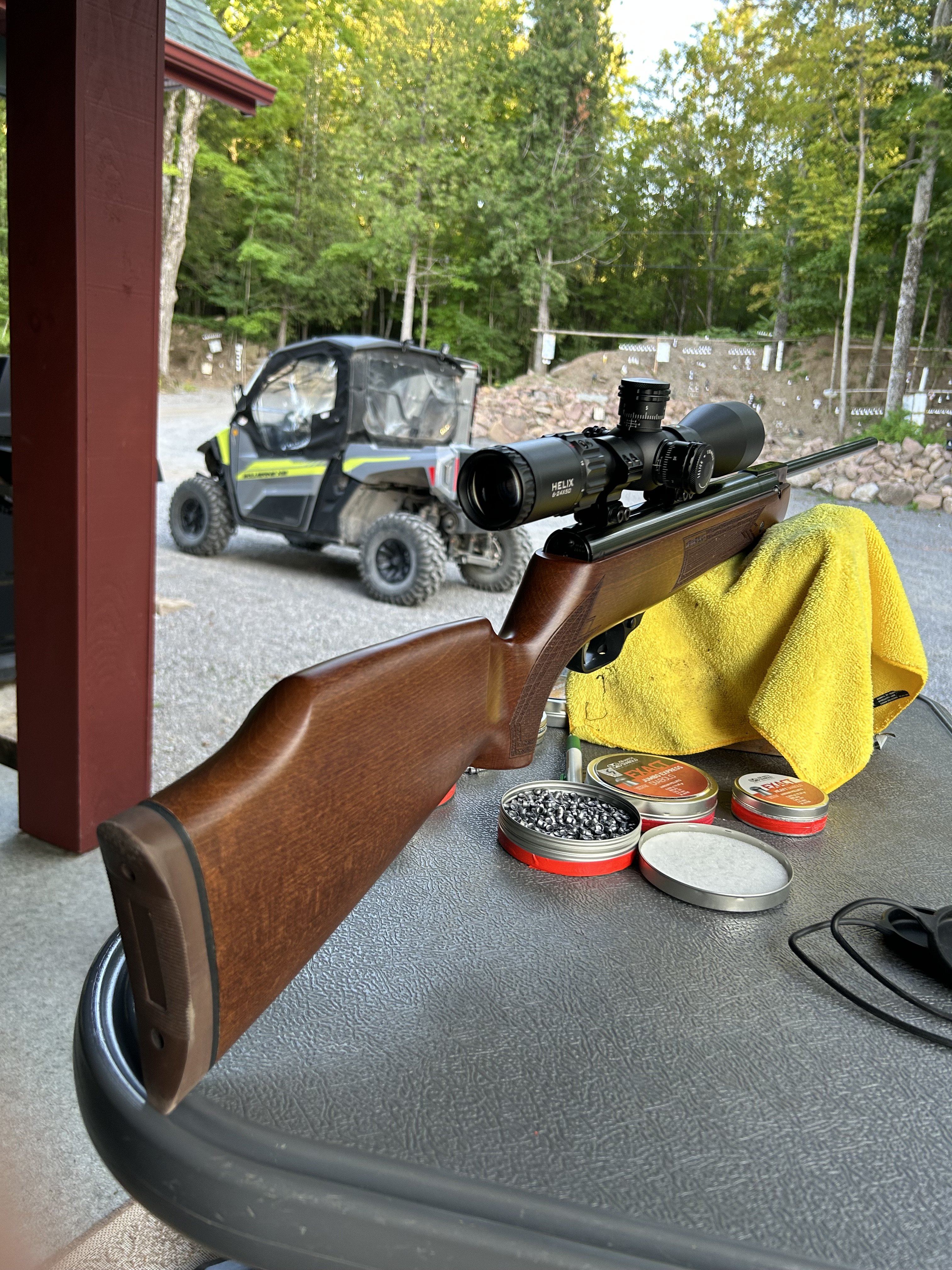

I took my HW90 .20 out on my range this morning. As usual I was stunned by its performance. Once zeroed it was flawless.
Odd for me to say, because a HW90 .25 was the first Weihrauch I bought, absolutely hated this gun. Sat on wall after, for 2 years.
A member Jayjay did a post on the 90 which blew me away. That’s when I bought the HW90 .20 and the pump and gauge. At the same time I bought a few Weihrauchs, so again the 90’s sat and waited.
On a post of mine a member Frogy kept posting his 90 .22 cal. how awesome it was at 18 bar. Finally gave me the drive to dig out the 90’s. I put mine at 18 bar, presto, you wouldn’t think it’s the same gun.
‘Love the triggers, on the .25, it went from a danger to a dream. All I did was turn it down to 18 bar. No explanation.

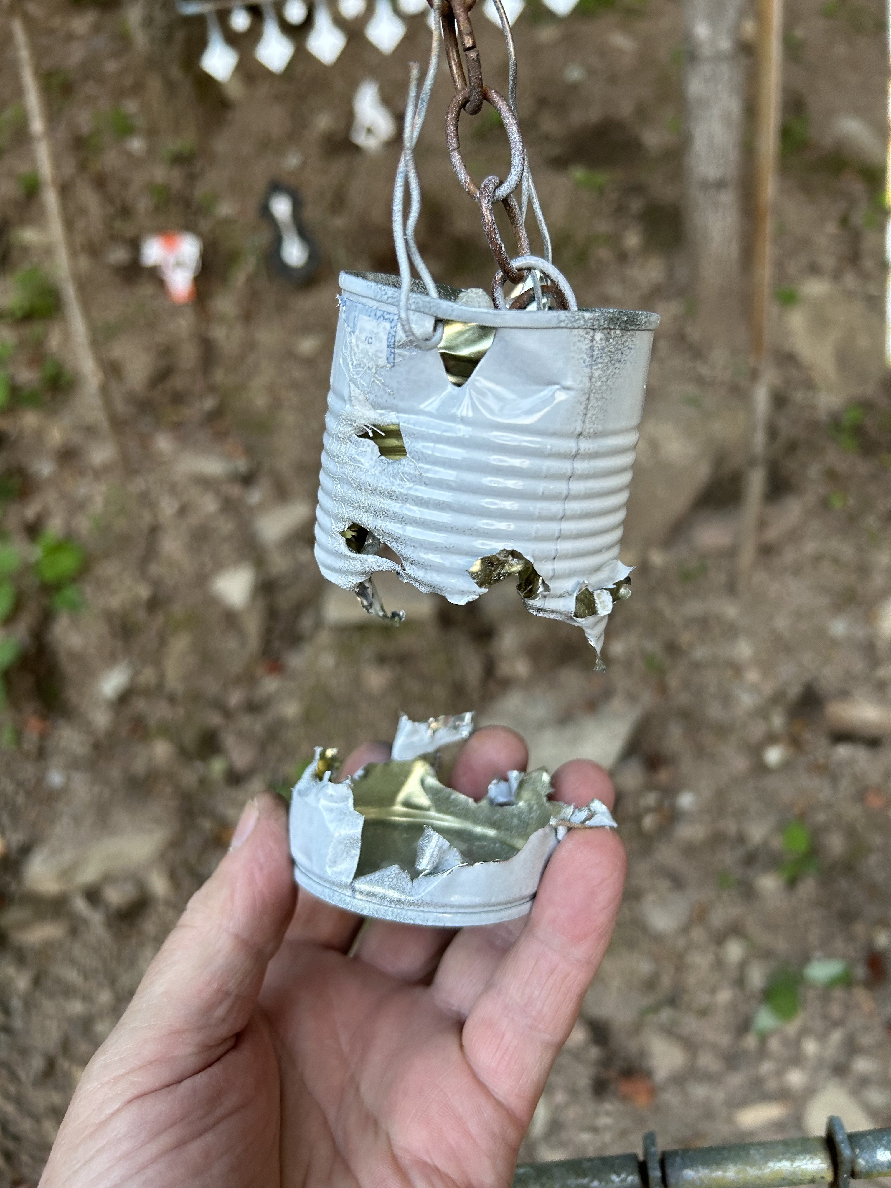

‘Cutting a 10 oz. Mushroom can in half hanging by chain 30 yds. Best with a 97 .22 was 38 shots. The 90 .25 blew that away with 34 rounds. With the 90 .20 today, killed it at 30 rounds. What a gun.
I’m not sure which model was a Beeman, like to see a few. If you have one, or a 90, love to see your gem. Crow
I took my HW90 .20 out on my range this morning. As usual I was stunned by its performance. Once zeroed it was flawless.View attachment 384459Odd for me to say, because a HW90 .25 was the first Weihrauch I bought, absolutely hated this gun. Sat on wall after, for 2 years.

‘Cutting a 10 oz. Mushroom can in half hanging by chain 30 yds. Best with a 97 .22 was 38 shots. The 90 .25 blew that away with 34 rounds. With the 90 .20 today, killed it at 30 rounds. What a gun. View attachment 384717

Awesome shooting with your incredible .20 HW90 Crow! How fun...never thought to cut can in half before, now you have my interest piqued! Ha!

Thanks. It’s harder than you think, especially swinging from a chain. Crow
