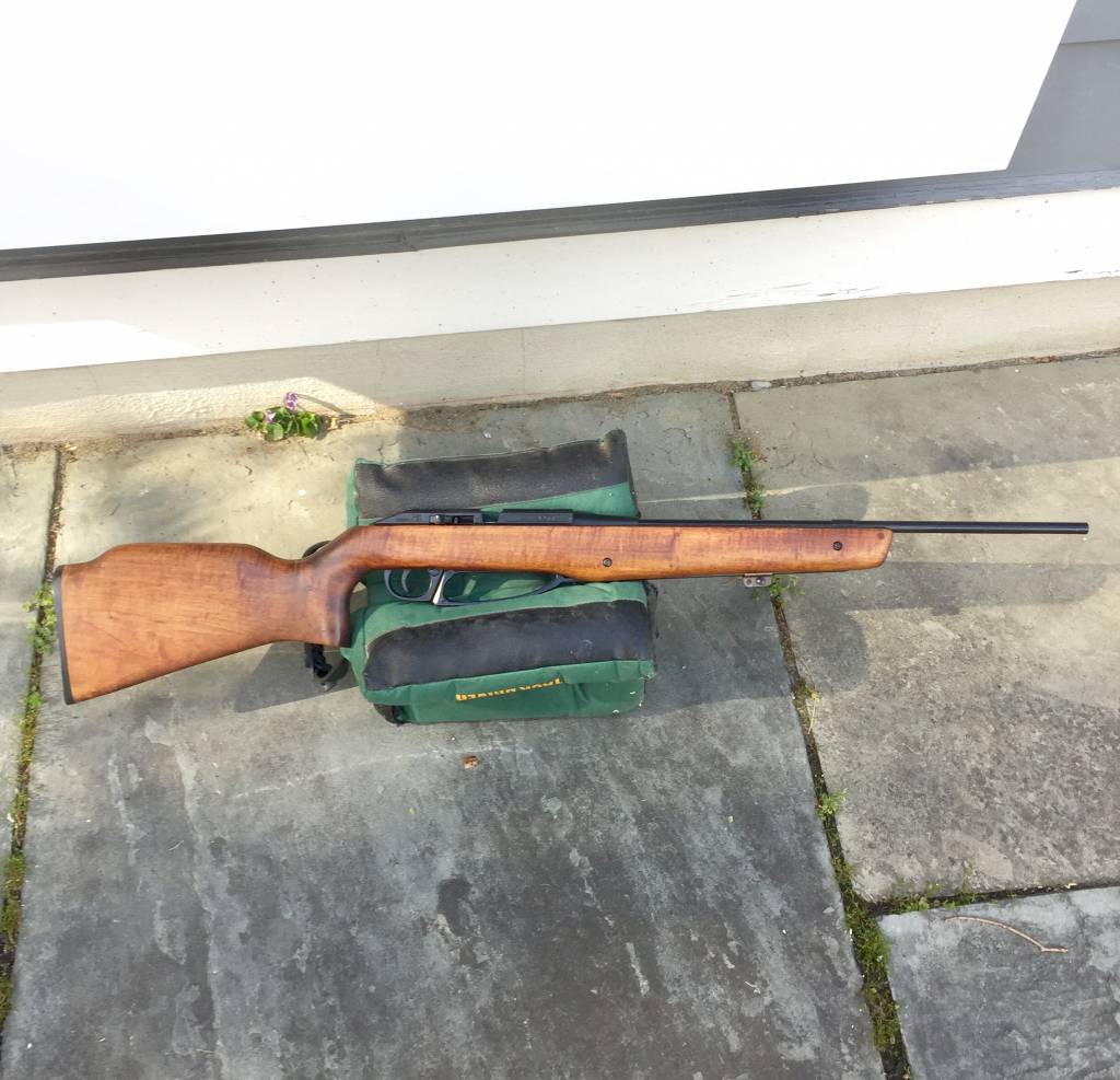

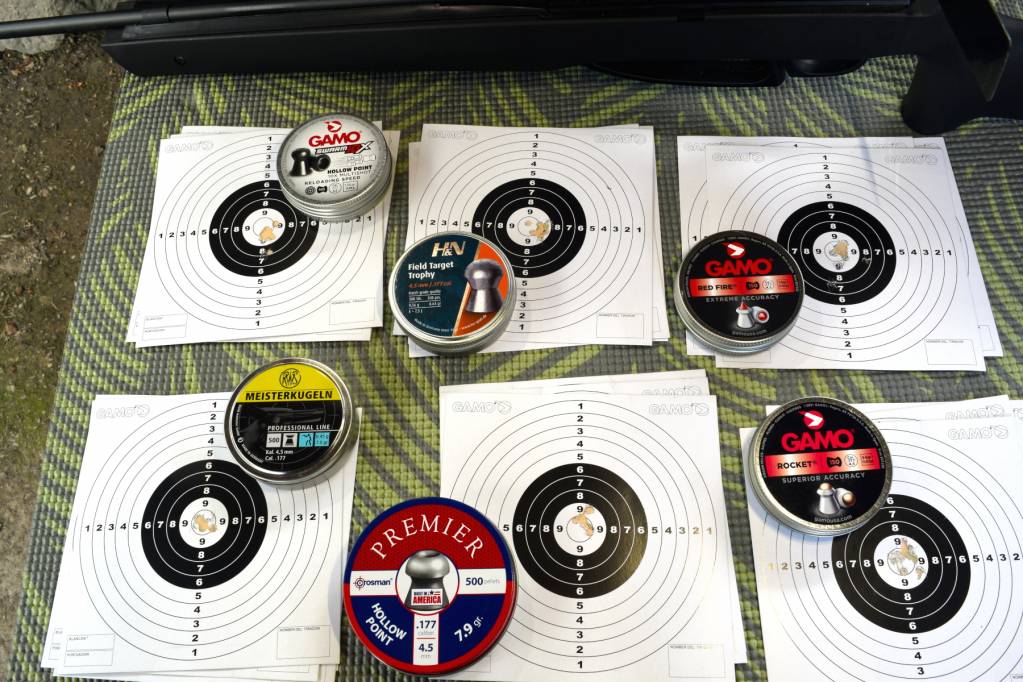

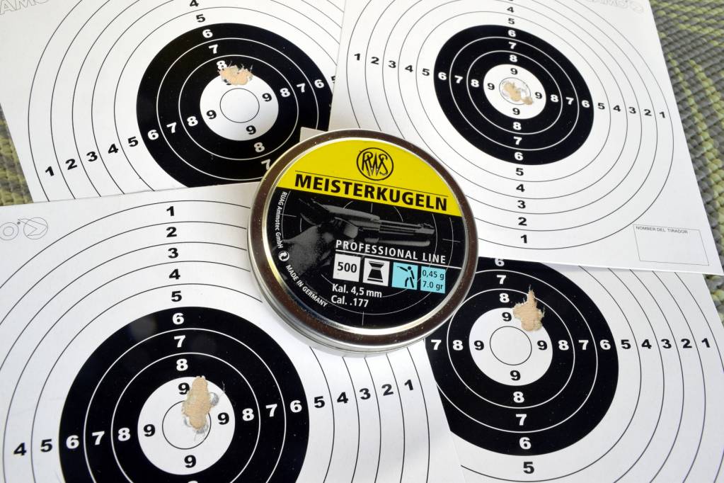

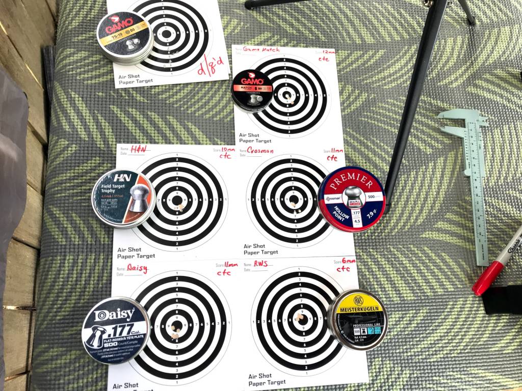

today's ammo test with the Daisy "Avanti" 753

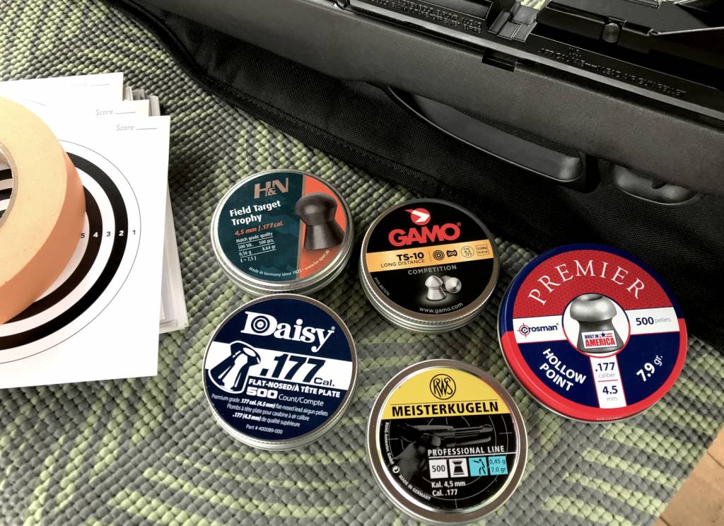

Tired several of what I have that fits. 10-shots per target, best of 3 targets shown.
I mixed the lot every 10, to offset the shooter and the gun warming up with practice.
I think the RWS Meisterkuglen takes the title. Consistently better groups than any other.

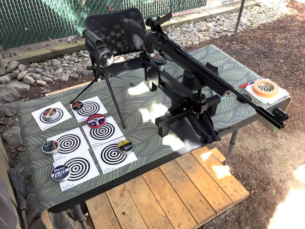

Benchrest at 50'. Testing the gun today, not the shooter, so it's on a tripod. Open-sights (diopter).

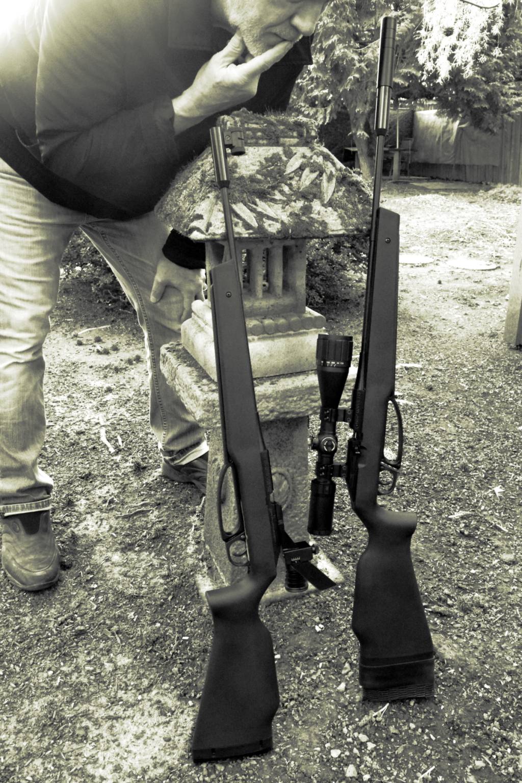

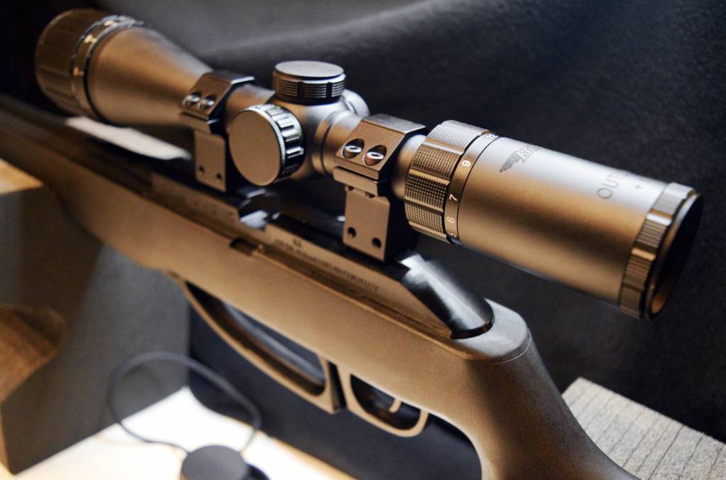

BSA optics sent me a scope. It's "rated" for a magnum break-barrel, so it might be overkill for this little gun. :)
But hey, it's going to be great for my night #backyardplinking. The glass is a lot clearer than the Hammers I just took off.
Sighting in at 50' tonight, gonna be dark soon, I look forward to trying it out. If I get the time, I'll move over to the 25Y side.

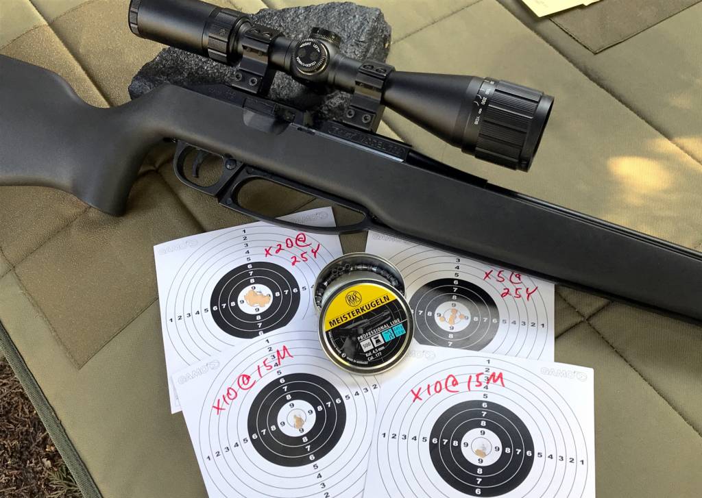

today's testing crew. wind is calm, rain has stopped, time for a little #backyardplinking

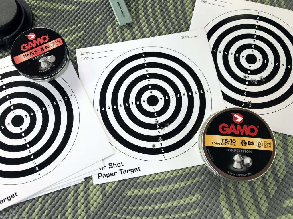

These will be benchrest, 15M (about 50'), 5 shots each at 5 targets, I'll pick the best of the set to pic.
(sometime later...)

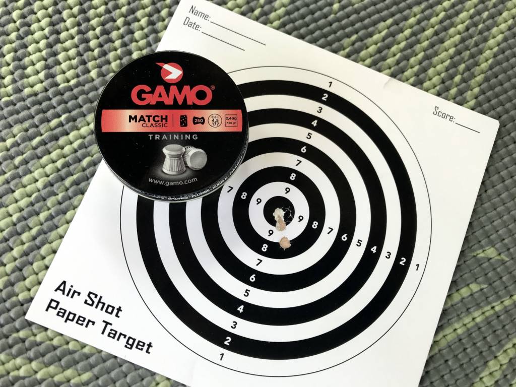

The TS-10s will not group worth anything in this gun, so I've disqualified and replaced with Gamo "Match" wadcutters.
(sometime later...)
Not a "winner" this time, but that's better.
(sometime later...)
RWS Meisterkugeln wins the match. Almost all others in the list had flyers, these never did of 25 shots each.
I have some 8.2gr of the RWS coming, in hopes they'll handle windy days a little better. A lot more noticeable drift at 25Y.
