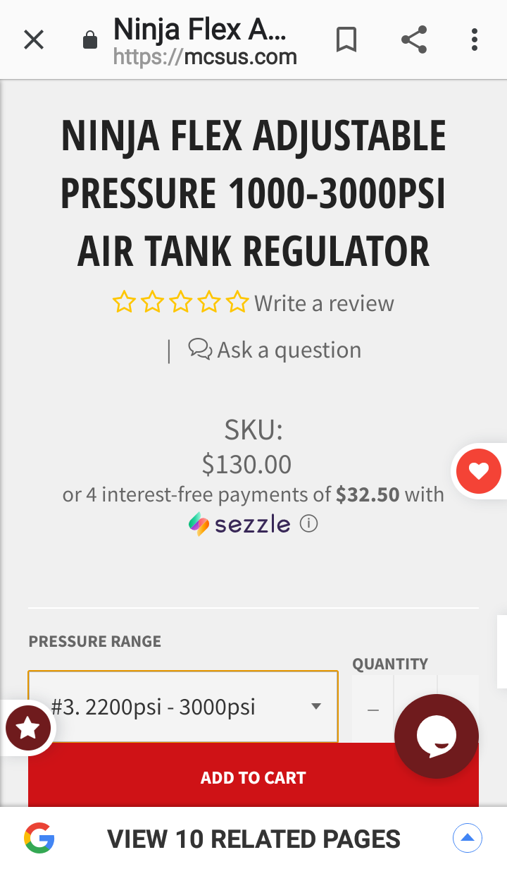

For anyone interested, I came across these today. There don't seem to be many, but it would seem that they are not exclusive to JSAR
https://www.ebay.com/itm/Ninja-Flex-Regulator-for-4500-psi-Bottles-Adjustable-2200-3000-psi-Output-PCP/124280834225
Also I had mine apart tinkering today and found they have the same shim/bellville washer setup as a regular ninja reg so for those that would like to run at lower pressures, it is as simple as removing some shims. I was able to get mine down to 500-1500psi removing 2 of the 3 shims but brought it back up to a range of 900-1900psi with 2 shims which works out great for me switching from .177 to .30. The amount of flexibility this gun has is just awesome. Cool thing is that once I got it shooting around 15fpe with the reg at 900psi I turned it up to max just to see where it would land and without changing the hst or the striker depth I was getting a very consistent 575fpe with 8.4gn, just a hair over 6fpe. The weather is starting cool off slightly and I finally have some free weekends so I plan to get a lot more shooting done in the near future. I've got a lot more to learn. Ideally I want to be able to switch between the two calibers with as little adjustment as possible
