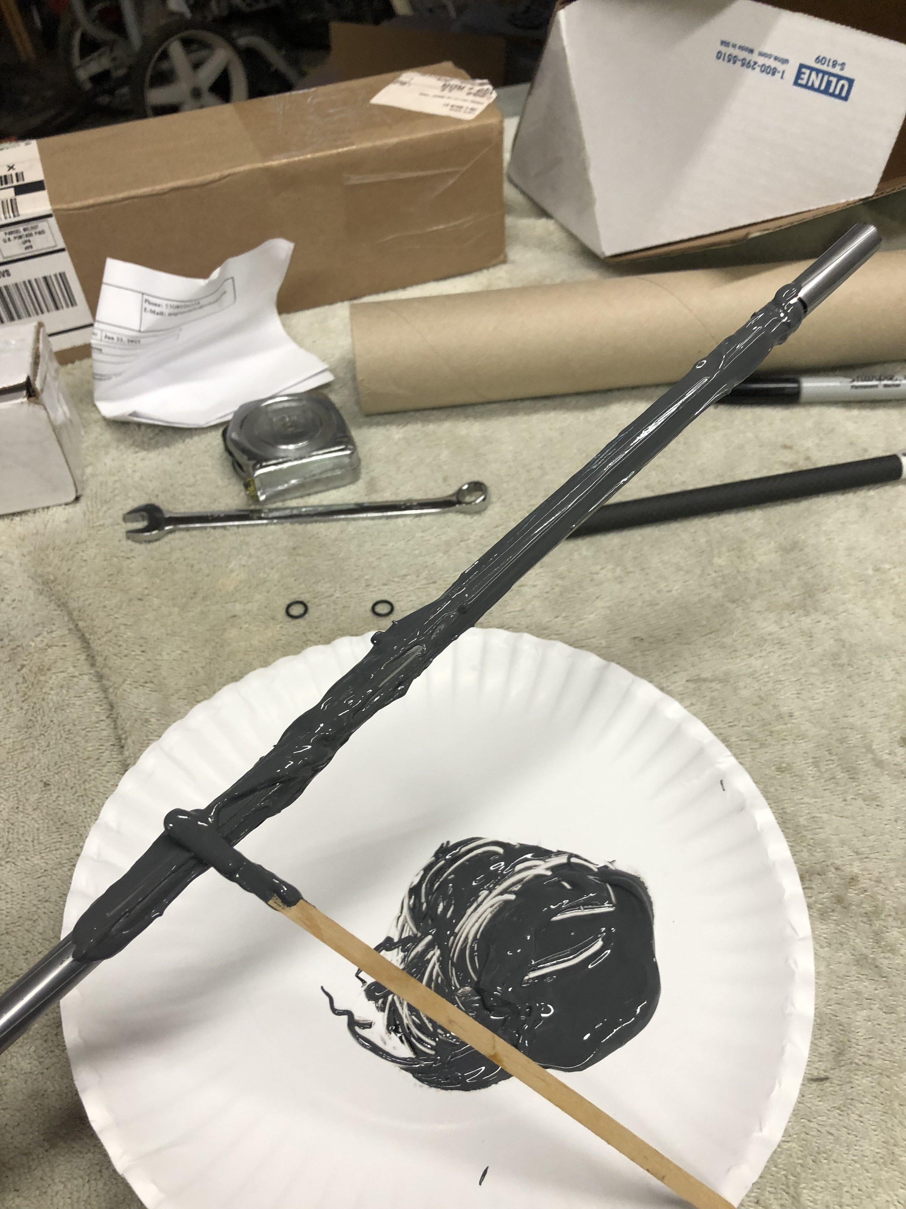

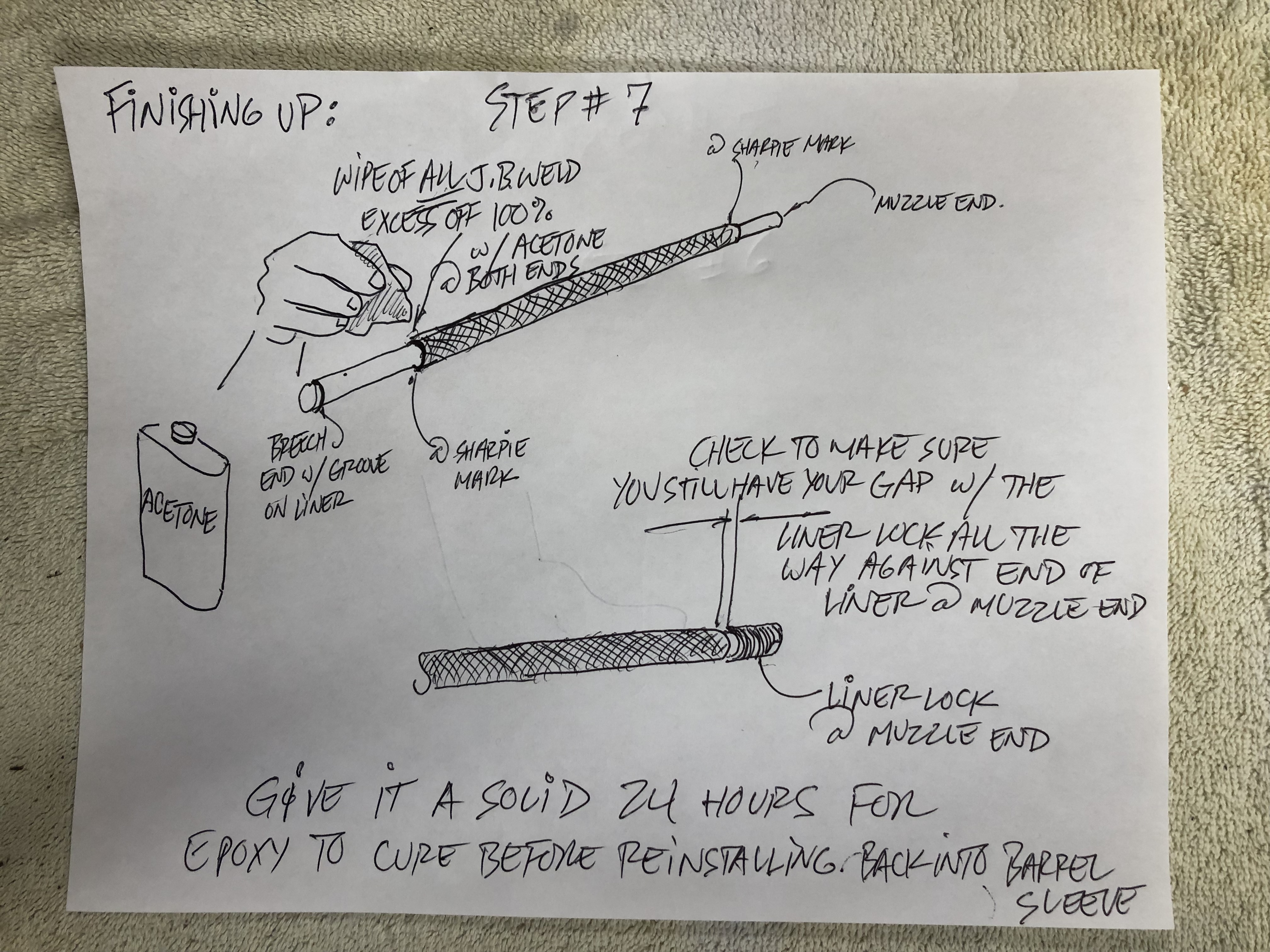

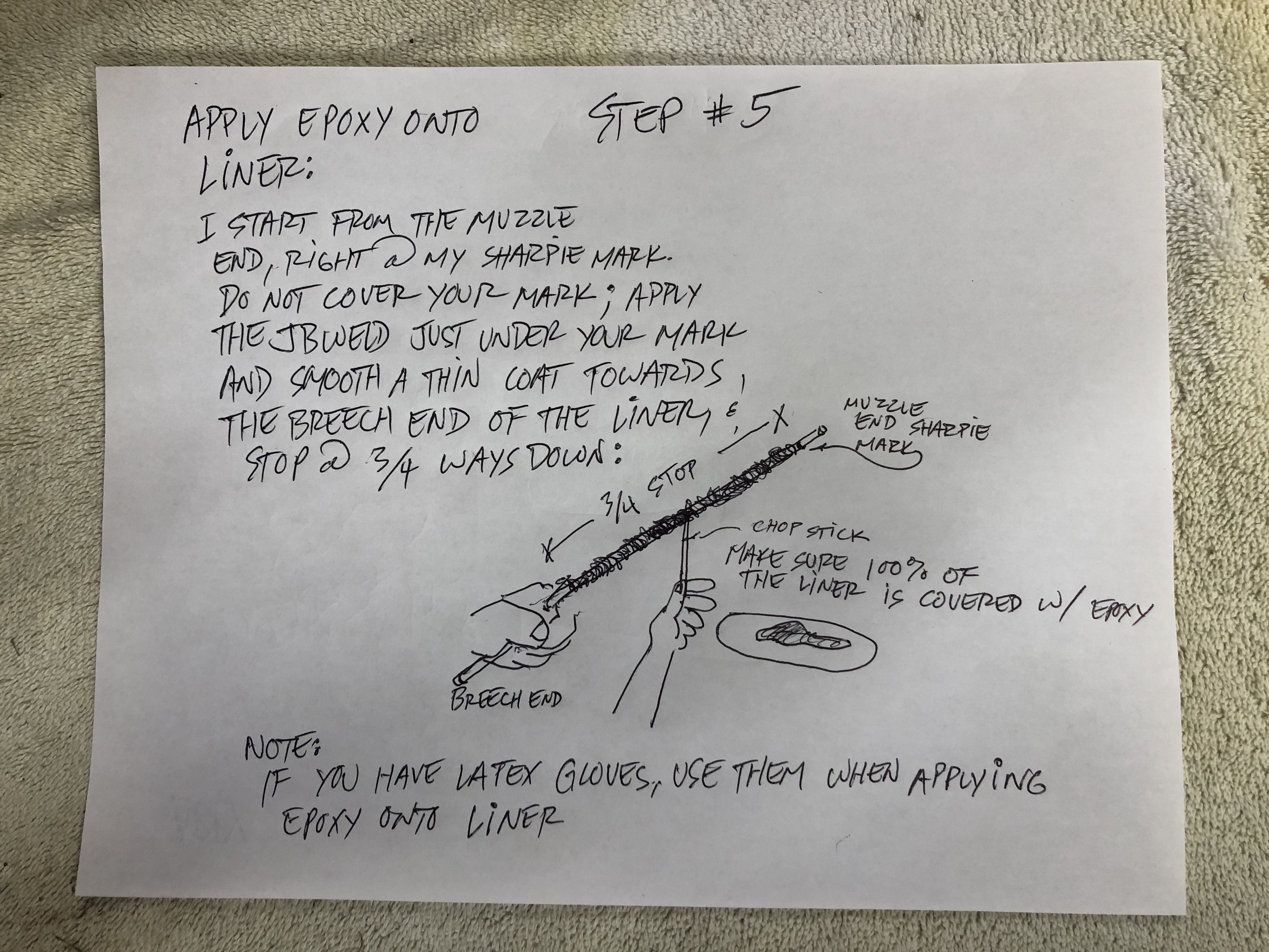

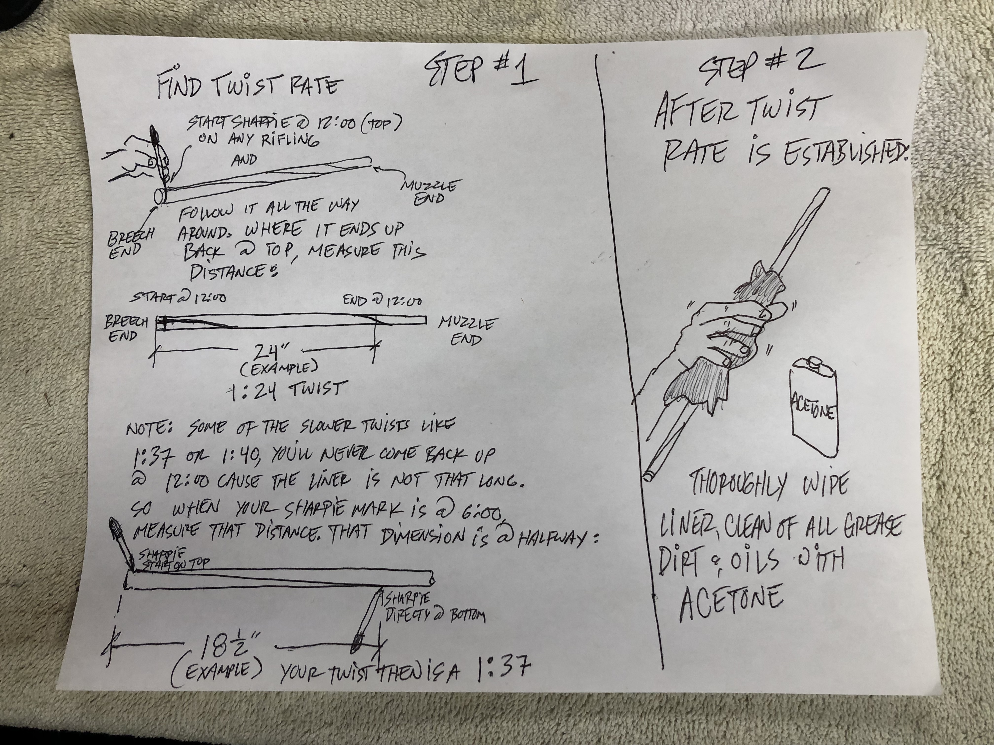

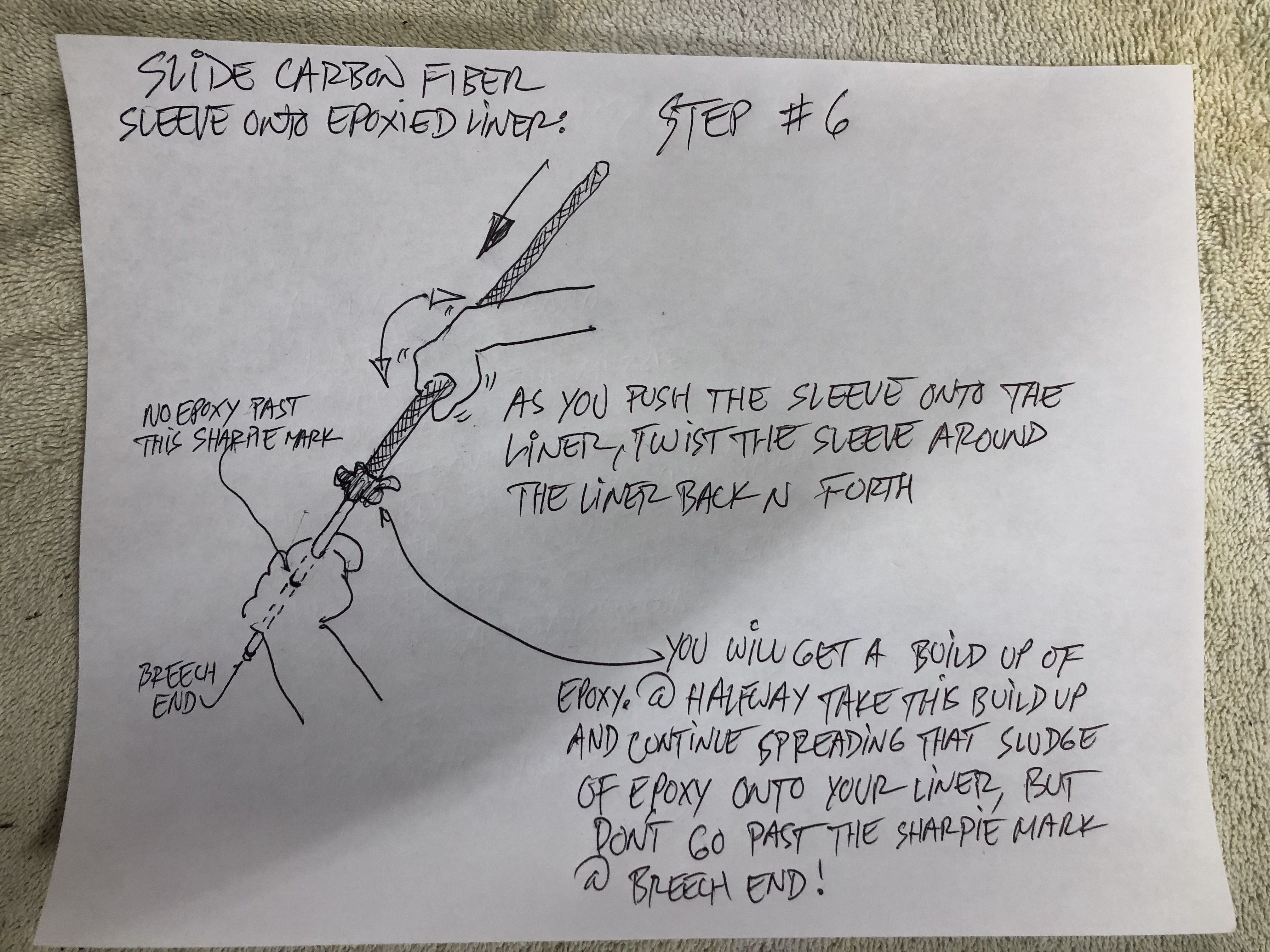

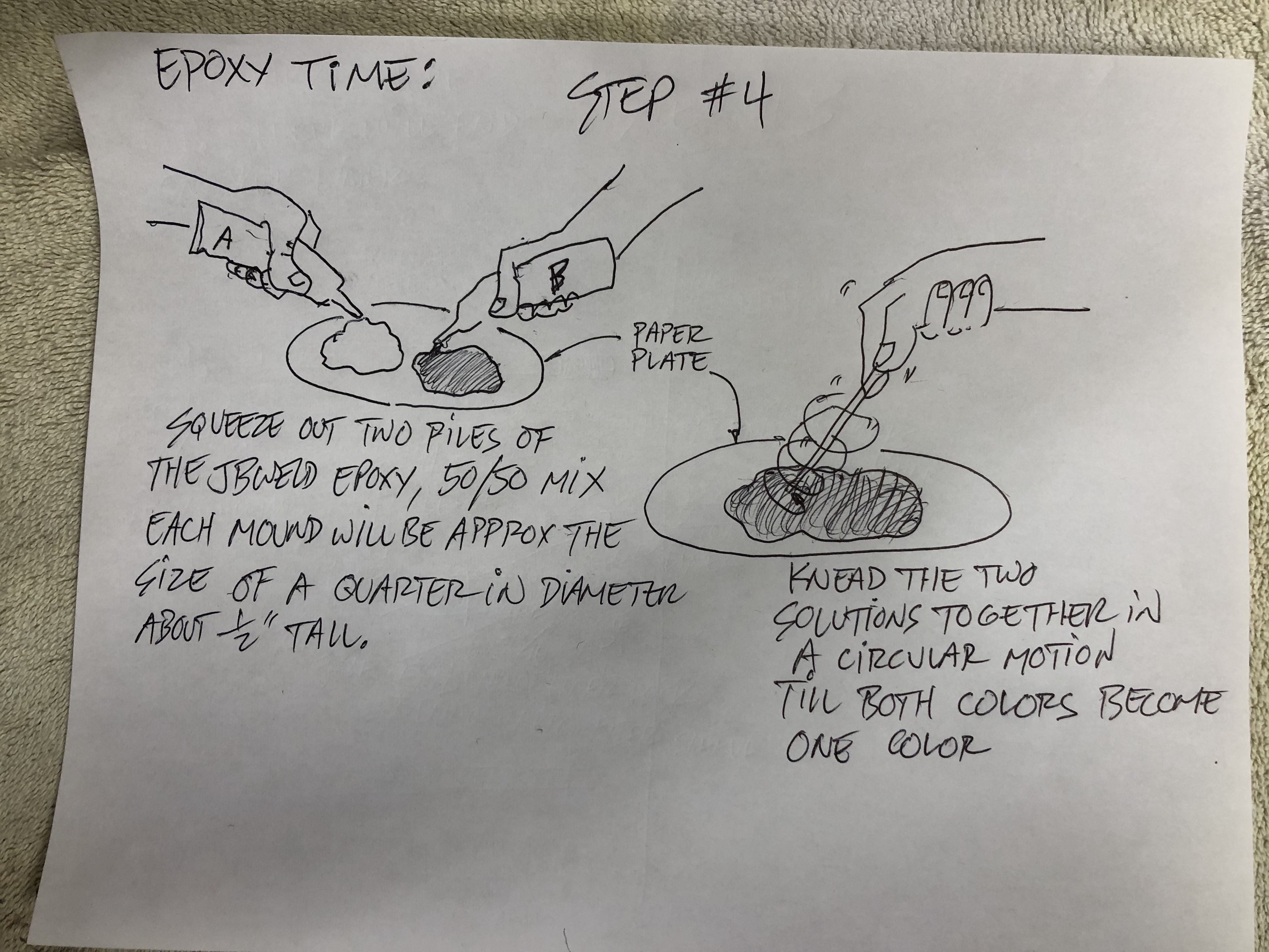

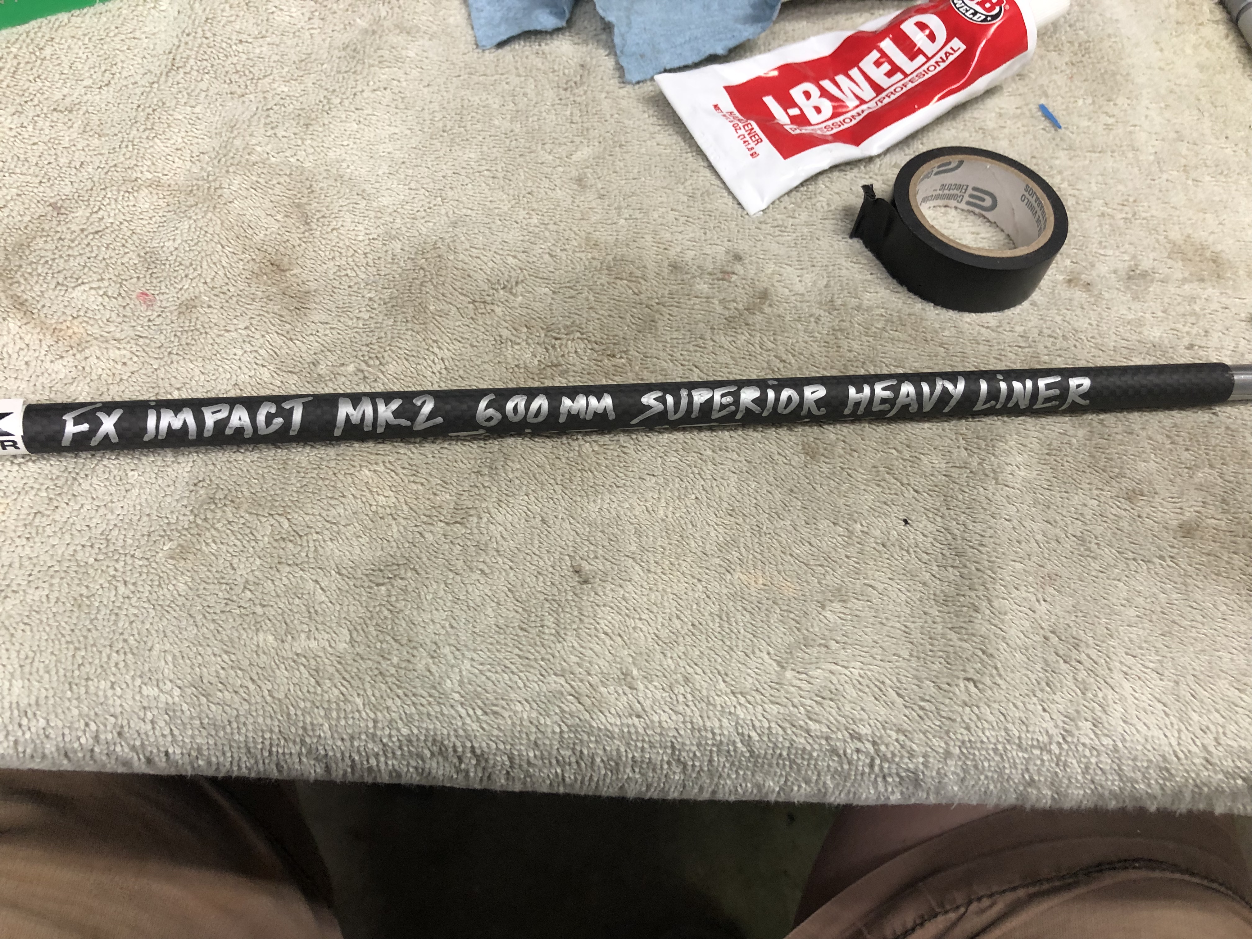

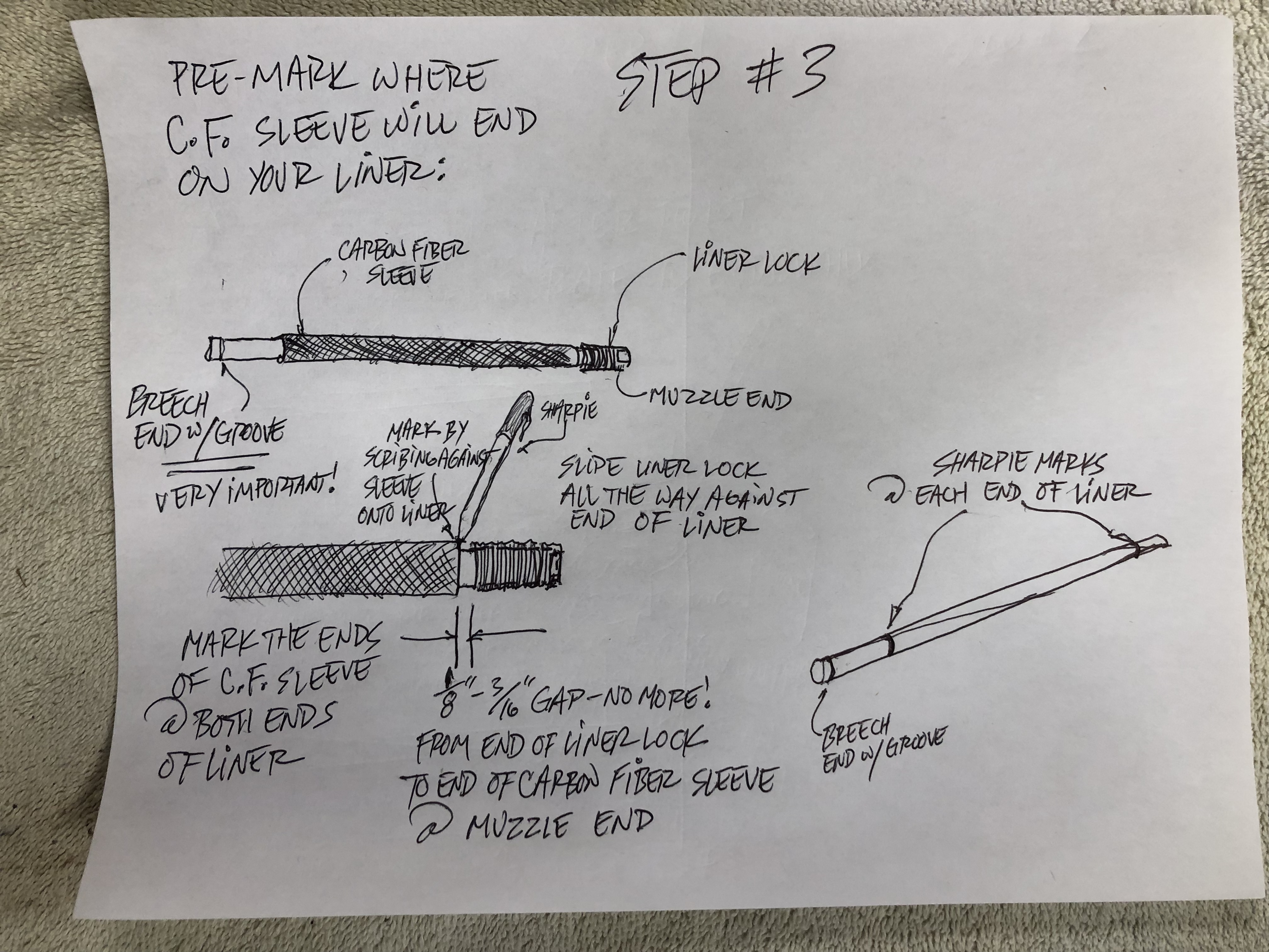

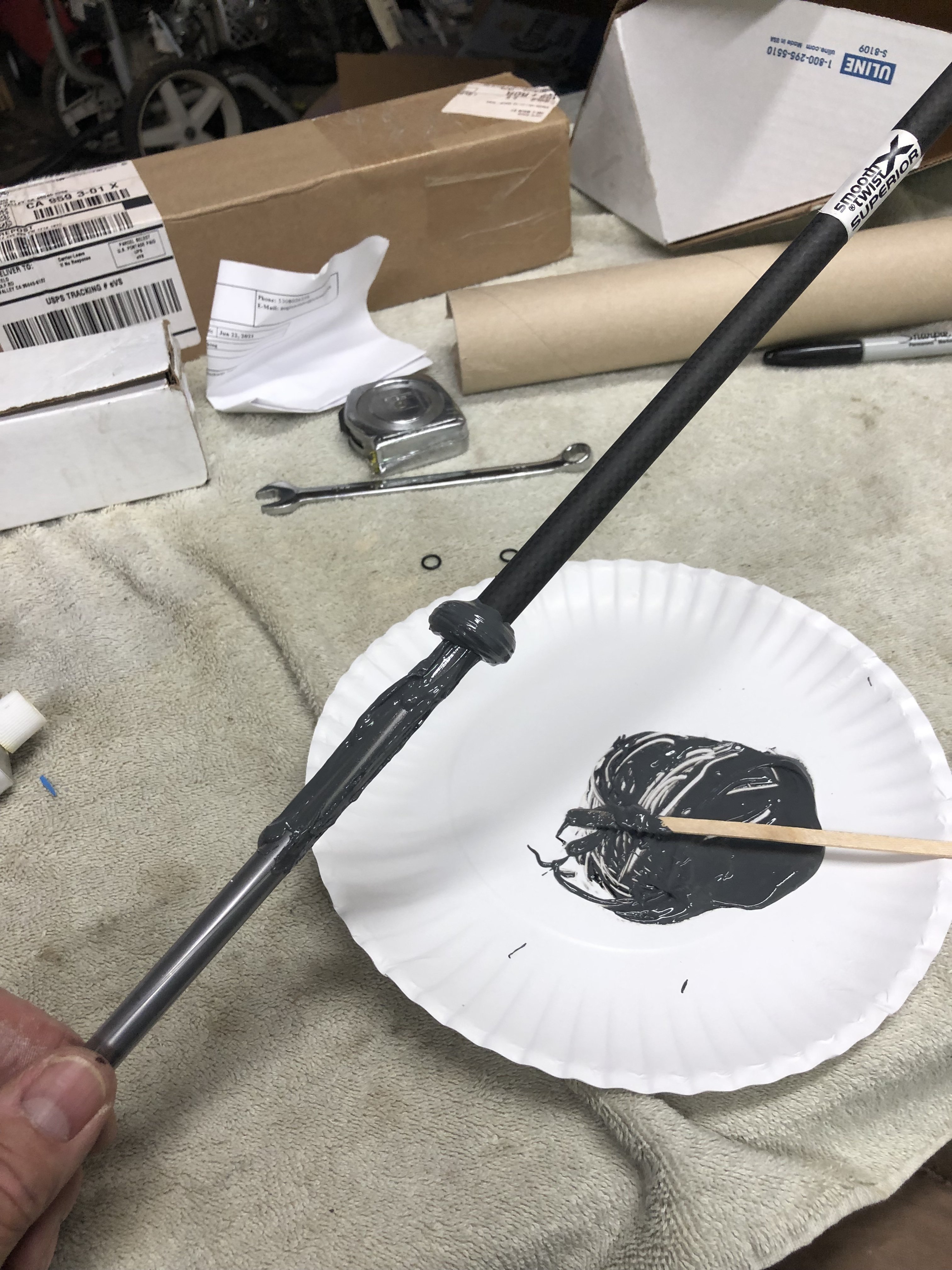

JBWeld standard set has always been my go to. I drew up a tutorial that I sent a member, and if no one minds, I’ll share it for those that have never epoxied a liner sleeve on before-
View attachment 357880View attachment 357879View attachment 357878View attachment 357877View attachment 357875View attachment 357876View attachment 357881View attachment 357882View attachment 357883View attachment 357884
Did doing this improve groups ? Or what did it actually do for you Bigragu
Really good write up, drawings, & photos. I modified your procedure a bit by applying a thick roll of tape at the muzzle end where the carbon would stop & butt against it. I also started from breech end.. That way the wave of JB pushing out ahead of the carbon wouldn’t obscure the stopping line. I allowed about 3/32” from forward end of carbon to rear of muzzle nut & the tape ensured it was precise.

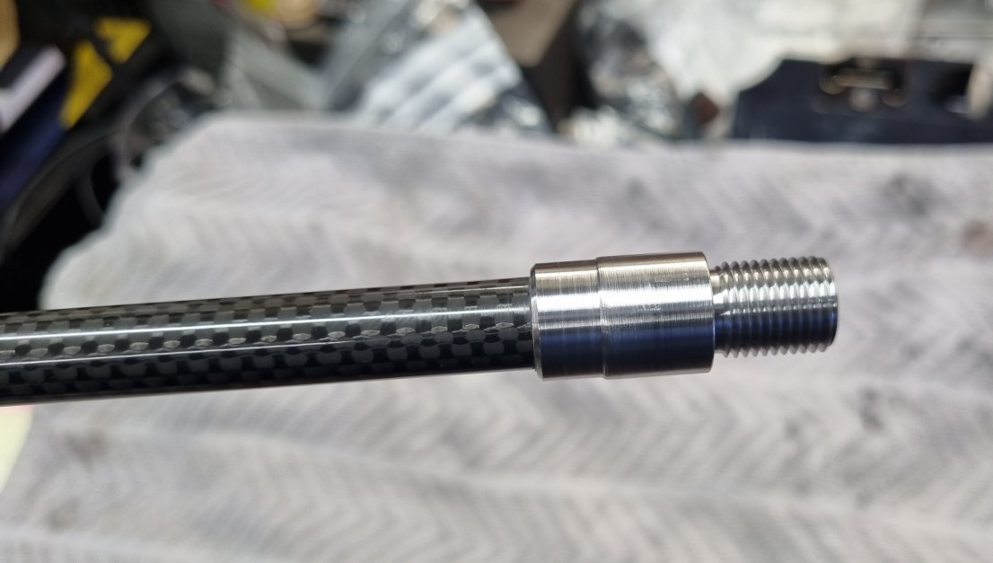

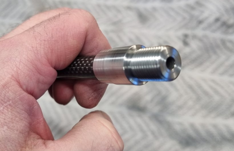

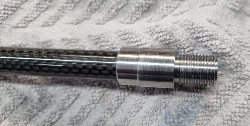

I use the bonded method, but I also bond steel ends on that overlap Carbon Fibre (official FX Stiffener). Then thread the end. After you can put another bit of Carbon Fibre on as a finish.
