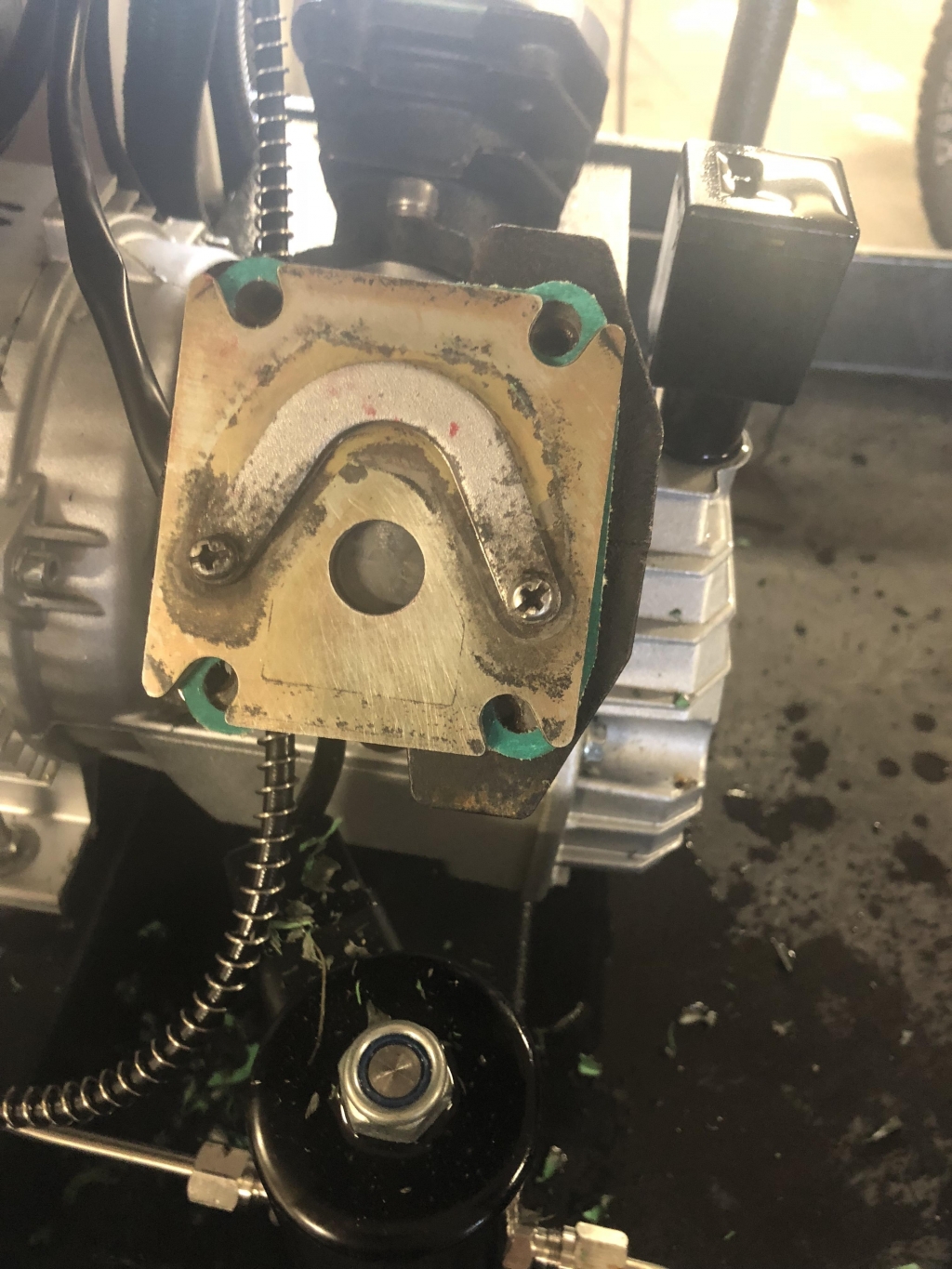

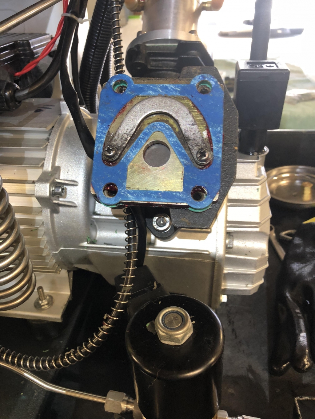

No piston rings on the low pressure cylinder, just a stainless reed flapper. Not too long ago I read that letting a compressor sit idle is not a good thing as things gum up, especially the low pressure side where it takes in air just thru a paper filter. If any gunk/debris make it into that low pressure head, it’ll cause that flapper reed to stick and not suck in the air it’s suppose too, that’s why I say if I had to do this all over again the first things I’d check are:

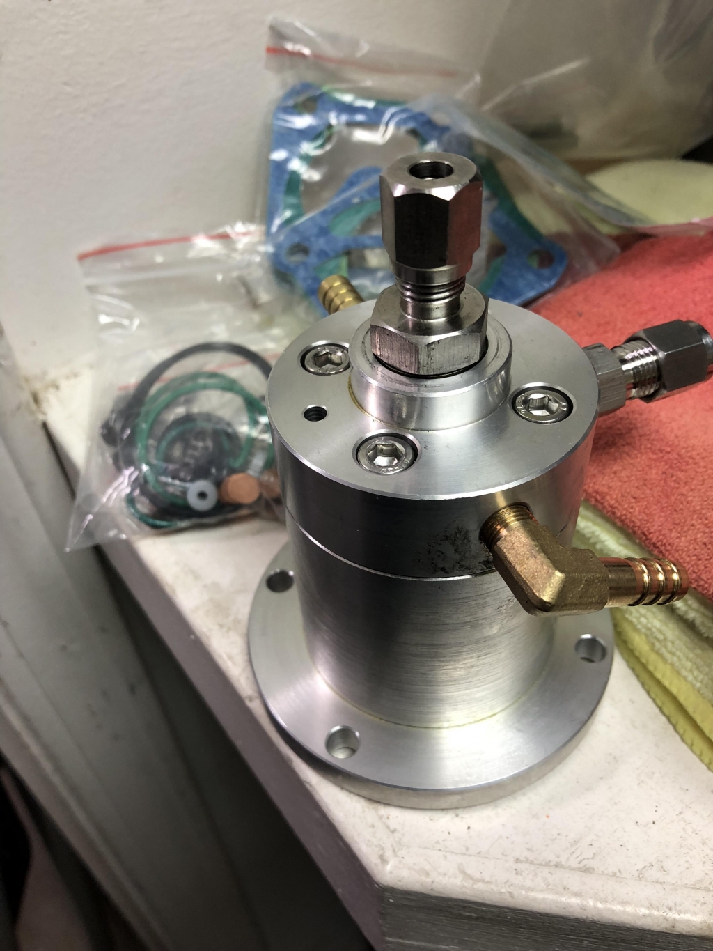

2. Check and swap out the gold tower cotton roll filter, and the desiccant media inside the aluminum block(if you do a search on my topics, you’ll see I did a whole write up on servicing the filtration components on the Lightning with pics almost a year ago)

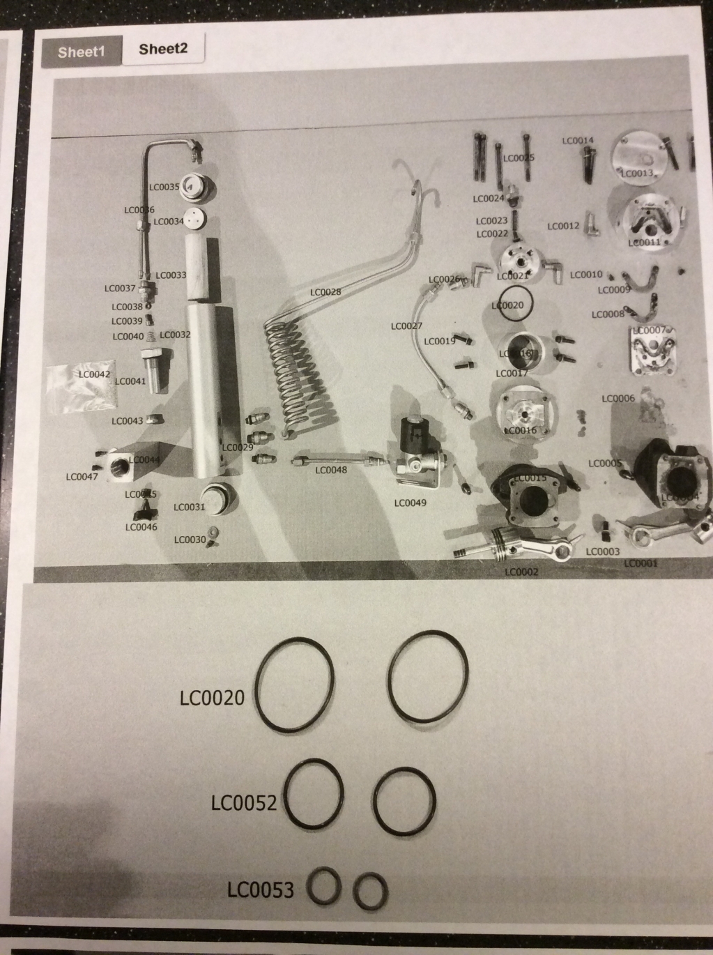

please note- your o ring kit that came with the compressor has every o ring for that thing, but one. It is the green Viton o ring that is inside the gold tower, on a baffle divider that sits on top of the cotton media. Do not tear that, toss it, or stretch it out, as you’ll need it.

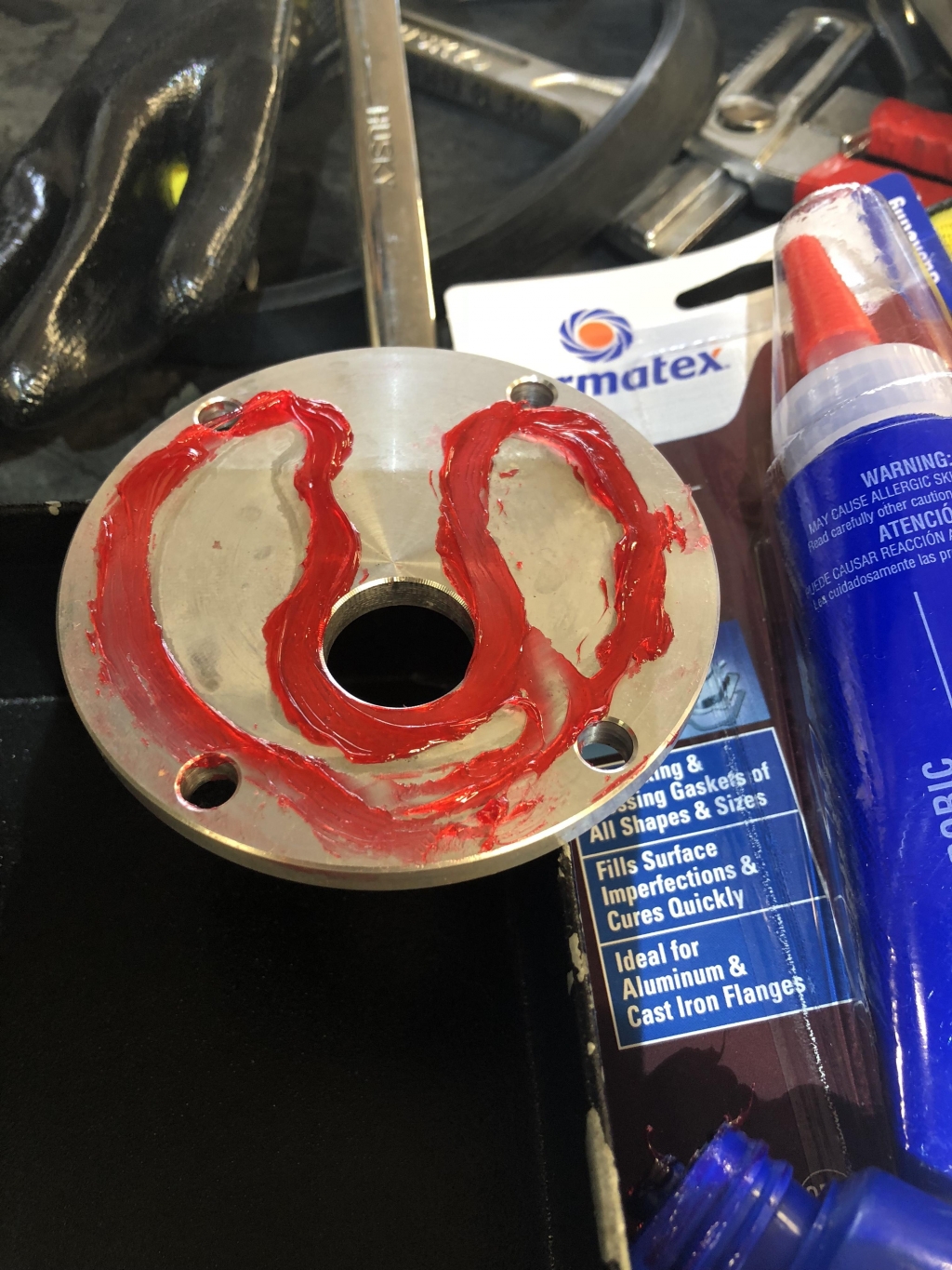

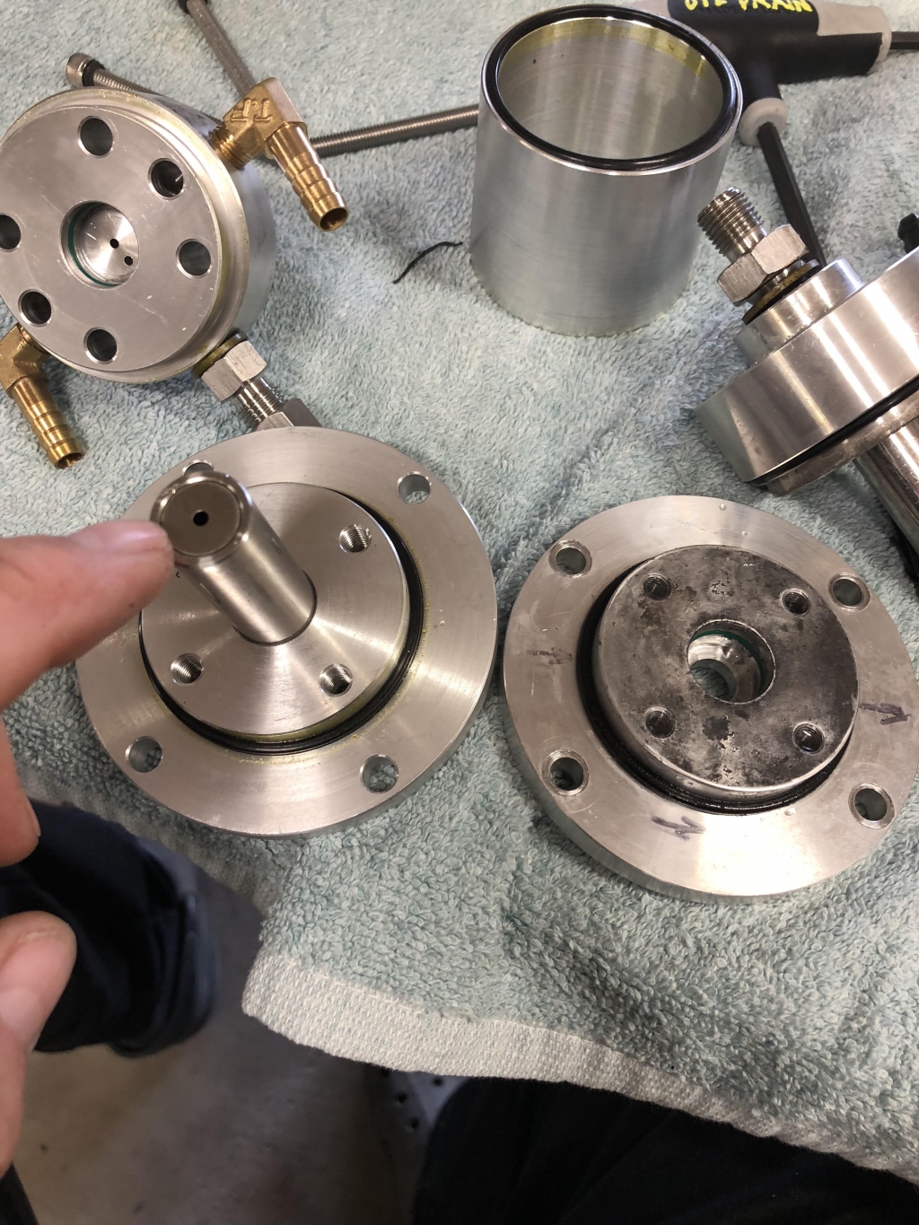

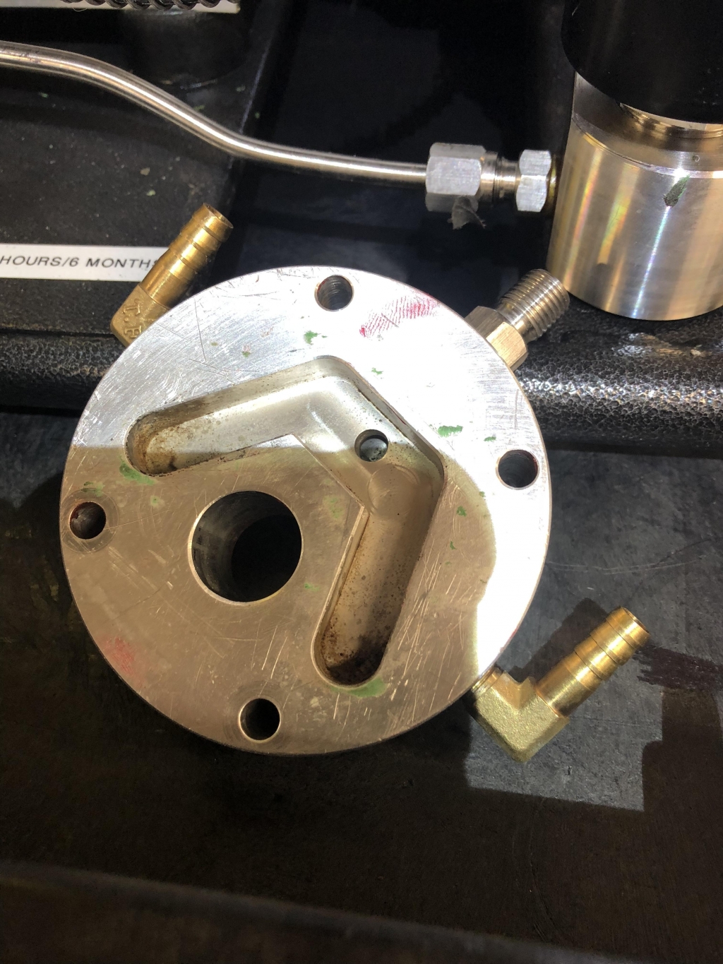

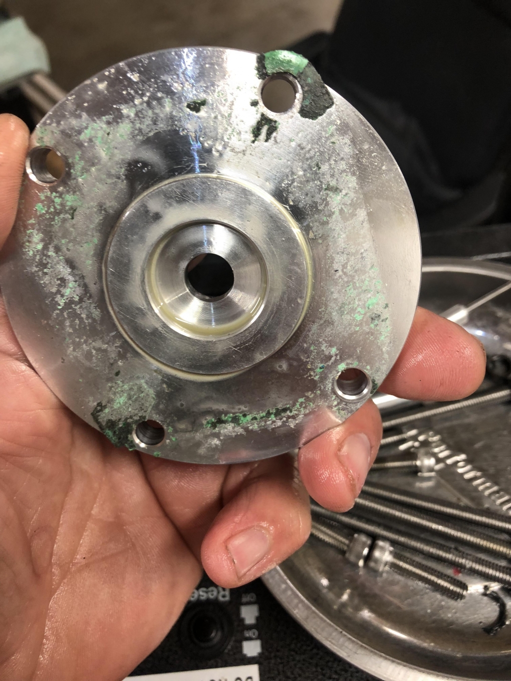

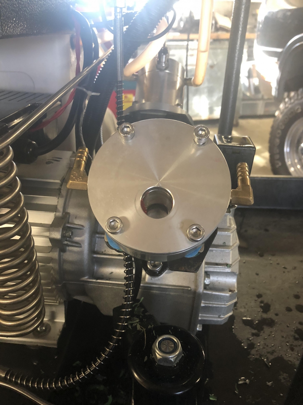

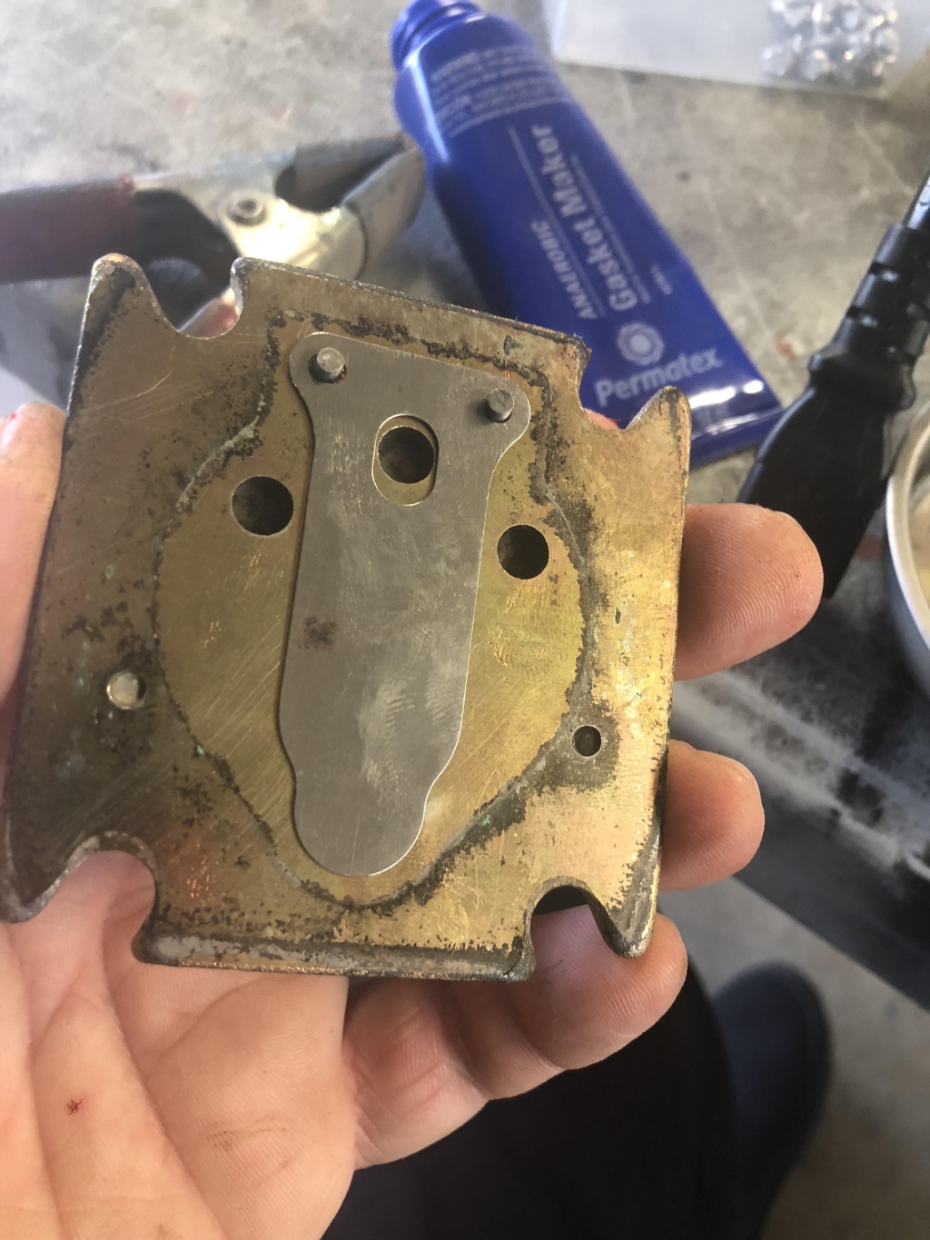

3. The low pressure cylinder. If you pull the filter off, stick your thumb on the intake hole, it should be a strong suction, not a slight. If it’s weak, that tells you that’s the problem in not building pressure. Coolant flows thru that cylinder, and the coolant is sealed off from the air side by a RTV type seal only. In my tread I linked on this post to the OP, I show that I used anaerobic sealant made by Permatex . Good stuff, stays flexible, just make sure and give it time to cure before running coolant thru the system.
