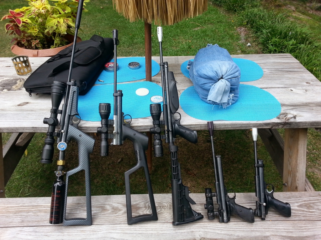

To 1300KT or NOT?? don\'t mind creating my own too. Heres my list:
Sooooo I have had many pneumatic rifles and pistols. They bring a lot of backyard fun since I'm not a hunter.
My 14 yr old is doing AirSoft and I'm being slowly pulled into the AirSoft vortex but that's not what I want to talk about.
I have been plinking my 1377 shoulder stock like crazy! And now I want to purchase one from theCrosman Custom Shop.
Here is what i'm considering..but It can change.
  • 1300KT (thats the pump action .177) with;
  • Shoulder Stock- I'll be applying some carbon fiber to it.
  • Lothar Walther 10.1" Barrel or the 14.6 LW (if they make me, but i want the 10.1" barrel). I might just get the regular barrel they offer due to being WAAAAY cheaper than the LW but i'm not sure of I can trade off the accuracy for it.
  • Triger shoe
  • Muzzle break black
  • steel breech of course
  • williams peep sight..I can always add my own scope..i have a few laying around my safe.
I'll just be plinking around the yard at targets and maybe an occasional squirrel so I can at least taste it once in my lifetime.
Any do or don't?
I fully appreciate any input. Thanks
Chichi
