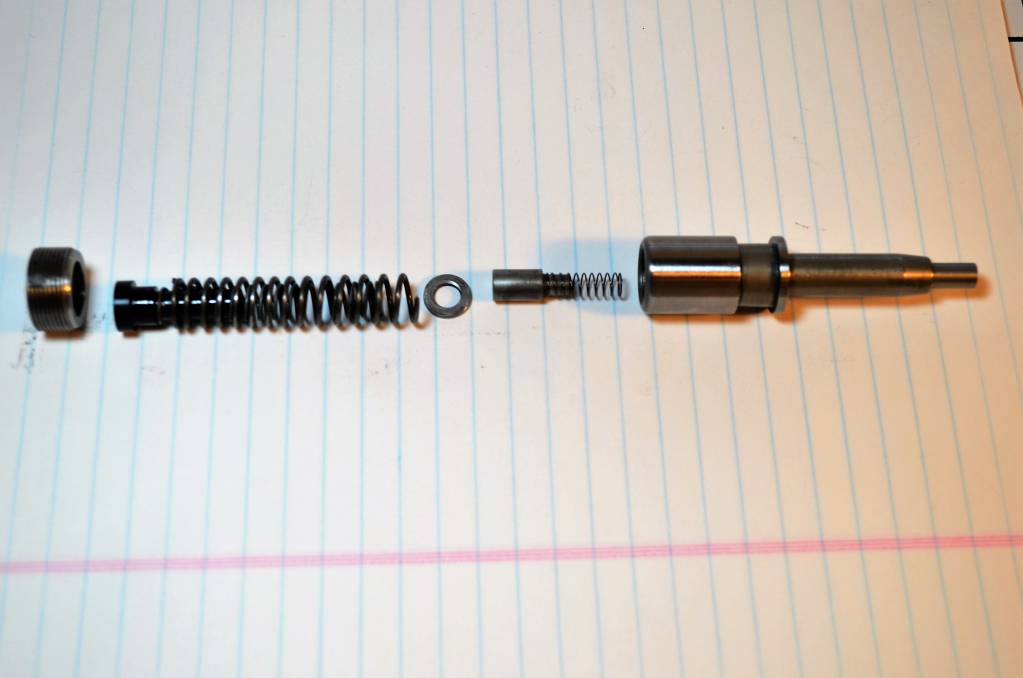

Did you assemble the hammer stack correctly?
Nation,
I do have the stack of parts shown above in the correct order. The sear spring was tightened down, possibly jammed and slightly stuck due to gunk. The coil of the spring was not working the way it should because of this. Other than replacing an oring here and there, I've had zero problems with it for the last 4-5 years. Probably have 125,000- 150,000 shots out of it wfrom it's last major overhaul.
