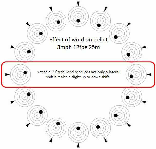

Here’s a copy of a pellet wind rose. If memory serves, I got it from one of Mike’s posts and added the annotations.

I’m not aware of any factory LH twist barrels in Airguns.
The chart Nervoustrig posted is correct for pellets in RH twist barrels.
Mike
The chart is correct IF the wind is 100% horizontal. I have had tailwind drop POI and headwind that raised POI all because of the angle of the wind in relation to the ground. Then you add incline/decline angles, landscape features like hills/valley and objects around and between you and the target.
Wind is such a crude mistress! The charts is a great start, only tip I can give is go shoot in different conditions so you can correlate your perceived environmental conditions to POI changes.
