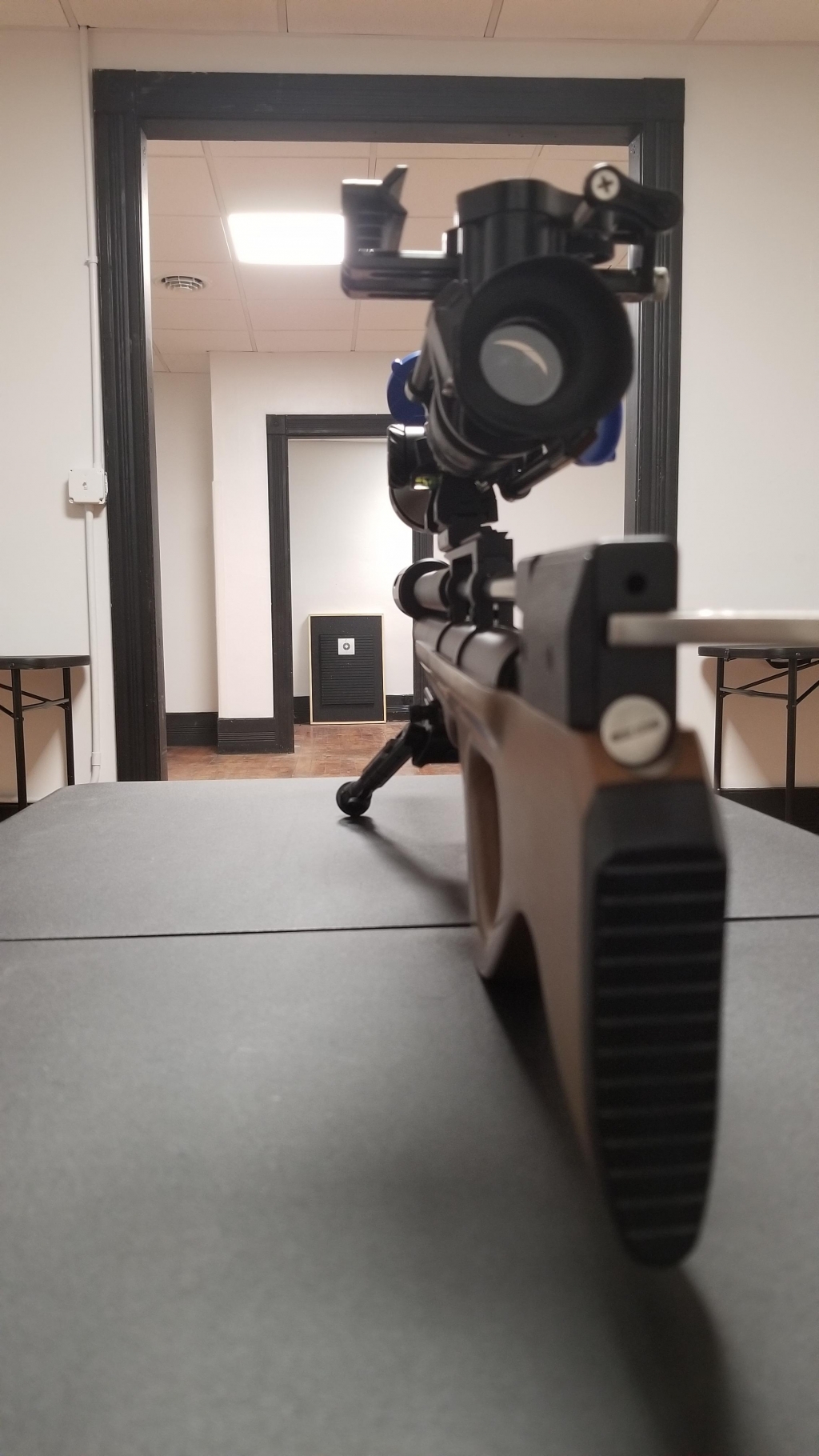

I am a ~young shooter and recently got my first PCP airgun (Taipan Vet Long .22). My current goal is to tune the gun for max precision but the more I shoot the more I notice that the most minute differences in the way I hold the gun, configure my head, allow the gun to recoil, etc. affect the POI significantly at 50 yards (3/4"-1"). This concept is not new to me, as I own and shoot various powder burners as well and am aware of the importance of consistent trigger squeeze/follow thru and rifle harmonics. However I have not noticed this level of hold sensitivity in my PB rifles. My thought is maybe some of this is due to the fact that the Taipan is a bullpup which may require techniques closer to shooting handguns which I have limited experience with.
Anyway, in an effort to reduce my influence as the shooter to more accurately observe what the rifle is capable of, I am hoping some of you could share tips for how you shoot bullpup PCPs off a rest. Note that I am shooting prone off a bipod and rear bag.

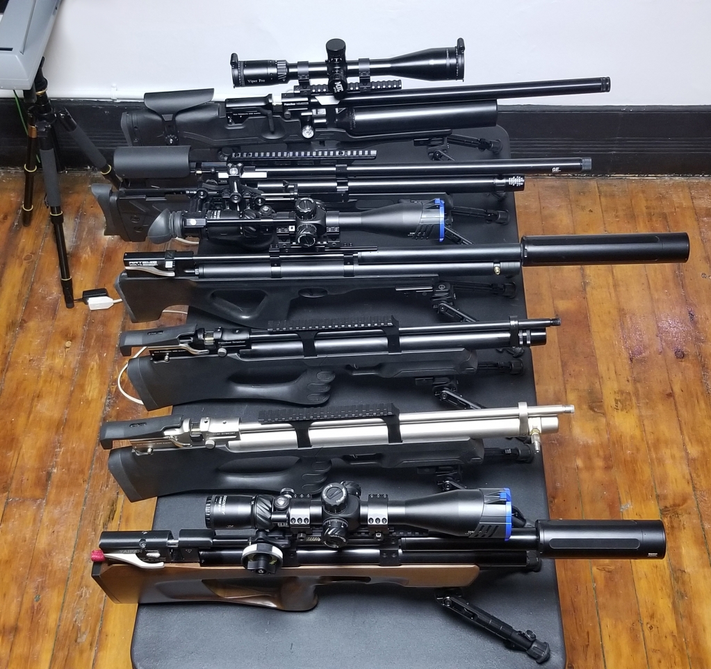

I pretty much Exclusively shoot bullpups, and every one that I have gets a kickstand..
Bipods definitely work like a charm on them. When inside, I use my 10 meter range..

^^^ A few of my pups with bipods:

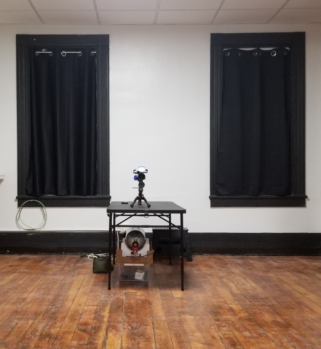

^^^ My simplistic indoor setup:
*Lightweight folding-table @ 6'Lx2.5W', 2.5' tall
*Collapsing stool @ 1' tall
