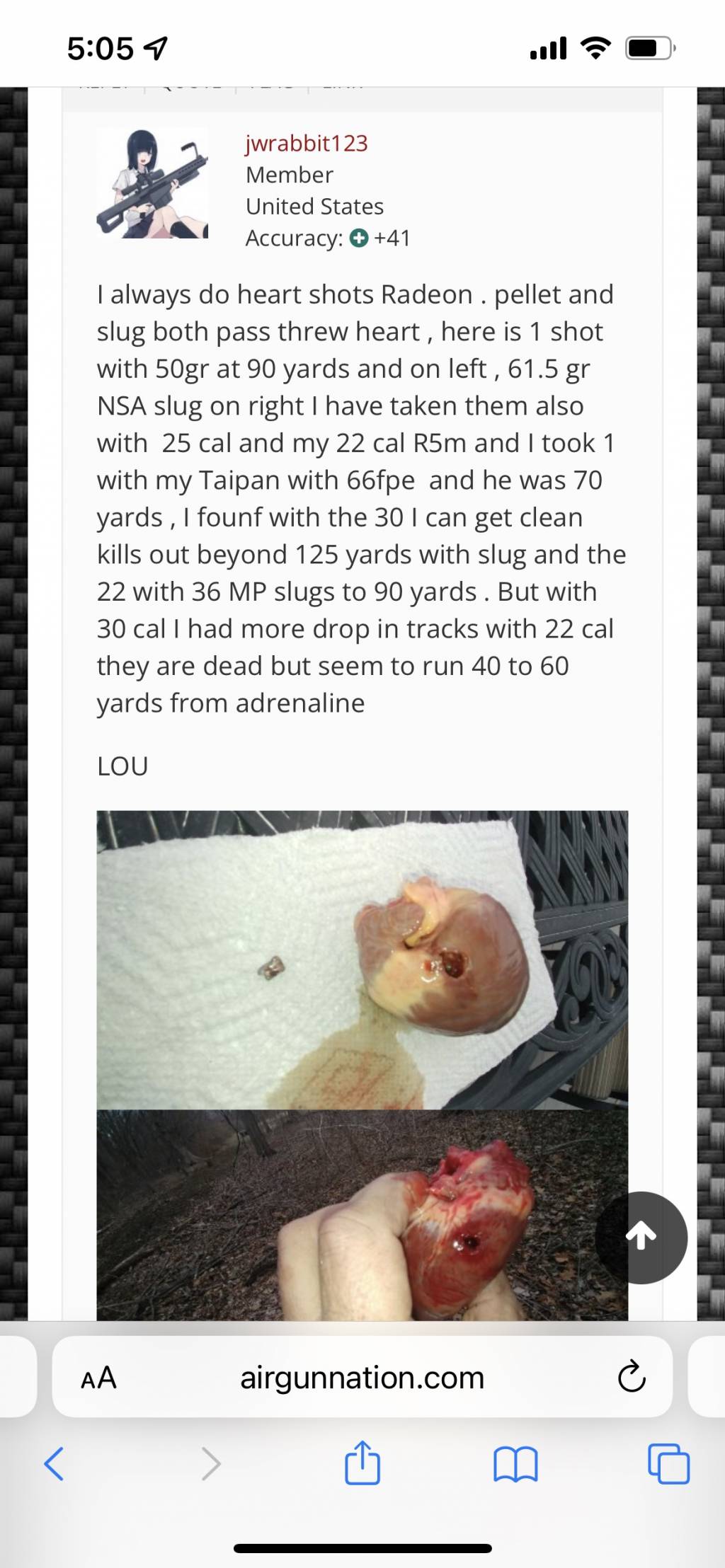

Here’s one post that I remember:

Seems light to me but placement is more important than fpe. With enough penetration a bigger hole is better but penetration goes down for a given fpe with a larger caliber. Expansion reduces penetration quickly. My 32 fpe 25 has about the same penetration in wet paper as my 16 fpe 22 if the 25 is using a slug that expands a little (27 grain NSA). With a domed pellet like the 22 is using it penetrates twice as far. With marginal power understanding what your projectile will do also becomes more important IMHO. I would worry about hitting a large bone, like the shoulder, on a coyote with a 70 fpe 30 or a 50 fpe 25. Hit behind the shoulder and it should easily go through the lungs and possibly heart. Hit the shoulder and maybe it doesn't get there. But it's clear it can work.
Another way to look at it is squirrels with 12 fpe. I've seen tons of videos of Brits nailing squirrels off a bird feeder with a 12 fpe air rifle. Almost all brain shots, however, and occasionally it takes more than one. I increased the power on my Prod after having a couple run off with body shots with 13-14 fpe. Head shots worked great but not body shots. I am pretty sure they died but I don't like them running off. That's the kind of thing I worry about with less than big bore PCPs on coyotes. Could get a clean kill and could have one run far enough you can't find it.
