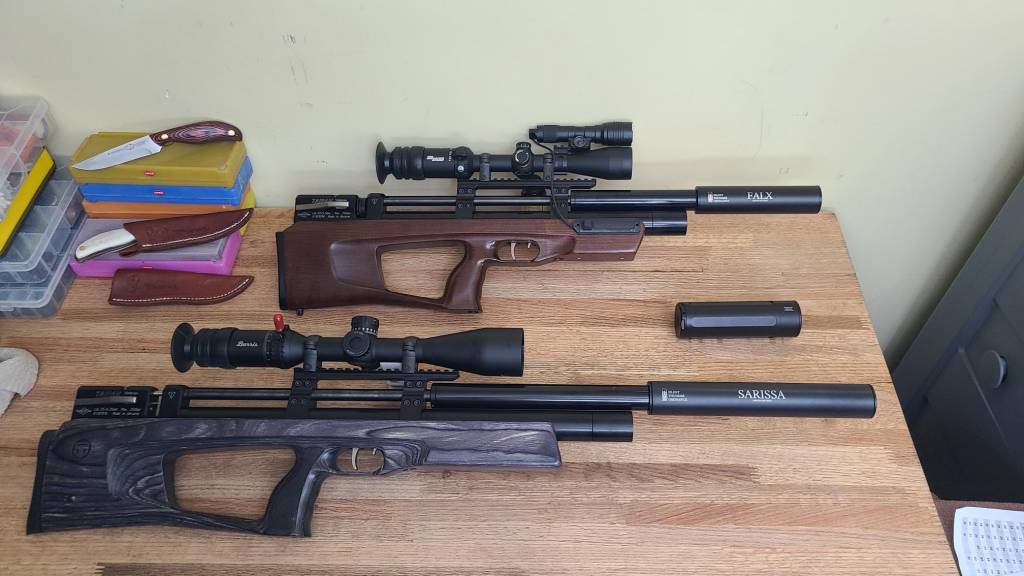

The quest for the silent moderator is over....STO Falx on my .22 short and a Sarissa on the .25 Standard. All i can say is wow....these things are amazing, went with the moderate flow version. These will be replacing the DonnyFL Sumo and Ronin, really good moderators but the STOs lower the higher pitch considerably which makes for a much stealthy shooter. ....Griffin Ammo is the Best....BT/HPs fly straight and hit hard. Now waiting on a Slug Barrel from AirGunHeaven.NL....damn things been in customs for weeks....

the .25 - shooting BT/HPs in 48gr. have the LDC BT's on order in 42 - 44 and 48gr just to see how it likes them - the LDC's have a plastic ball bead in them to reduce weight and promote expansion upon impact. Waiting on the AirGunHeaven.NL barrel to do any tuning on this one.
the .22 - LDC BT/HP in 32 - 36 and 38gr - the CZ barrel (choked) likes the .38s
Both guns, just did the RW mods few days ago and moderators are new - My Crony is broke - waiting on a new one to get here so haven't done any tuning yet.
All i can say, is maybe not made nor tuned for my Taipan and i admittedly did guess to some degree in buying the moderate tune versions but - zero regrets - quality products and work great so got lucky, maybe but STO is a well engineered product that should work on any airgun. I've have and have tried a few different DonnyFL - Weihrauch - Huggett and a few DIY's and so far, have found the STO to be by far the best.

Is there any benefit to getting the moderate flow over the standard? And how do you know what caliber you can use with them? I didn't see that info on the website. I'm interested in the Falx model to use in .22 and .25.

There are several linked pages on the STO site. I believe one of them had to do with how to calculate the flow rate of your particular rifle. There's some math involved. And the owner was more than helpful when I emailed him questions.

I emailed them with that exact caliber question yesterday and got a quick response.
"Our moderators are not as bore specific as other brands, we don't try to make the bores as tight as possible for performance gains since our diode technology is so much more effective than tighter bores and extremely tight bores often just leads to clipping and other problems. Our Standard Flow cores are designed for 0.22 and under and our Moderate and High Flow cores are designed for 0.30 and under.

Thanks. That's the exact info I was looking for.
