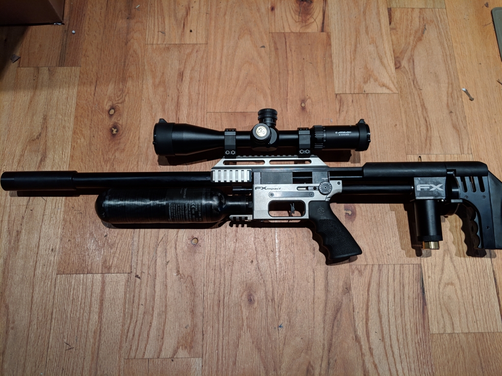

Thumper is back. 100fpe Impact
I've missed my old friend, Thumper. Always liked this rifle, she developed a leak last October and I was reluctant to ship to Ernest, I hate shipping gunz. Anyway, finally did and just got it back today.

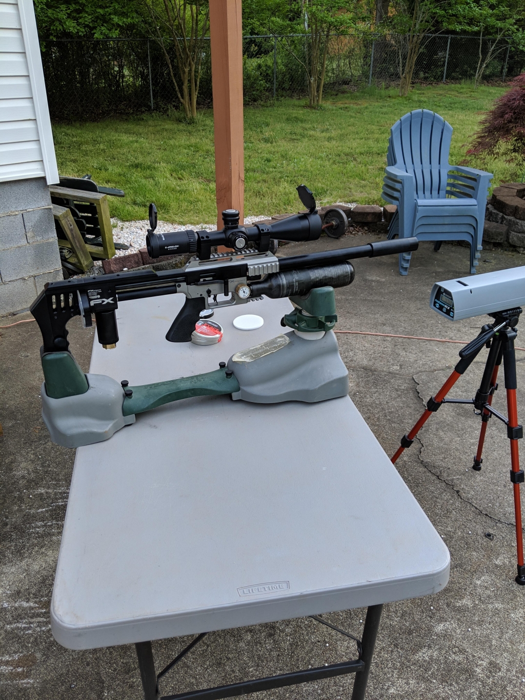

Eager to test it I quick like mounted a Helos scope on some Vortex precision match rings and setup on the table for it's trial run.
Some 50.15gr pellets loaded in the side shot and let her off the chain. First pellet out of the gate: 948fps!!! That's just breaking the 100fpe mark.
Dialed the scope in at 25yds, 50yds and 75yds. It's one ragged hole at 75 when I do my part.
Yes, I'm happy.
Now I just need to find a 600mm barrel...

I had some Wiki gauges and got Ernest to put them on too. He's got the reg set just south of 140bar.
1 full sideshot mag from 250bar at max power before it falls off the reg. That's 23 .30 cal pellets for those of you not familiar with sideshot mags. I used to get 2 mags, but that was down in the 820-830fps range.
