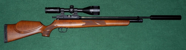

my .22 concept and contour both have a 10mm x 1 thread. DonnyFL will make an adapter for you if you need or, Neil Clague made a real nice moderator for mine.
