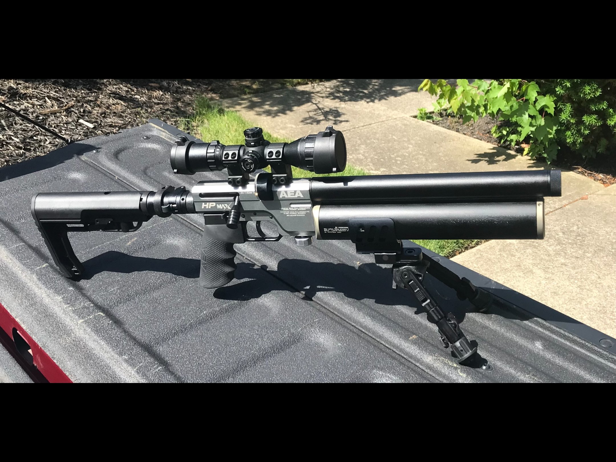

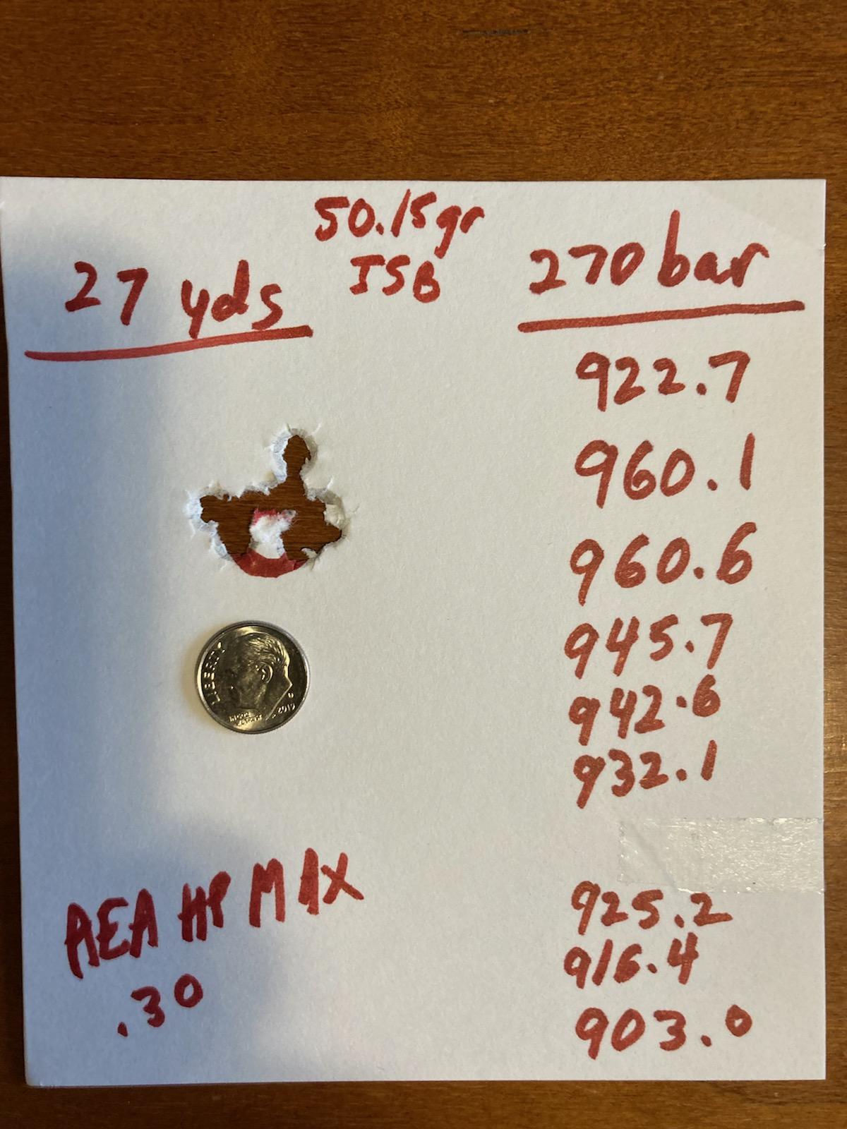

I have the same gun. Aea hp .max 30. It is a $600 80 fpe thumper of a truck gun. A stone cold killing machine. Fill to 3600 psi, jsb 44.7 @ 930 Ave. This target @ 55 yds 2 magazines. A little trigger work and this bad boy rock . Want more power just fill to 3900 psi and sling the 50.1 jsb's.yes, it is very loud.

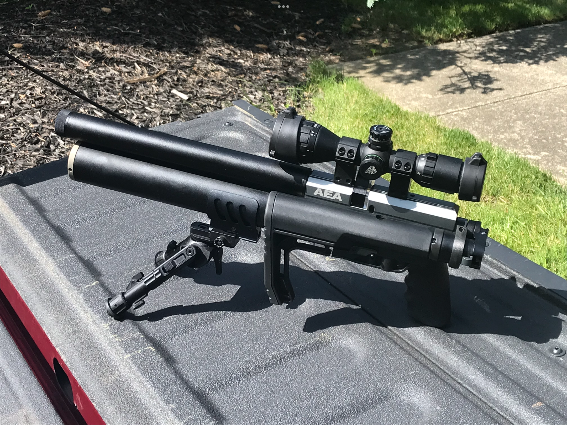

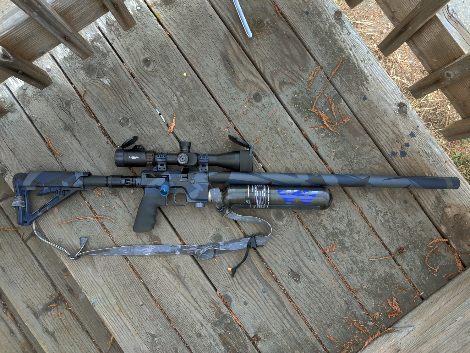

I love my .25cal HP Varmint. The trigger is pretty rough out of the box, but it was easy enough to fix it up a bit. Now it breaks in the high 2's, and I put in an overtravel stop to limit extra motion on the gun. It's an absolute laser beam with H&N 36gr slugs and delivers about 66fpe.
I did a valve spring mod as suggested by another poster on here and that brought the energy up to 86fp. I'm not going to keep that for everyday use, however, because it hurt the accuracy a bit and also messed up the shot velocity consistency.

I've heard similar reports of damaged screws. The other thing I find odd is I've never seen a "refurb" listed for sale. I bought my AEA HP Carbine .25 used and it had been upgraded with a DonnyFL and the CF bottle. The only problem I've ever had was the poppet broke and I made a new one out of PEEK. I did try swapping out the trigger springs, which resulted in some double fires so I put the original springs back in the trigger group.
