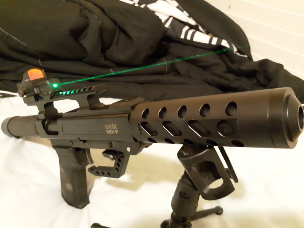

I bought a Pinty green laser 2 years ago and it is mounted to a scoped AF Texan LSS 257, it still works, so I recently ordered 2 more.
Although I would hesitate using a laser as a primary sight, due to my declining visual abilities, I have paired them with 3 power magnifiers with great results.

I put a $20.00 laser sight on the Benjamin SAM a couple of weeks ago as an experiment, and it was amazing at zeroing the previously installed ADE RD3-002 Red Dot Sight with Weaver-Picatinny Mount reflex sight with it. Like @Roachcreek said, they work great for zeroing. And as @esingle said, the laser does hit dead on at the zero point, but it also does track differently if it is offset to the horizontal line of the bore.
