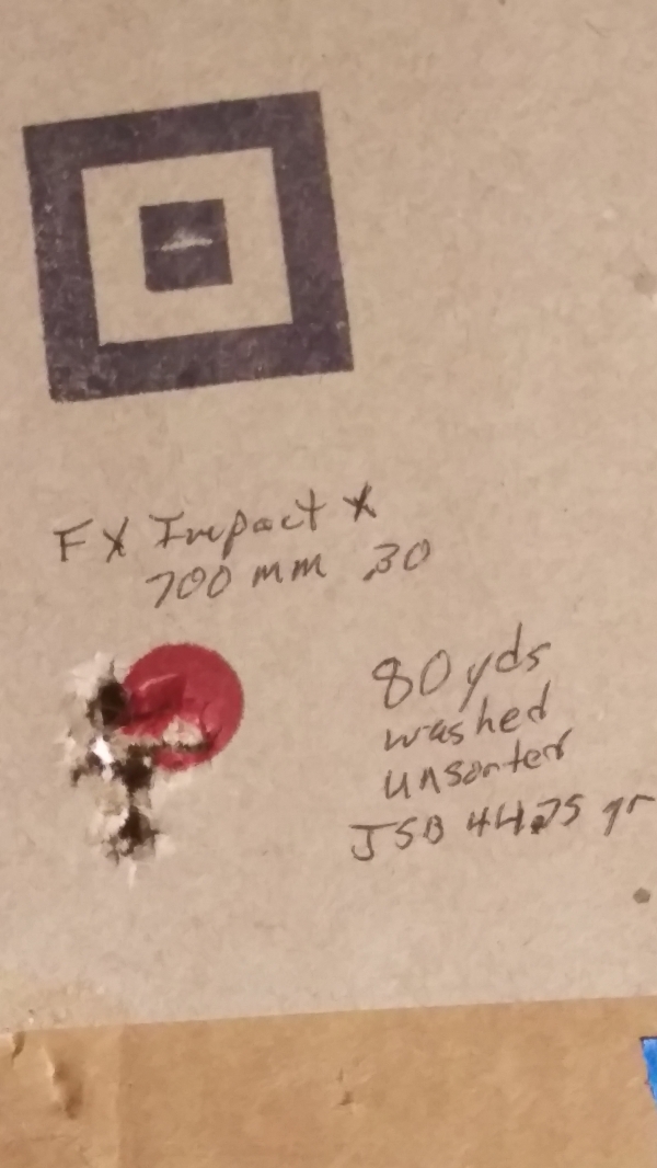

No wind,80 yards,5 shots
Next day, a steady breeze blew off aiming dot 2&3/4 inches to the right. 5 shots.

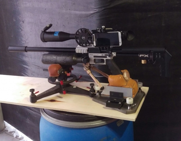

To get those groups, I used a very solid shooting platform of a 5 gallon barrel full of dirt, Ransom front rest and home made rear rest. Bags filled with very heavy Zircon sand, fully adjustable for elevation and windage. Add many decades of competition shooting in nearly all rifle and pistol avenues as well as many friends I have gained and sharing their tips :) :) When you can see your heart beat move the cross hairs,you are not locked in solid enuf.

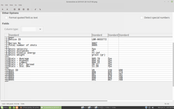

The Edgun gauge is saying 139 to 141 BAR average between shots. 894 was the highest I saw on the Labradar. The first shot was low, not sure why as the BAR at that shot was 148. Thinking the hammer strike can not totally release the higher BAR. The regulator creeps up several BARs after a few hours of sitting, almost always. That first shot is always a couple inches low at 123 yards.....time for a Huma regulator? Impact .30 regulator is stock and serial # 184039.
