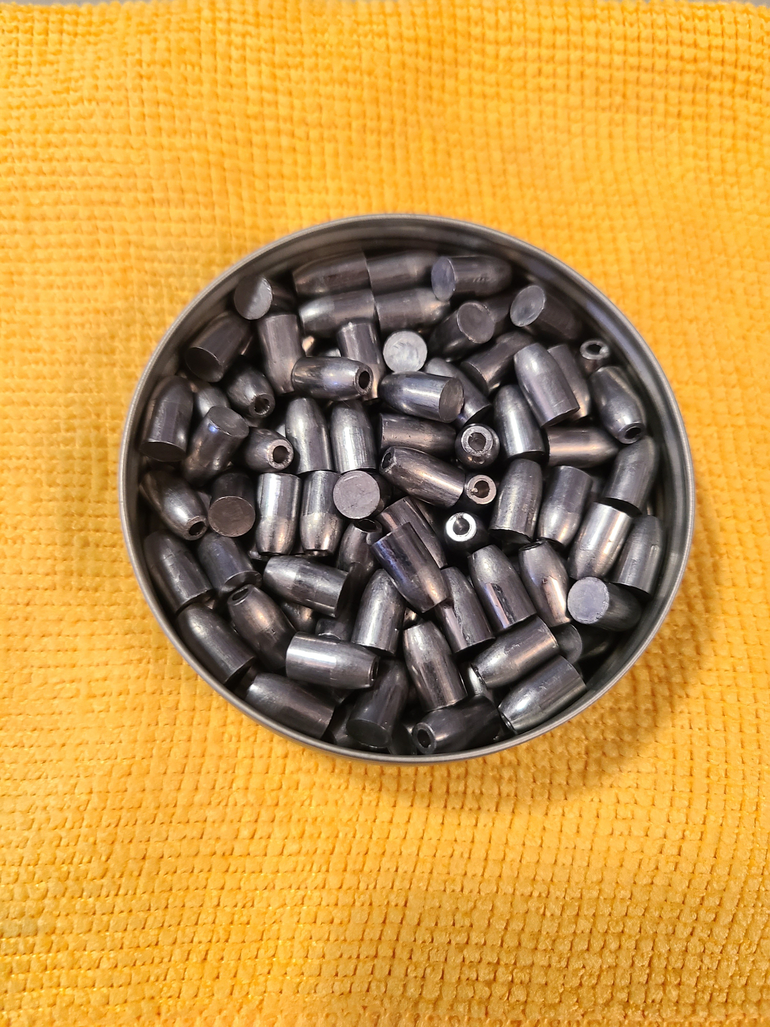

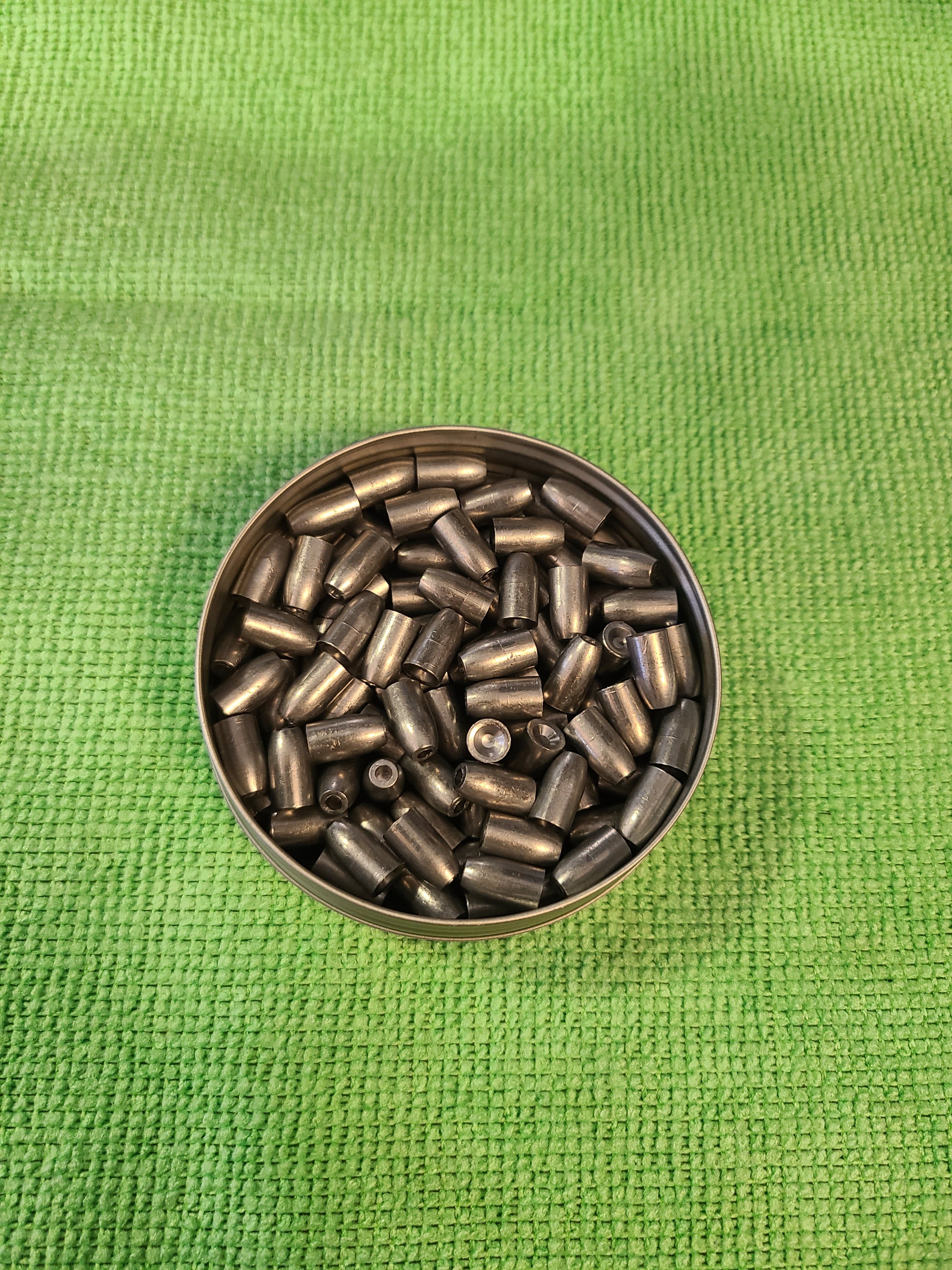

After my 1st run I decided to make some changes. Groups were just OK. Nothing to write home about. I switched over to the flat bases. The dished base runs pretty deep @ .042 and I'm running a pin / slug probe, so I think it's not seating them deep enough in the chamber. If your running the standard FX probe, this won't be an issue. I also ran them through a resizer and they came out @ .02178. With them coming out the die @ .02186, it's knocking off about 18 fps. So I'll try this last batch later today and go from there. I'm new to making slugs so I expect it to take some time to dial everything in. Also, if anyone cares, the depth of the hollow point is 4mm deep
