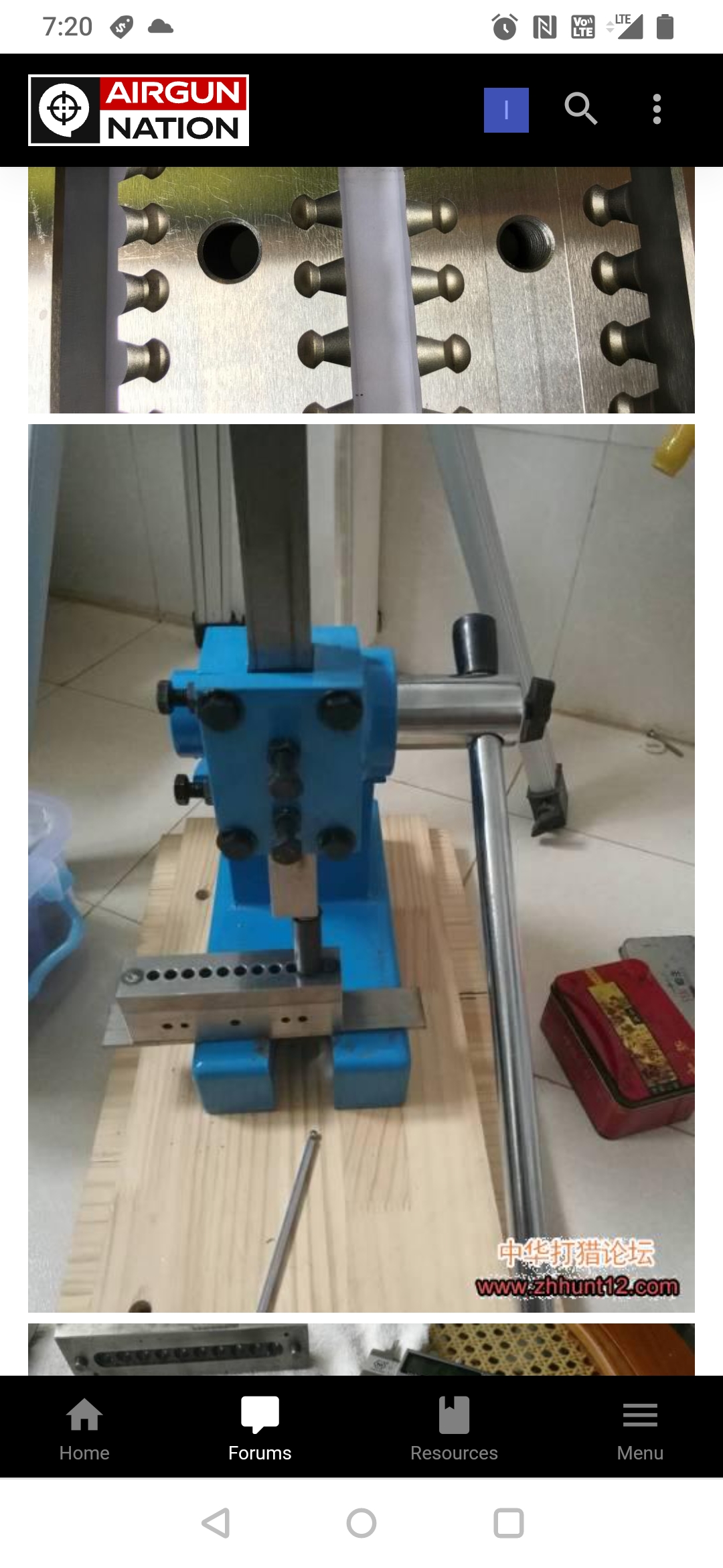

Here's a pic from an old post, arbor press?

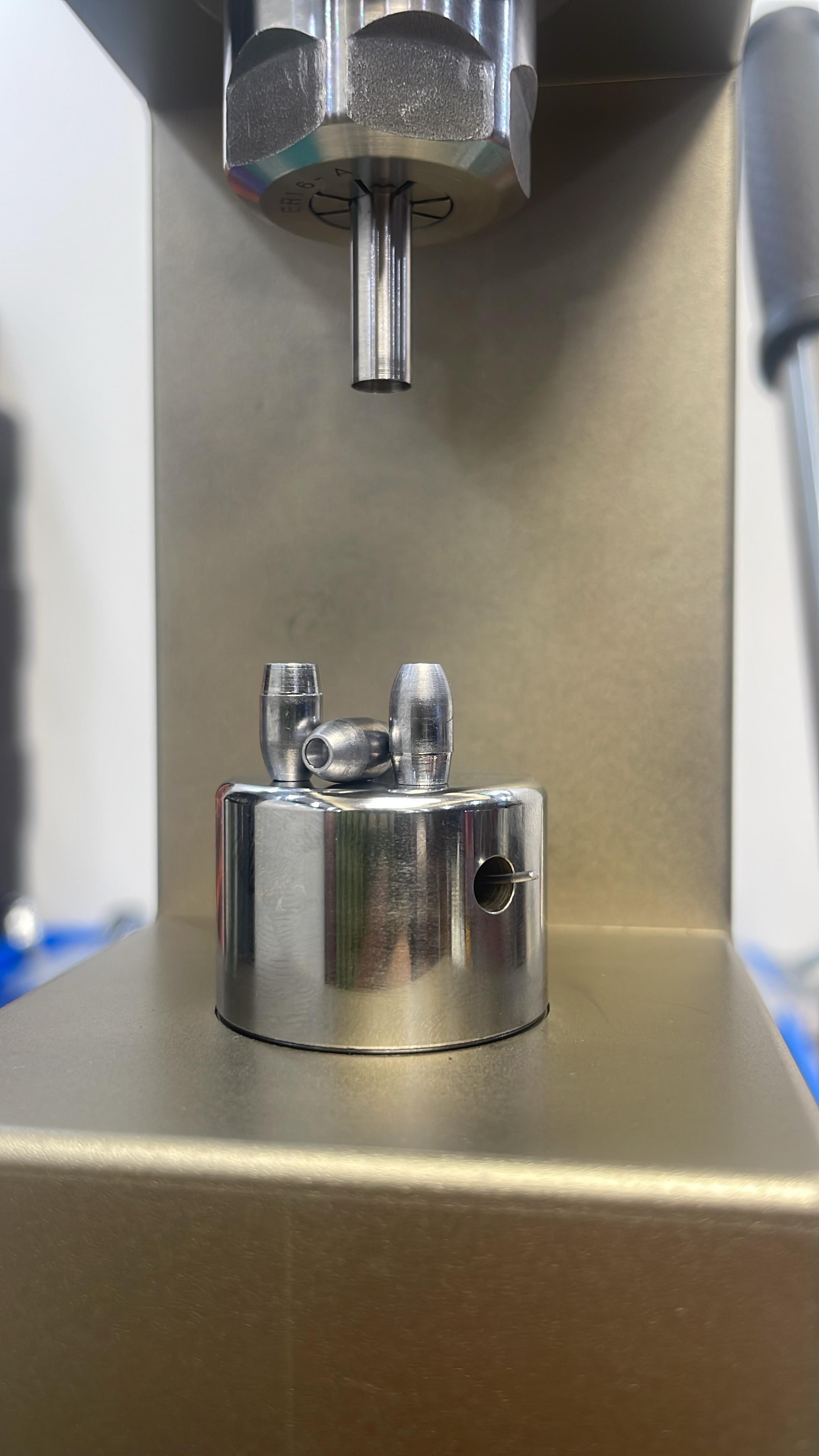

I’ve worn out and replaced the parting face dowel pins already. I think they were 304ss and wore quickly. I lapped the parting face to reduce flashing and will probably lap it some more. The good news is that the main die halves do seem to be pretty well made.
I’m drawing up a different design and working with a local machine shop to get an idea of cost and machining accuracy (no idea if this can be done both accurately and affordably). A friend of mine really wants a swaging die and so this will be based on his preferences. Since best cost country machined parts are often 5x cheaper than domestic it simply may never work.
The 13.6gr pellet design is excellent at short range accuracy but so-so at 40 and 50y. It could be me introducing imperfections that make them unstable, my rifles, or it could be that the pellet design simply isn’t all that stable. So I might try a different finishing punch that drives deeper and improves the weight balance. I might also deploy a custom design I’ve worked up in the 12.x grain range.

It's not super clear from the photos I posted, but the photo of Rod scraping the top of the die is removing swarf lead that is squeezed out at the the skirt end of the pellets. When you press the core with the punch, the excess lead squeezes out around the punch like a raised donut. Then you scrape those off with a razor scraper blade.
The tiny bit of flashing I'm seeing now is much less that those photos showed. I'm hoping I can get the die faces even flatter to eliminate flashing completely.
