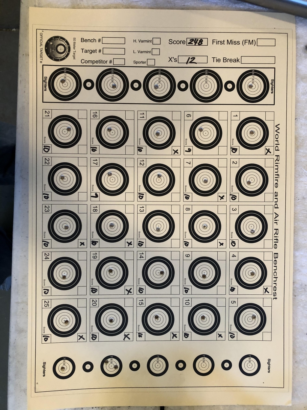

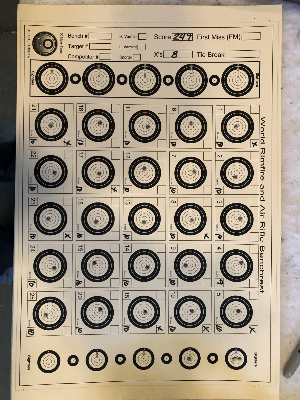

3 card series in testing this morning at 50y.
Wind was 3-6mph....pretty nice. Almost all shots were adjusted for and taken only by flag position. I really enjoyed that. Not too many sighters. 745 32x. This trounces the set I shot a few days ago, but this was just practice/testing. It does make me believe that a 750 in match conditions can happen if the wind isn’t too bad, though.
Mike
