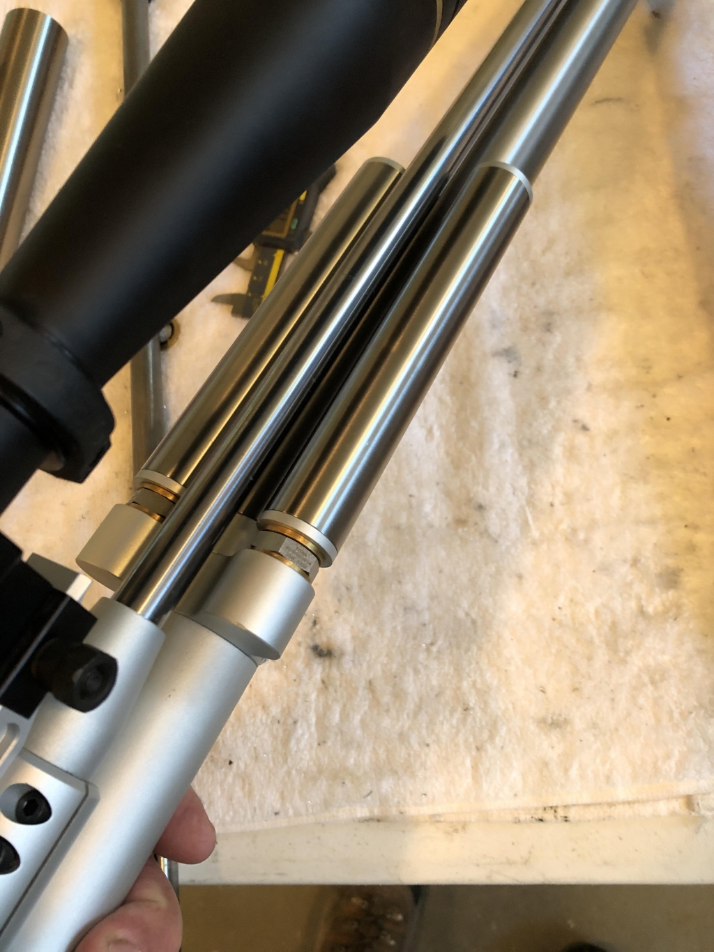

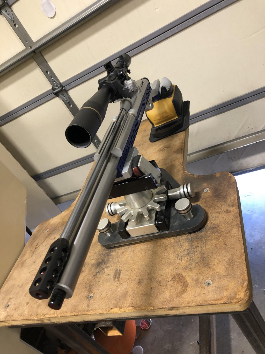

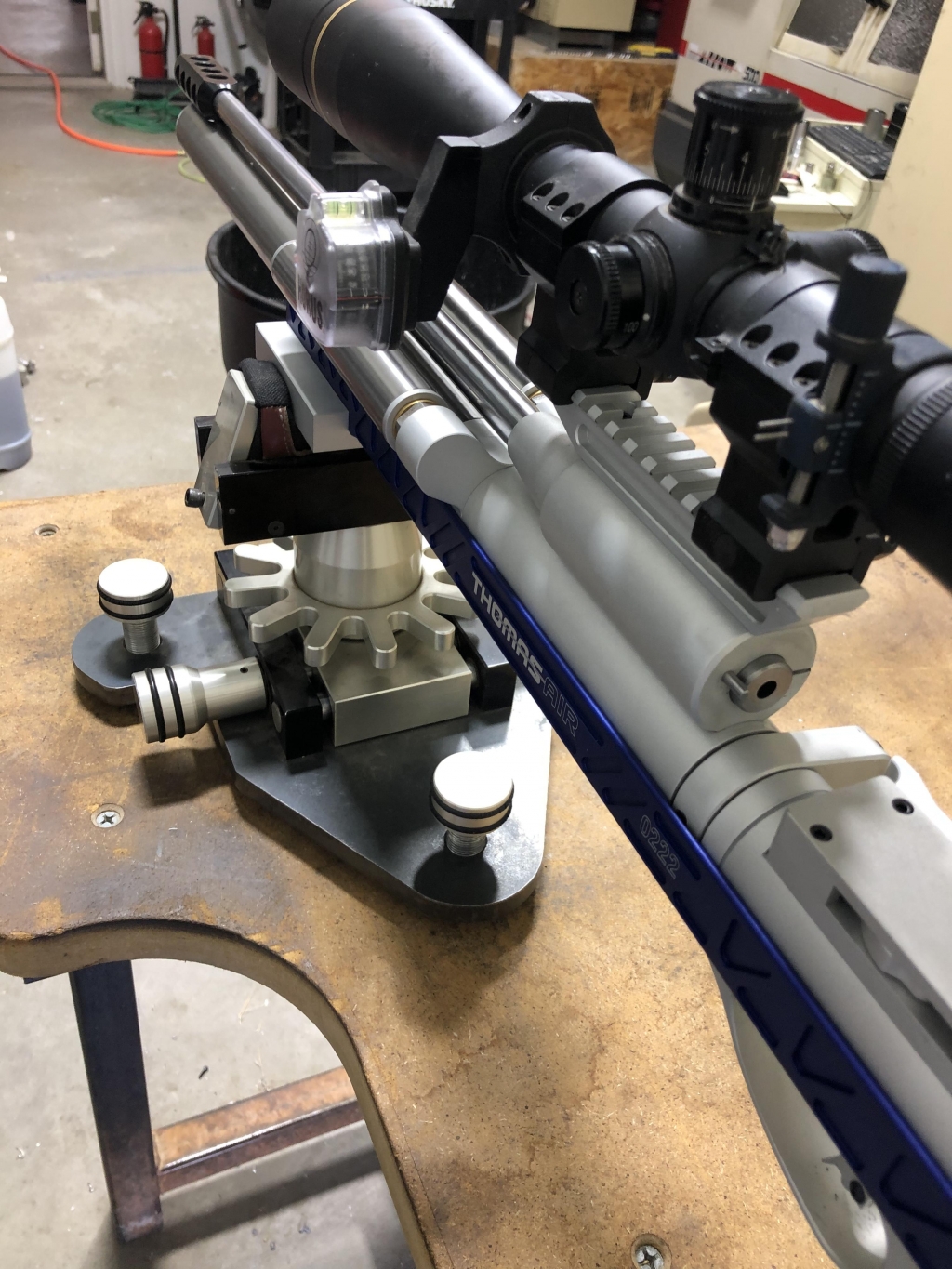

It’s been clear that my gun could use some more plenum volume do the higher power stuff. The first iteration was just a longer valve block...but this obviously made the gun longer. The second version had an single external tube that went under the main tube. That required cutting a pocket out of the bottom of the stock so I could drop the plenum through when installing the action. I really didn’t like that idea because I wanted to be able to use this in a FT stock in case someone wanted to use a bipod for the 100y stuff.
Take 3....I designed 1” titanium dual plenum boosters and a yoke that positions them up alongside the barrel. This will fit in any stock, and can be fitted onto existing 25m guns. This also gave the gun a less flippy recoil pulse since the extra weight was in line with the pellet travel along the barrel.
With plenty of regulated volume on tap, now...power is much easier to come by and efficiency climbed as well.
