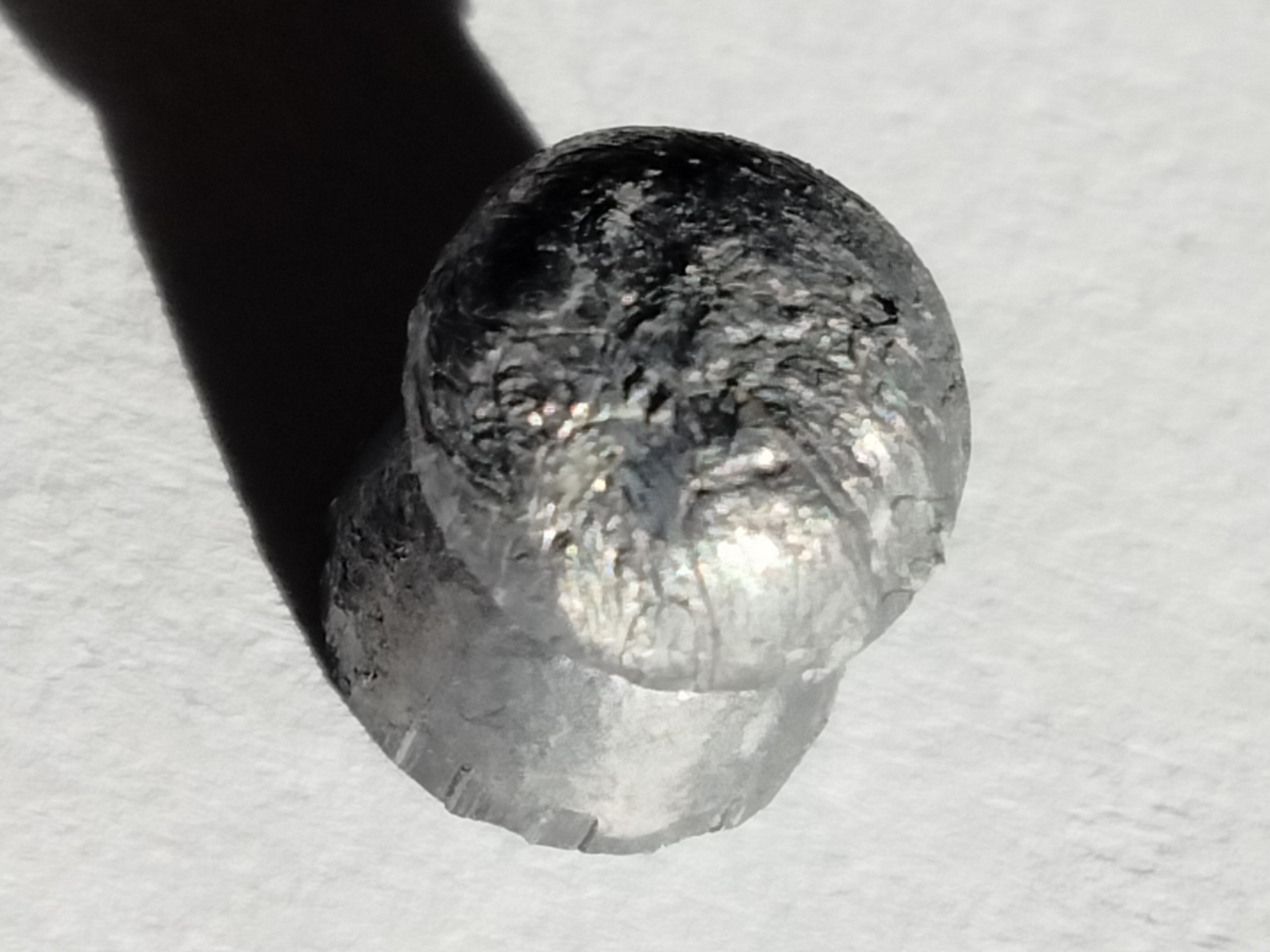

Could have cost me my life the other day. Had a Vectis that was jammed due to me forgetting to tighten the hammer spring set screw. Finally got that fixed and ran a dowel rod thru my barrel; pushed out three pellets. Wow. So seeing the barrel was cleared I fired into the carpet inside the house. I failed to realize my dowel rod didn't go all the way through and this guy shot out, ricocheted 3-4 times and came to land on the work table next to me. Dang! My head/body could have been in that trajectory somewhere. There is a God. Thank you oh Lord for keeping me safe. A great reminder to never assume your barrel is clear and to fire them outside or in a safety barrel when possible. Keeping this as a good reminder for the future.
