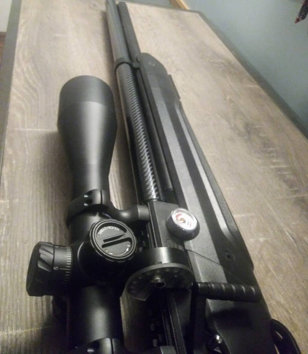

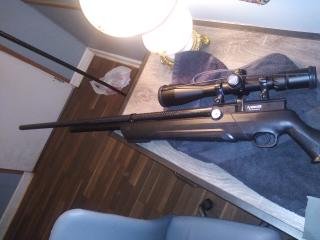

No but I just replaced the avenger shroud with a carbon fiber tube and the fit is perfectooo. Half the weight and super stiff. I have already heard of people denting or bending their avenger shrouds so i figured I would nip that real quick.
I just measured the stock shroud and ordered cf tube off ebay. It was 25mm OD 23mm ID. I had to cut for length and drill 1 hole to hold by the block and it fits perfect. It was like $28 for 1000mm tube
