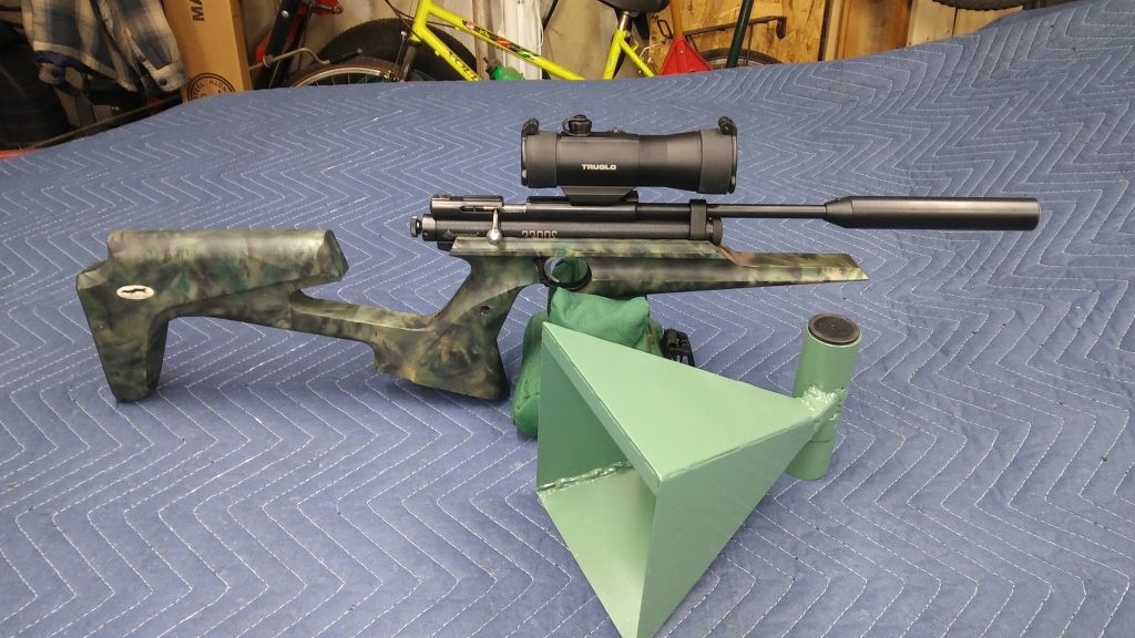

Well a while ago I built my daughter a 1322 carbine pumper, came out way better than I expected. And I wanted a similar gun for myself. I decided on a Crosman 2300s. After reworking an awful trigger, Rotating the barrel so the transfer port lined up with the port in the Lothar barrel. ( gotta love quality control ). Adding a 2x red dot sight, different stock from Tom West that was suppose to fit, but WAS NOT even close. And my own design 3 chamber LDC. I have something that is kinda cool looking and fun to shoot. And I am amazed the accuracy of the short 10' barrel. But now I need a nicer looking target, kind of to match the gun. I have a big x-ring centrifugal and thought it would be neat to have a small one. So here I go again cutting and welding. Trap is 6" x 6" x 9" or so, OAL of the gun is 24" tip of LDC to shoulder pad.
Now it's like I said.................this is way to much fun.
