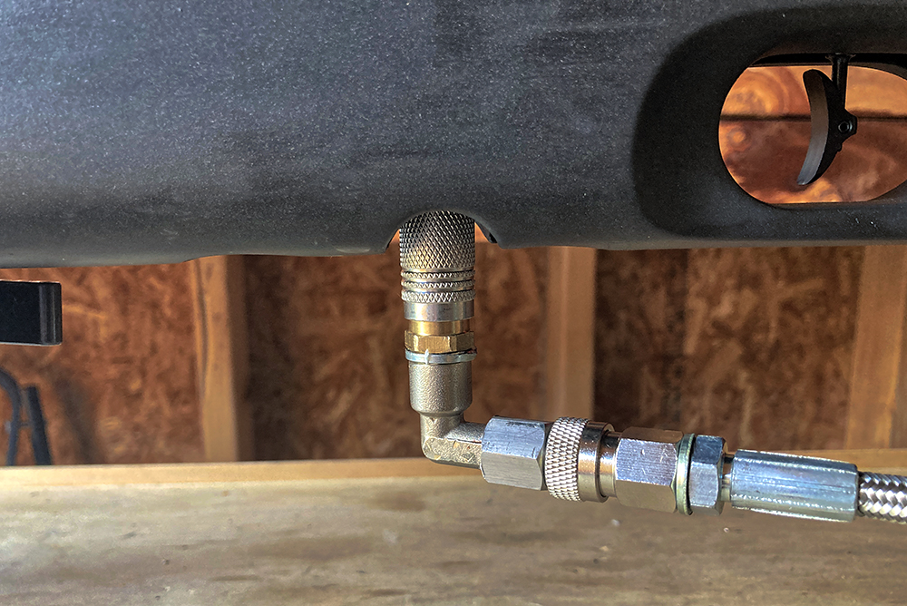

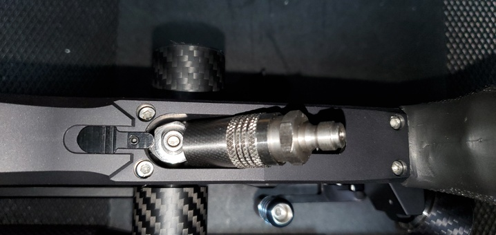

For the record, I have about a dozen female quick connect fittings and NONE of them fit the FX M3 I have been borrowing, because the opening is too small in that removable trigger guard piece for all of them. The nicely made female connector that came with the FX fits the gun perfectly but interestingly doesn't fit about half of the 9 pcp guns I have on hand at the moment. but it doesn't fit the threads of ANY of my whips as the thread size is different. I had to modify the extended female connector I had on hand, like what is shown in the photo below from Ca_Varminter's post, to fill the FX gun.
When I was first learning to fill PCP guns not too many months ago, I had the whip pop off a gun that had easy access to the male connector, because I had not properly latched it on there. Fortunately this happened at fairly low pressure. I have since made it a habit to push and pull firmly on the connector once connected, and I push the sliding collar down when connecting to the gun, not just relying on the spring tension of the collar. I also finally inspect the sliding collar to make sure it is in the fully extended position before I turn on the pressure.

You need a slim foster to fit in there. FX includes these, maybe you didn't get one. They come in all shapes and sizes, so no they don't make it big enough to fit every brand of foster fitting (which is why they include one) but again sounds like you didn't get one. You say you lived with this happening for 2 years? Why?
Yes, I got one with my new FX about 2 months ago but it’s still not very long and a little difficult to get ahold of when removing it from the male fitting. I ordered a new one from PA that’s much longer and should work great.

That's the first time I've seen that an extended one needed to be turned down to fit. The OP says the opening in the crown is 17.5mm, the fx one is 16, and an off the shelf extended one is 16 and change OD. So if you want to qualify it being "proprietary in the case of the M3" I guess I couldn't argue that. Both the above fosters fit the MK2 and Royale (similar to crown) perfectly.

The foster on my joebroncato fill valve works perfectly, the cheap foster on my yong Heng fits perfectly, the foster that came with the gun fits perfectly, I’m seeing a pattern here. We’re all arguing that some fit and some don’t. This doesn’t make the fitting proprietary, just as the evol fitting is not proprietary. Some companies make better quality fittings, that are slimmer due to higher quality materials. IMO, I’d rather use high quality fittings, than cheap junk that might give out even if it’s properly connected.
1. It sure would be nice if Foster males and females could be standardized similar to mil std picatinny where the dimensions and tolerances and materials are set in stone. In the market place there are female fosters made of stainless steel and some made of brass. I can see brass sleeves possibly needing to be thicker even though they aren’t wetted with HPA. In any case, the designer for that manufacturer sets the size which FX would have no way of knowing ALL the sizes on the market. To me, enlarging the Crown access hole in the stock would be pretty simple to possibly assure universal fitment of fittings.
2. Or simply mark your Crown foster with paint or a short section of heat shrink tube so you know. But if you lend the gun out, they’ll need that fitting. I keep the Donny FL extended fitting in my Crown case so I always have gun and female foster together.
3. ALWAYS assure the sleeve is always in the locked position. HPA is nothing to fool with, despite the tiny line size and flow rates. When it lets loose, it can be very ugly.

I have a FX Crown and I have noticed some fill whips disengage violently during an air bottle refill. (very exciting). I kept blaming the Foster fitting, but that was not the fault. It is the stock that interferes with the outer shell of the female Foster fitting on the fill whip from completely closing. It is not possible to see why this is happening because the fill fitting is recessed. After complete disassembly so I could measure all the dimensions, I discovered the milled slot in the stock has a width of 17.5 mm. Female foster fittings larger than 17mm will interfere with that slot and not properly latch. Please note that these Foster fittings rarely state their dimensions. I have 8 different fill whips and only 2 are 17mm. All the rest are 19 mm and interfere. I do not know how many other guns have this issue, but certainly the FX Crown does. Beware! I have contacted FX Customer Support, about this.
