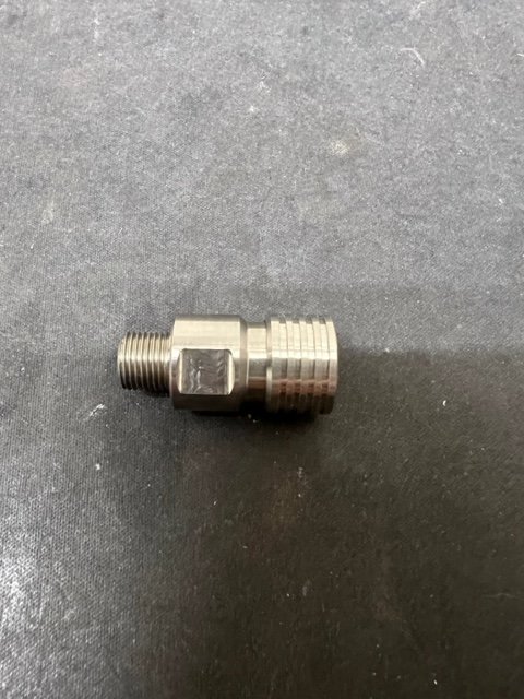

I have a FX Crown and I have noticed some fill whips disengage violently during an air bottle refill. (very exciting). I kept blaming the Foster fitting, but that was not the fault. It is the stock that interferes with the outer shell of the female Foster fitting on the fill whip from completely closing. It is not possible to see why this is happening because the fill fitting is recessed. After complete disassembly so I could measure all the dimensions, I discovered the milled slot in the stock has a width of 17.5 mm. Female foster fittings larger than 17mm will interfere with that slot and not properly latch. Please note that these Foster fittings rarely state their dimensions. I have 8 different fill whips and only 2 are 17mm. All the rest are 19 mm and interfere. I do not know how many other guns have this issue, but certainly the FX Crown does. Beware! I have contacted FX Customer Support, about this.

The problem is that female Foster fittings are generally not advertised with their size. Currently there are many out there for sale that are larger than 17mm in OD and they will interfere with the FX Crown stocks and do NOT fully lock. Perhaps also other models as well. This is new and it IS dangerous.

You may also note that this milled slot in the stock does not provide adequate side clearance to allow a deep well 14mm socket wrench for the male fitting on the gun. Forcing a rather complete disassembly of the rifle to remove that fitting for service. The solution for both issues is a larger slot size.

I am glad you stated "Typically" because I did not get one nor did anyone that I know get one. Further if this issue was already so well known, perhaps you could reference a previous alert or article identifying this problem. I obviously was not aware of this and I am generally pretty well informed. That is why I posted the alert. I only had to mill 1.2 mm all around the slot for adequate clearance. This change seems to me to be an infinitely easier solution. So why did this not happen before?

You need a slim foster to fit in there. FX includes these, maybe you didn't get one. They come in all shapes and sizes, so no they don't make it big enough to fit every brand of foster fitting (which is why they include one) but again sounds like you didn't get one. You say you lived with this happening for 2 years? Why?

Good question. I guess because I did not want to rezero the perfect reliable rifle that took me a long time to achieve. I was too lazy! Opening up that slot without damaging the finish was tricky and time consuming as well and I have a milling machine.
