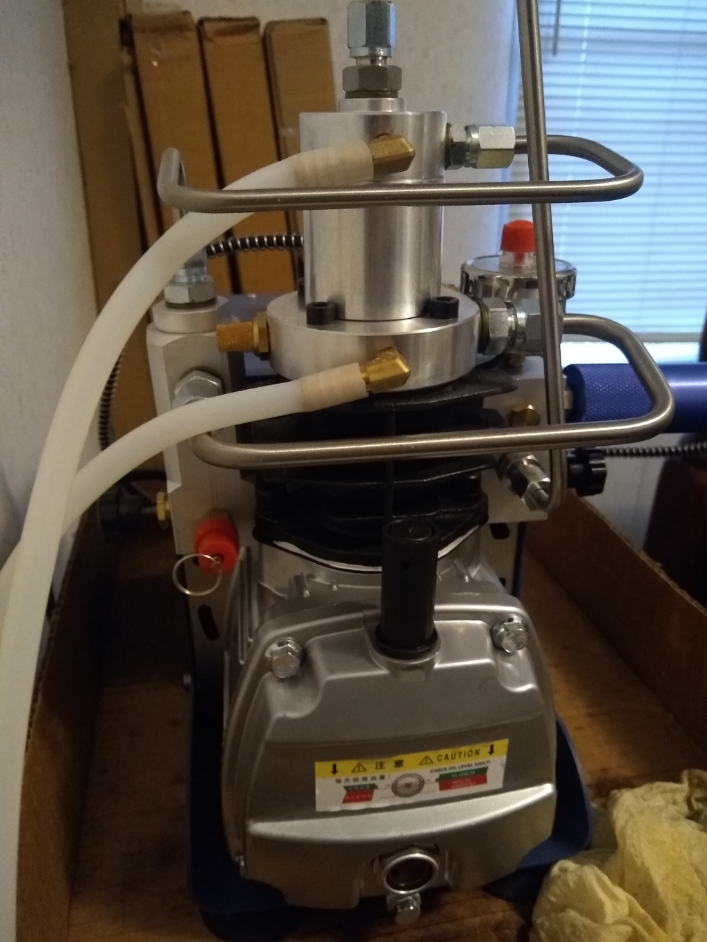

Just got this in from Amazon. I looked at the youtube videos and this one is different. It's missing one stainless tube and a relief valve. Can owners chime in? Thanks.
That looks like the model that Yong Heng calls the "simple version". It doesn't have the oil/water separator between the first and second stages. The three higher priced models have the extra separator.

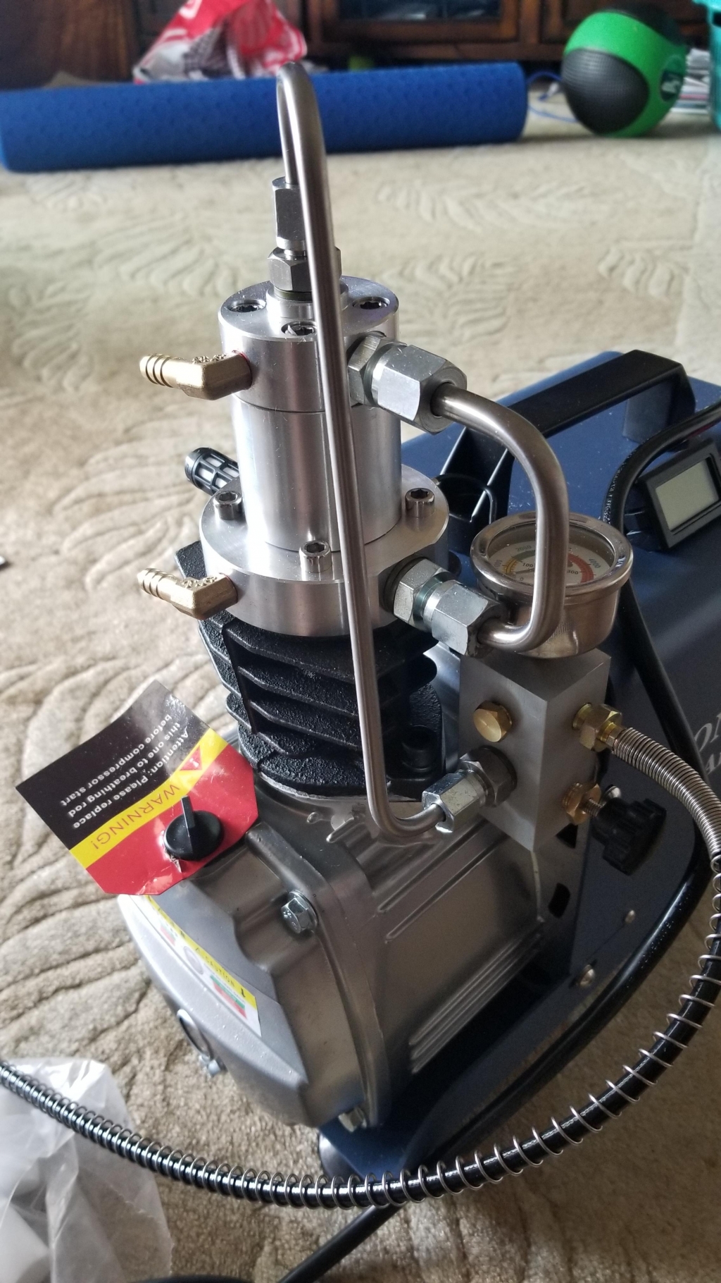

I hope mine is not the simple version. Pictures show the one with 2 relief valves but not much in the description. 295 shipped was the cheapest one i could find already in the states. Would my little 2x4 inch cotton filter suffice if it is the simple version?
