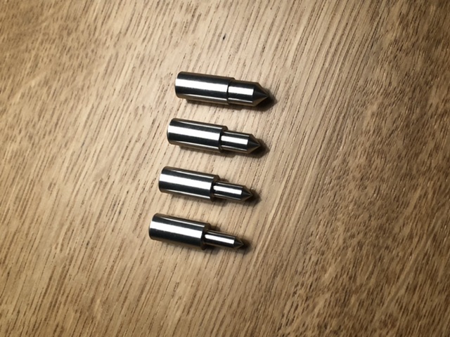

Plugs can be built with a step up in size, so that if you are shooting a .25, the plug fits nicely in a .25 hole, nice and snug without enlarging the hole, or in the same sense, being sloppy in the hole. But when looking from the top of the plug, the "collar" or "step" is .357 so the rings that are hit by .357 are scored even though you were using a .25. Another plug would be used that stepped .30 caliber up to .357, and If I read mike right .22 caliber up to .357 if you're shooting pellets. Of utmost importance is that the front of the target be marked so the scorer can easily be aware of which caliber was being shot as he will be juggling plugs while scoring.
Yes...that is correct. The plug shank is tailored in size to the specific caliber being scored so it does not enlarge the hole. The top of the plug is the scoring edge and in our case will be .350” in diameter. Think of it in a T shape where the vertical part of the letter is the properly fitted shank and the top of the T is the 350 scoring edge.
This is exactly the same thing that takes place in current 25m BR where there is .177 and .22 shooting on the same target. To make 177 fair, you have to use a .224” scoring edge plug.
it takes 2 different shank plugs to score targets fairly with 2 calibers. This is going to take 4 plugs. Without them, you have no way of scoring targets of different caliber correctly.

Both Pyramyd and RMAC use a 350” plug. EBR used to but recently switched to 30. This is not to align ourselves with anyone or anything. I don’t personally care about shooting 100y with pellets.
30 could be used for this....but the target will be harder for pellet shooters.
