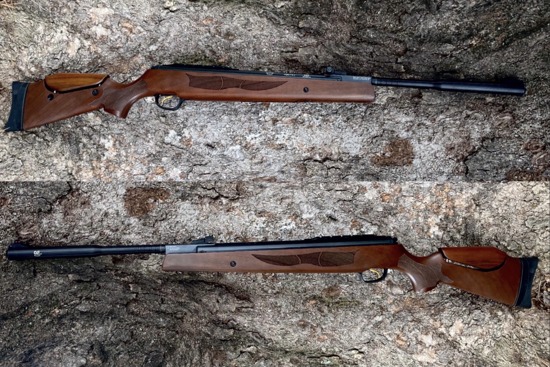

This is the 135QE Vortex in .25 caliber. Shoots 24 grain lead pellets around 800 fps. Smooth shooter especially in 22 and 25. I think these two calibers are the “sweet spot” for this monster. Well balanced rifle so the weight isn’t a hindrance. Very accurate. I have been through the entire gun and trigger. Trigger breaks at about 2 lbs. It could go lighter but this beast calls for a bit heavier trigger. They are a hoot to shoot. I would not recommend buying one without seeing it in person. Hatsan’s QC has gone to the dogs lately. If you come across an earlier one then you will be getting a better one.

This is the 135QE Vortex in .25 caliber. Shoots 24 grain lead pellets around 800 fps. Smooth shooter especially in 22 and 25. I think these two calibers are the “sweet spot” for this monster. Well balanced rifle so the weight isn’t a hindrance. Very accurate. I have been through the entire gun and trigger. Trigger breaks at about 2 lbs. It could go lighter but this beast calls for a bit heavier trigger. They are a hoot to shoot. I would not recommend buying one without seeing it in person. Hatsan’s QC has gone to the dogs lately. If you come across an earlier one then you will be getting a better one. View attachment 340717

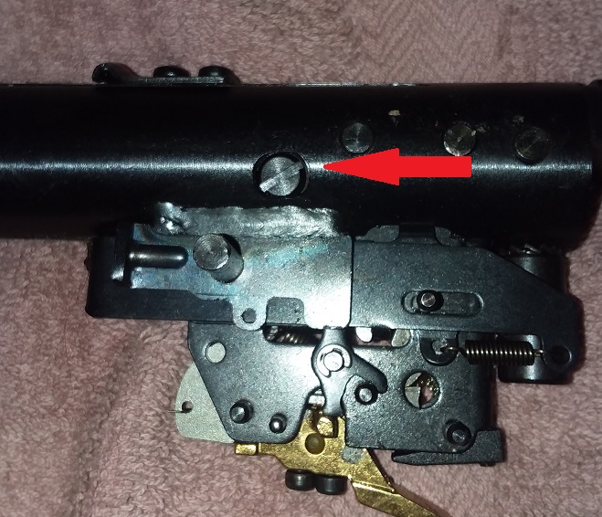

Hatsan's better gas rams used to have a pressure relief screw on them. Hole for it is stamped on the left side rear of the receiver and the red arrow points to that screw in my picture. The pic is of one of my Model 95 actions. No clue if the 135's have one or if Hatsan even still makes some of their Vortex rams with it.
My 135QE .25 does indeed the pressure release valve. Not sure if the new models do or do not. I experimented once and brought a 95 up to 150 bar. It was incredibly fast and to violent for the mass of the gun. Started eating up the 95 stock. I quickly released the piston down and brought it back to 125 bar. That is as far as I would take the 95. Easy to cock and very pleasant firing behavior. That’s the beauty of an adjustable piston. It is so easy to set at any preferred level. So if Hatsan has stopped with the release valve then this is no longer an option.
Unfortunately my gun doesn't have that screw.
