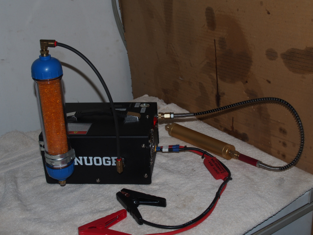

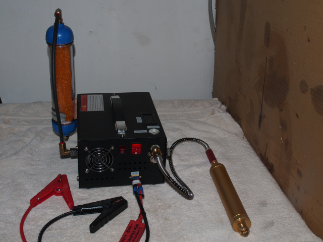

Mine isn't as elaborate but is a tuxing: https://www.amazon.com/dp/B0CT8MGGKC?ref=ppx_yo2ov_dt_b_fed_asin_title . Mine is a small Nuoge compressor (sold by many names, I'm told), and I added a pre-filter. Here is a picture of what I did. Mind you that I am only filling a 100 cc cartridge to 3000 psi!

Reactions: student
