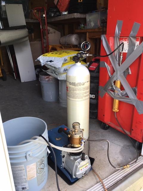

Yong Heng compressors or the likes
work fine for the money, I have been using mine for 2 plus years. You can buy them for under 300 delivered. Also get the gold filter for moister separation. I think the tank I bought (pictured) was 550.00 new.
